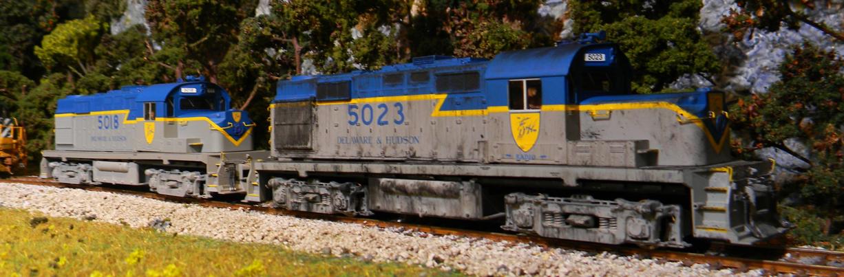

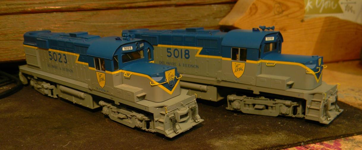

RE: Rainbows in the Lehigh Valley Gorge - TMo - 09-28-2026 Thanks, Hillyard. Can't take any credit for the RS36 cabs - those yellow lines were painted on by Atlas. The C628 was my work many years ago (bought an undecorated unit) with a decal set and the long ones were especially tricky. I'm half tempted to do them over. I did get the corner grabs installed on that unit and hit them with some SCL Hopper Car Yellow - looking a lot better now. I'll try to get some shots a bit later. RE: Rainbows in the Lehigh Valley Gorge - TMo - 09-30-2026 Made some progress on the D&H Alco fleet. My rear window glass in the C628 took some heat at some point and deformed. I had an extra set for the front which wasn't exactly the same size, but I got it close and applied some "sticker" number boards. Also installed the corner grabs (Cal Scale 190-516) on the loco and removed the "Delaware and Hudson" decals on the long hood since I want to redo them. Installed corner grabs on the RS36 units as well (Cal Scale 190-529) and did a little retouching of the paint on them - I like the yellow even though it's not exactly prototypical. The grabs were generally the same color as the hood in the same area, but I did see a photo with yellow grabs on a restored unit, and like the look. Gotta move on to coupler release bars next, windshield wipers after that. Getting closer to the end of these detail additions and the prospect of weathering these. RE: Rainbows in the Lehigh Valley Gorge - TMo - 10-02-2026 The RS-36's are ready for weathering. The C628 still needs some windshield wipers, but it's almost ready. In summary: New grab irons all the way around both locos. New lift rings over the engine bays, new coupler release bars front and rear, new antennas, new M/U hoses, new yellow paint on the grabs. Definitely a better presentation than right out of the Atlas box. They will soon be a bit more distressed... RE: Rainbows in the Lehigh Valley Gorge - tompm - 10-03-2026 Very impressive. One day I would like to do this kind of detailing. RE: Rainbows in the Lehigh Valley Gorge - TMo - 10-03-2026 I will say, Tom, it's a challenge for the fingers and my patience. Tiny, tiny parts. Can't tell you how many times I was under the desk hunting by tactile feel... Well, the stage 1 weathering began tonight, and I began with 5023. Key things for me to hit with black were all of the intakes, the walkways, trucks, undercarriage... Prototypical for these units in 1976-77. I've seen some pictures where the locomotive is incredibly grimy - looks like it took a bath in coal dust. After the intakes I work a very soft dry brush in vertical strokes from top to bottom, making sure I hit seems, hinge plates, door handles. I'll do a similar treatment on 5018 and the C628 which now has it's windshield wipers. The shot below is the equivalent of a before stage 1 (5018), and an after (5023). Stage 2 is rust and grime washes - ain't for the faint of heart if you're into pristine locos fresh out of the paint booth... |
