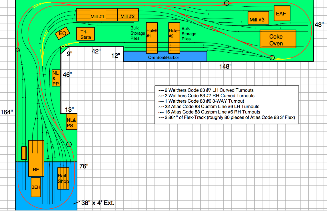

My buddy is going to start laying some track down on the layout i designed for him (Steel Mill Layout). He has the benchwork built and bought some rolled cork, glued it down and now is ready for trackwork. He has the plan printed out in 1:1 scale (done on a plotter).
He's asked me to post on the forums asking for help on how to correctly wire a layout. Hes doing DCC, and there are 2 reverse loops in the plan. We know where to isolate the points and were going to be using 2 of the Digitrax AR-1's (one for each loop). Basically he is wanting to know the correct way to wire the layout, isolate the gaps correctly. Questions like the length and gauge of the feeder wires and the gauge of the bus wire. How often (every 12" or so?) do you put feeders in?

I know you had a thread for this a while back but I can't seem to find it. Can you repost a quick picture of the track plan?
Re: Layout Wiring Tips and Tricks? - Trucklover - 11-14-2009
Hey guys,
here is a picture of the plan. I dont have alot of time right now, just got back from my girlfriends house. We celebrated her dads birthday, and well lets just say im pretty tired after that party LOL
And just to answer Andrews quick question about Flex or Sectional track. He will be using all Flex Track for the layout with Atlas and Walthers switches.
