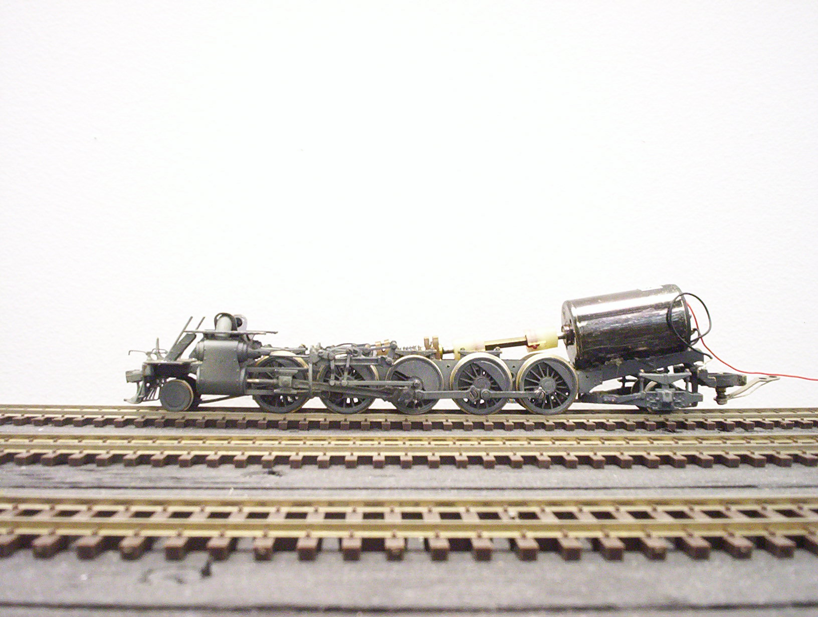

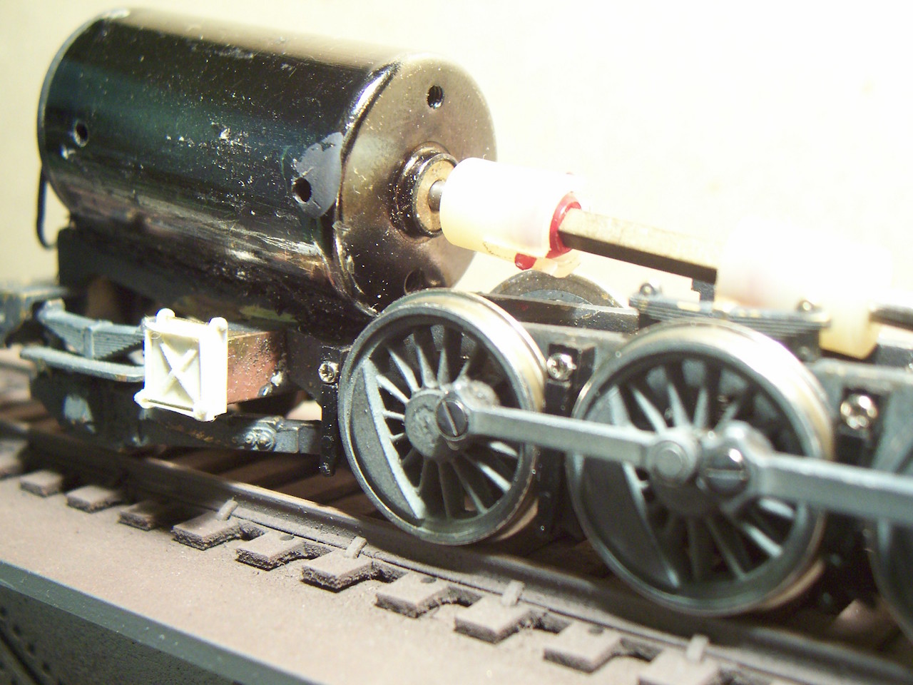

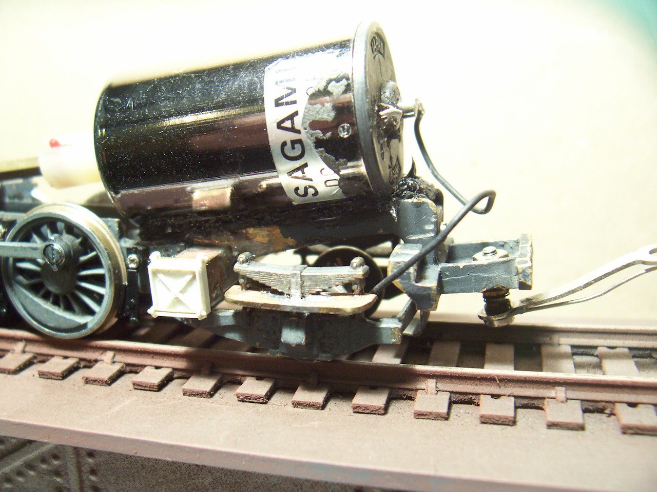

Here’s the running gear as found.  The trailing truck is missing part of the equaliser on this side, and the original pilot wheels are still in place.

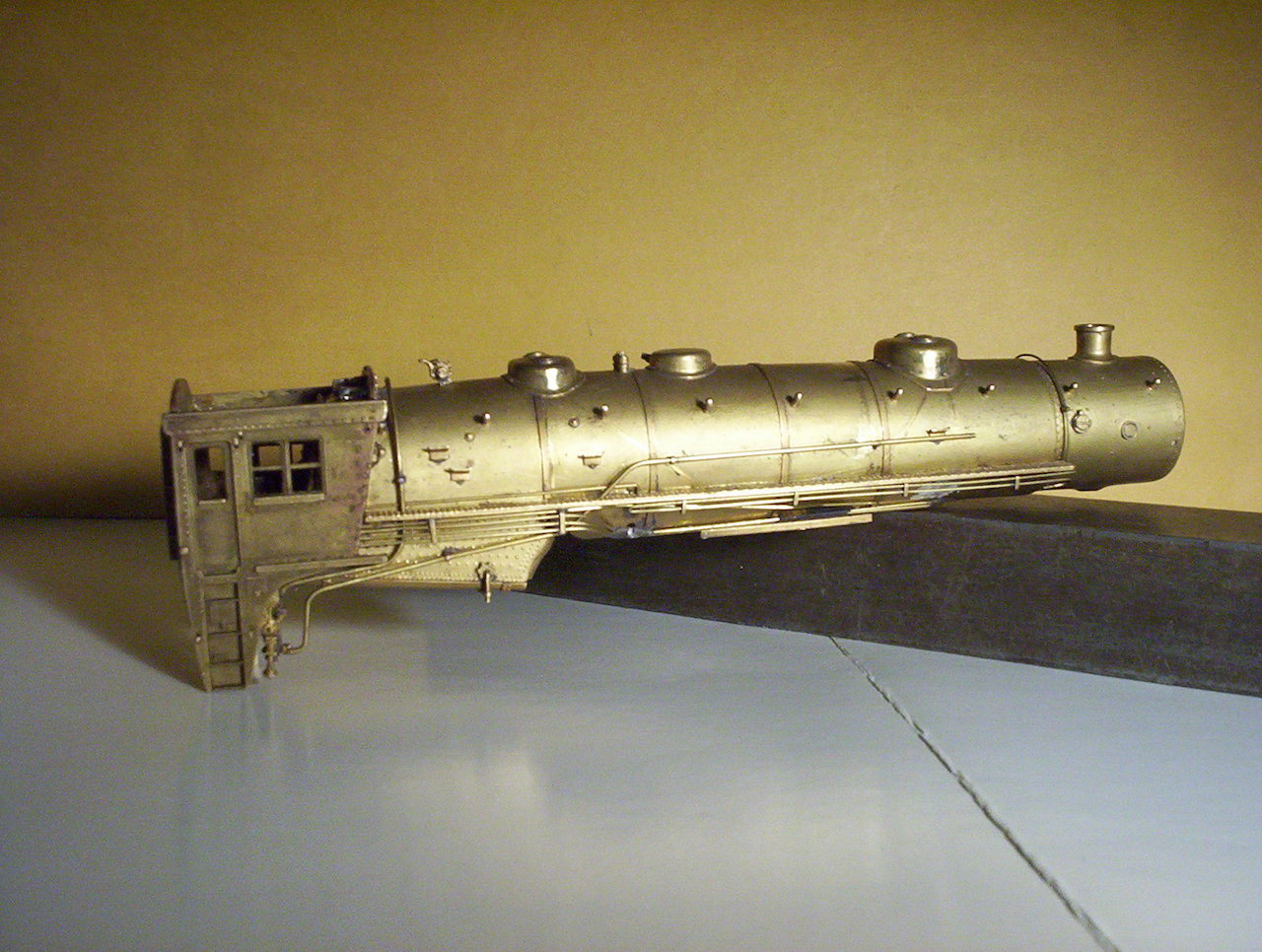

One of the distinctive details of this loco are the ash chutes under the firebox.  I used square brass tubing, soldered to the loco’s frame, for the main chutes, then fabricated the doors from styrene and wire.  Unfortunately, they are not as solid as they might have been had I used brass, but with  19 pieces per door, I felt that they were beyond my capabilities with a soldering iron.  I did fabricate the missing part for the trailing truck and soldered it in place.

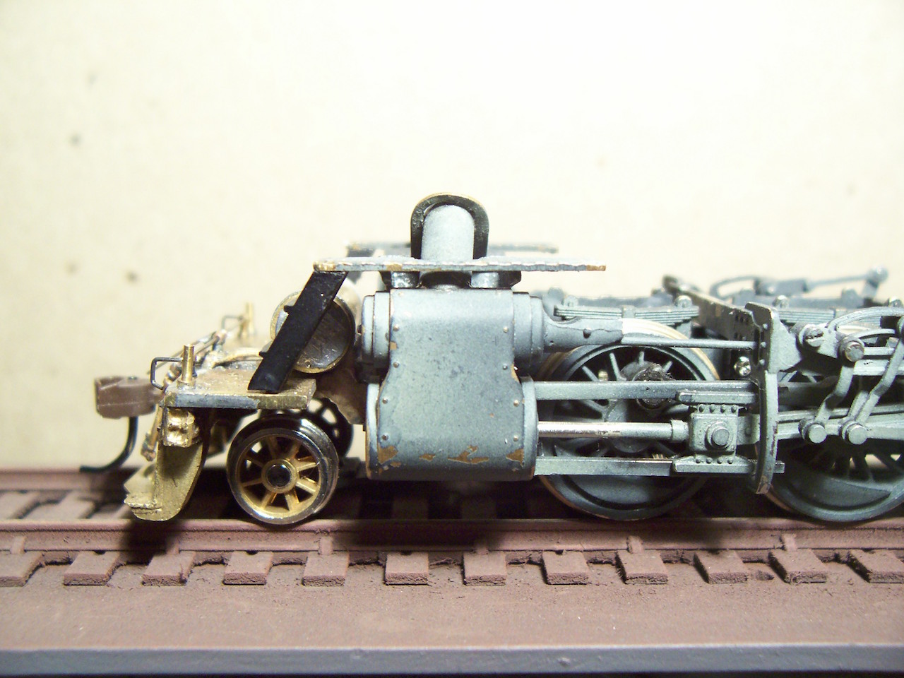

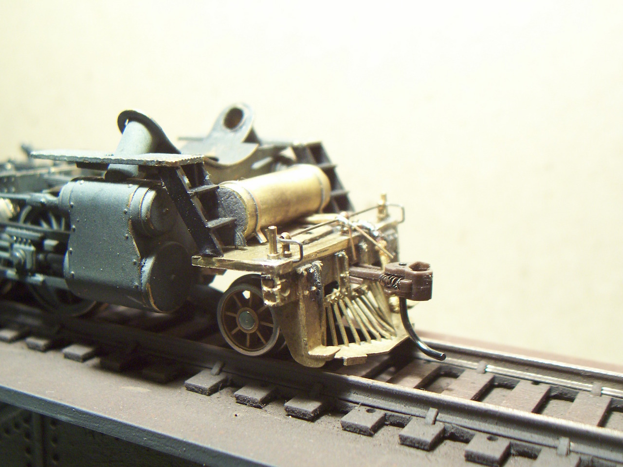

I fabricated a new pilot deck, altered the frame, then modified a brass CNR-style pilot to accommodate a Kadee coupler. (Mister Nutbar had bought a number of these from a brass importer some years ago - this is the last one that we have.)  Everything was soldered together using a 200 watt iron, then the coupler lift bar and stanchions, flag holders and a new air tank (built from lead-filled brass tubing, with .010”x.030” brass strip used for tank bands) were soldered to the assembly.

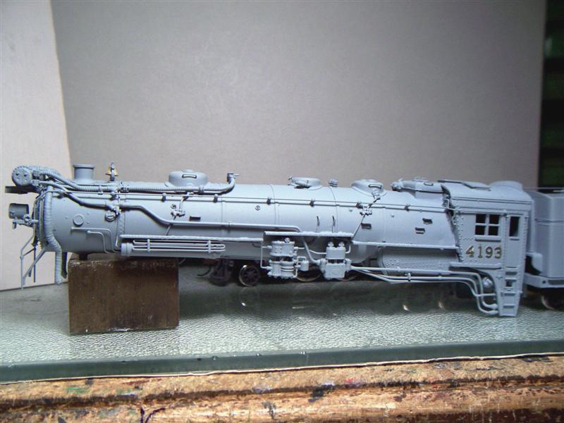

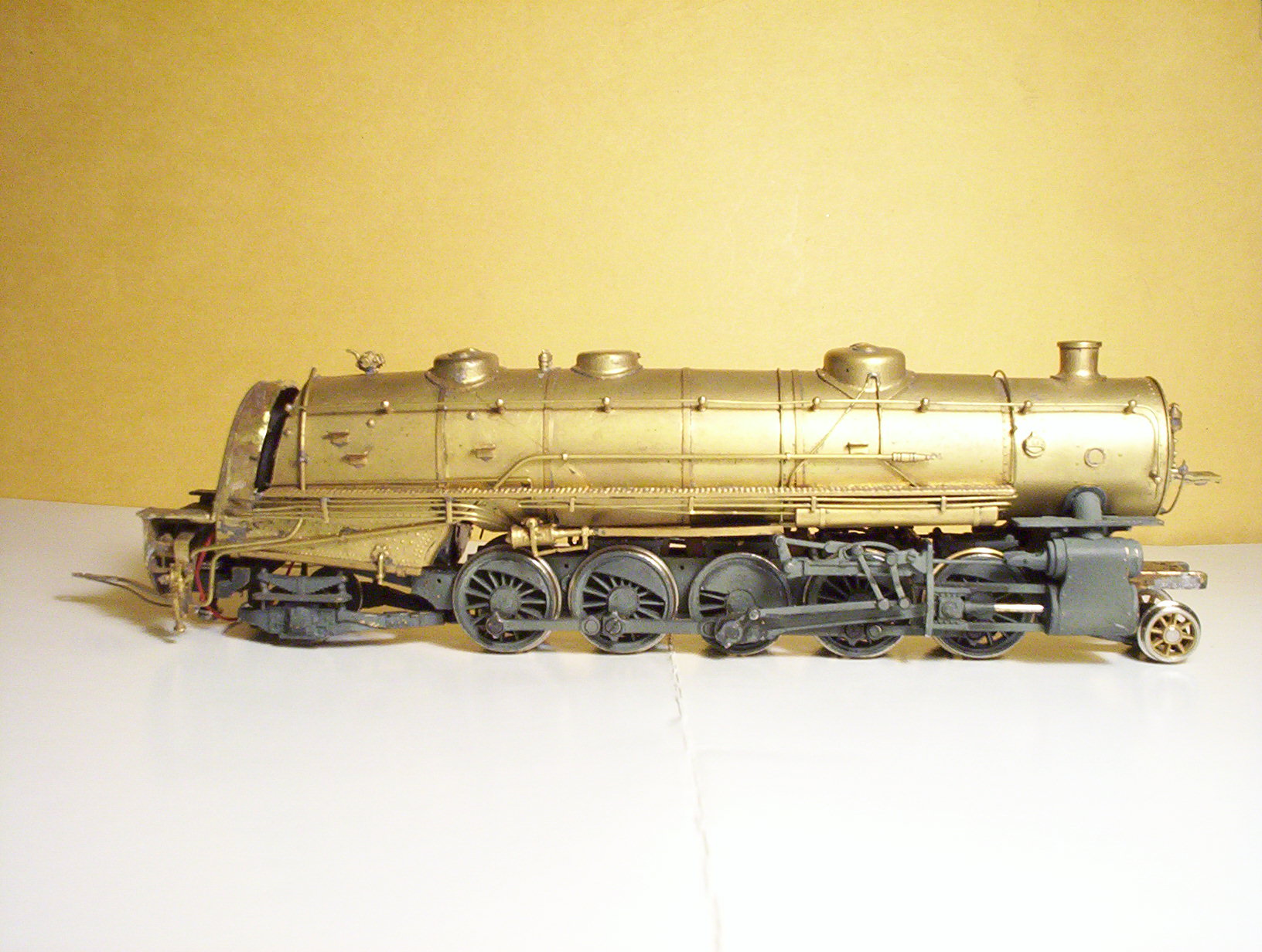

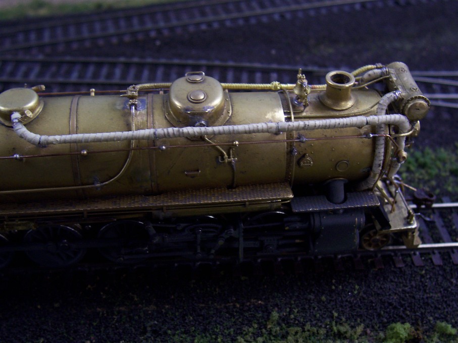

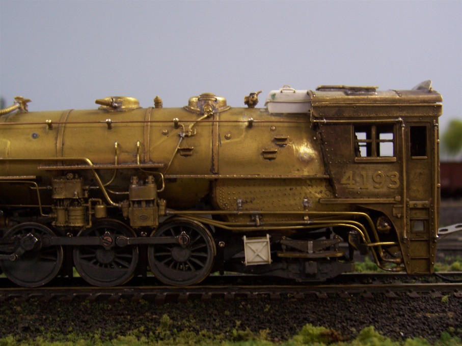

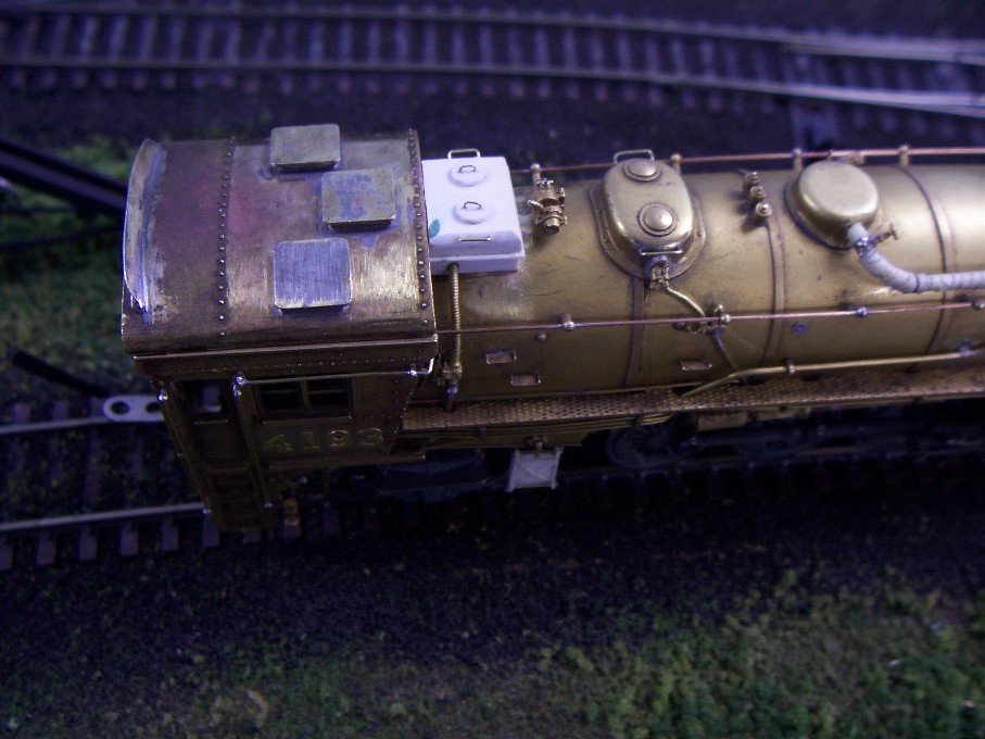

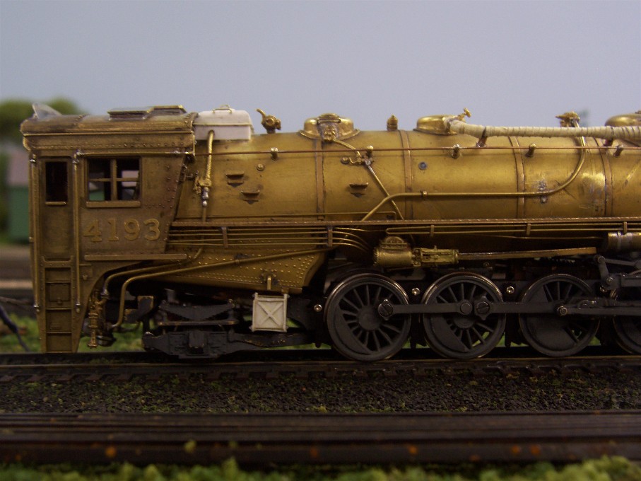

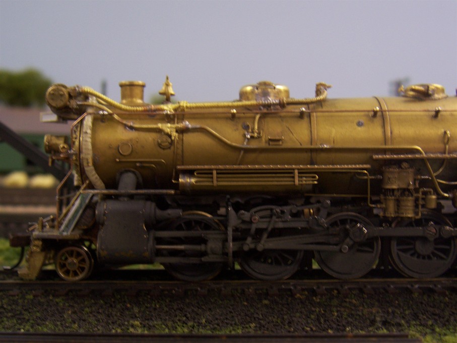

Here’s the engineer’s side of the re-detailed loco.  Parts added include the cab handrails, etched brass cab numbers, a new starter valve (in front of the cab), and a new power reverse.  The generator was moved forward to allow installation of the scratch built turret cover, and new sander valves and pipes were added to the sand boxes, along with grabirons.  The original water delivery pipe was re-routed to a new top feed check valve, and some boiler washout plugs were installed.  You can also see the new brake shoes and hangers added to all of the drivers, as the original brass ones had been removed by the previous owner.

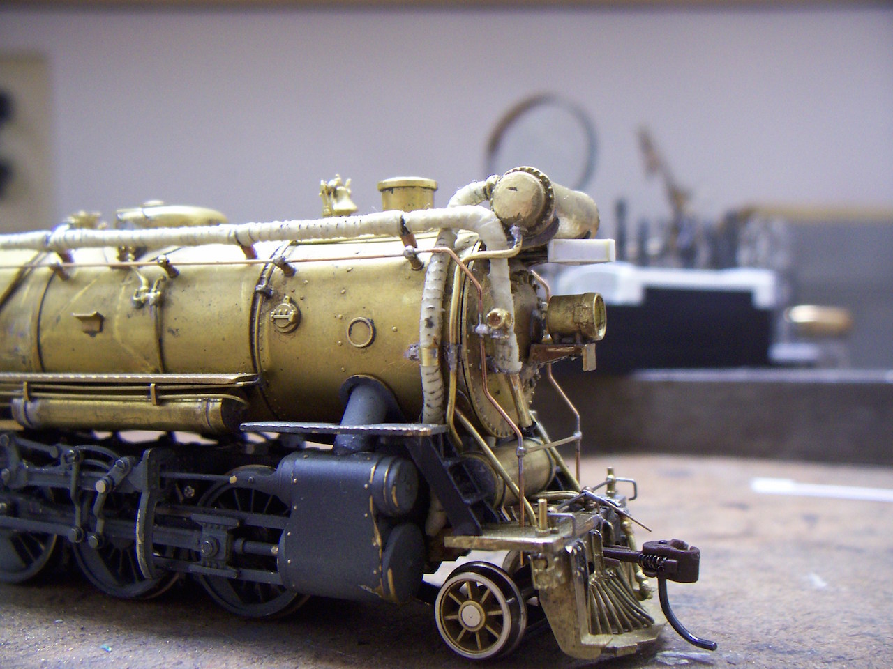

On the same side, but farther forward, you can see the top feed check valve, sander pipe and valves for the forward sandbox, and the lagged steam pipe from the dome forward to the smokebox front.  The new air tank is another fabricated from lead-filled brass tubing.
On the fireman’s side, the same cab and boiler details are seen, along with a new cold water pump (closest to the cab) and cross compound air pump, both with their associated piping.

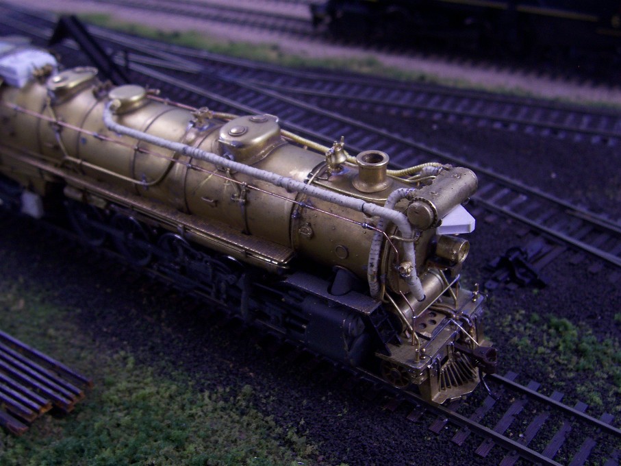

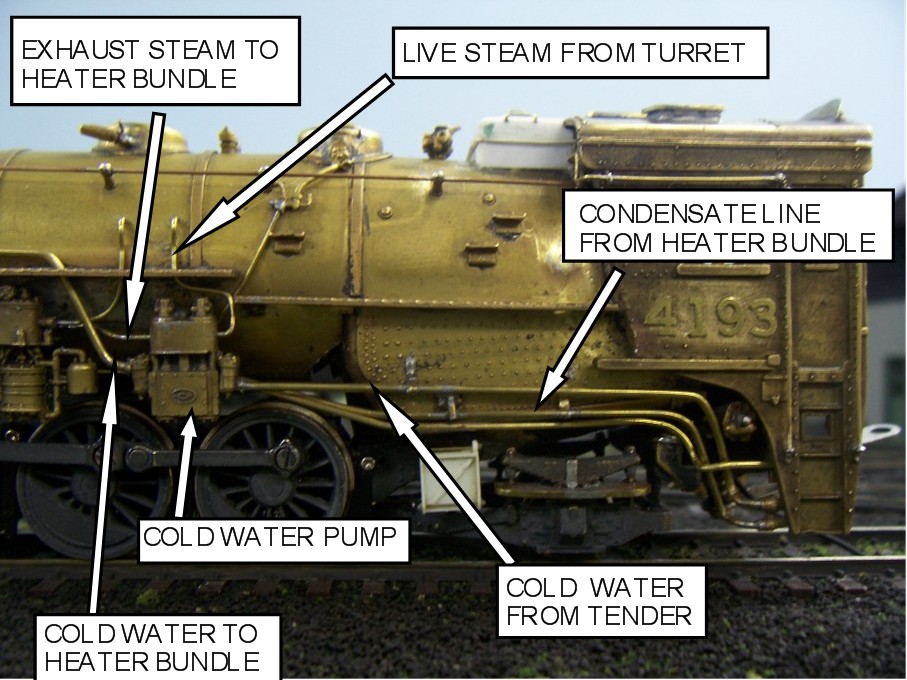

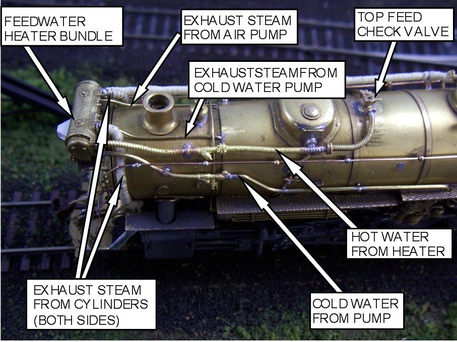

Here the continuation of the cold water line to the feed water heater can be seen, along with the lagged hot water line from the heater to the top feed check valve.  There’s yet another lead-filled air tank snuggled under the running board, and the new handrails can be seen as they work their way down the smoke box front.

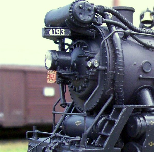

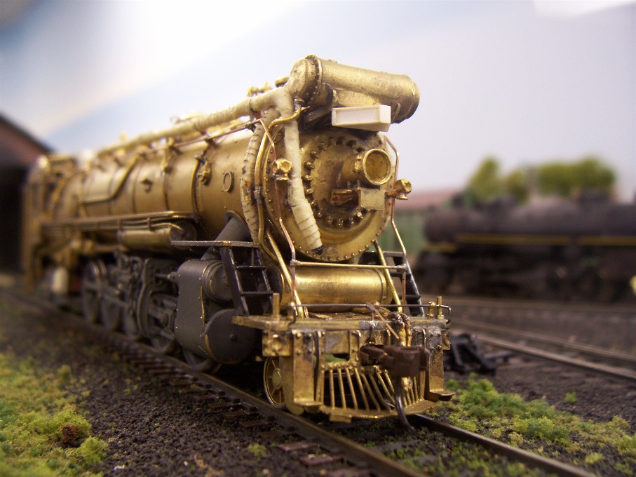

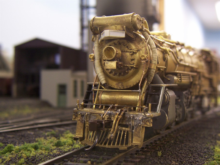

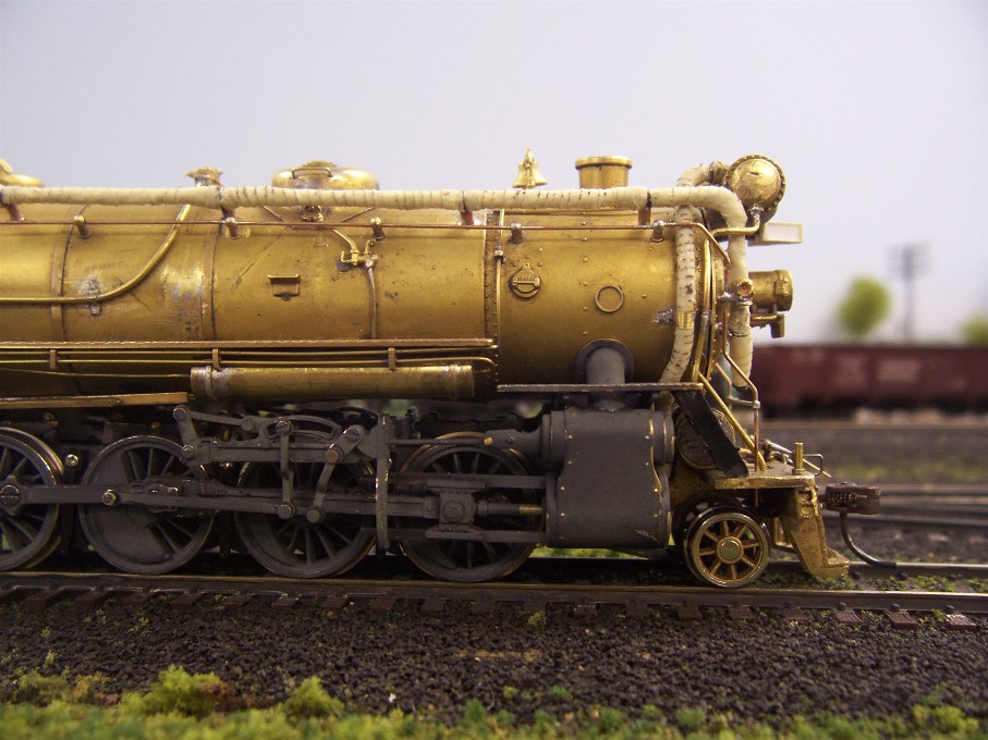

Here are a couple of front angle views.  In the first photo, the steam pipe for the Barber-Greene snowloader is lagged right to the end.  I later removed the lower lagging, as the bottom couple of feet of the pipe appear to be connected to the main pipe with a swivel joint.  Also seen here and in the previous side views of the front end are the exhaust steam pipes from the steam chest to the feed water heater, along with the condensate drain pipe on the front of engineer’s side of the smoke box.  The large heater bundle (from Cary) is supported on a Cal-Scale bracket which was customised with curved overlays cut from brass shim stock.  Beneath that is a CNR-style number board built up from styrene - it’s attached to the smoke box front with brass rods soldered into the smoke box.  The headlight bracket and headlight are from Cal-Scale and the combination class lights and handrail stanchions are also modified Cal-Scale parts.  The plastic steps from the pilot deck to the running boards are from the scrapbox, and are pinned in place with brass rods.

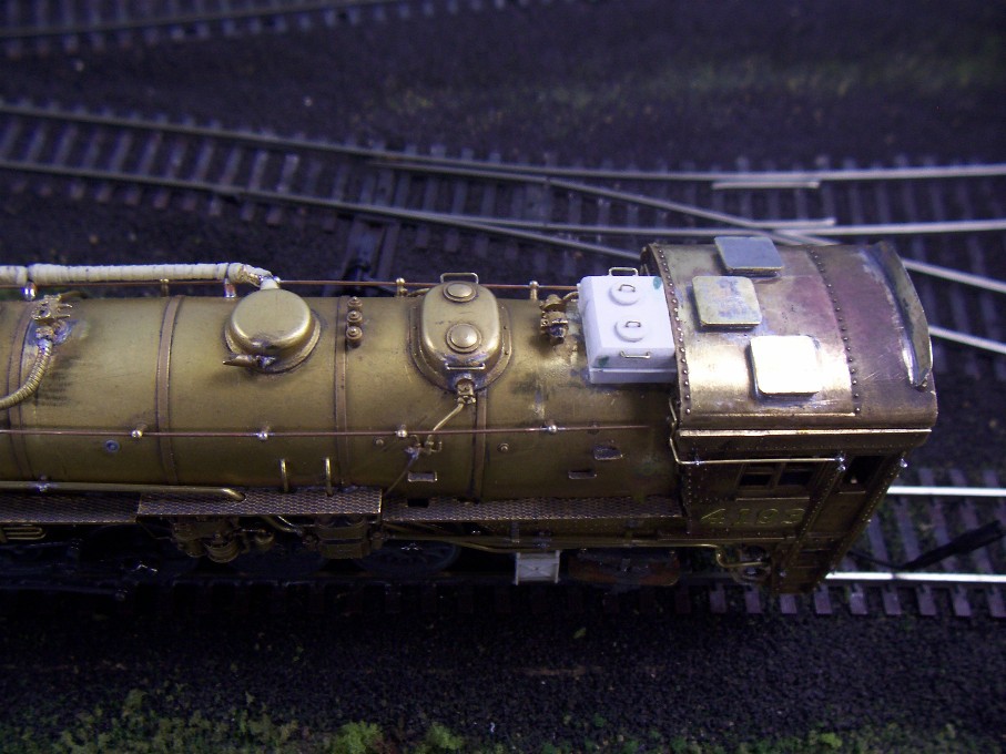

The vents on the cab roof were in the wrong place, so I used a mill file to remove them, then added new ones built-up from sheet brass.   Brass sheet was also used to increase the height of the wind deflector that was cast on the back edge of the roof.  The roof itself was made to be removable, as it’s difficult to install window “glass” in closed-in vestibule cabs.  The turret cover was built from sheet styrene, and is secured to the boiler by brass rods soldered into holes in the boiler top.  The hollow turret cover was then filled with epoxy, solidly bonding it to the boiler.  The round access covers were punched from styrene, and handles and grabs were made from .012” brass wire, similar to those on the sandboxes.

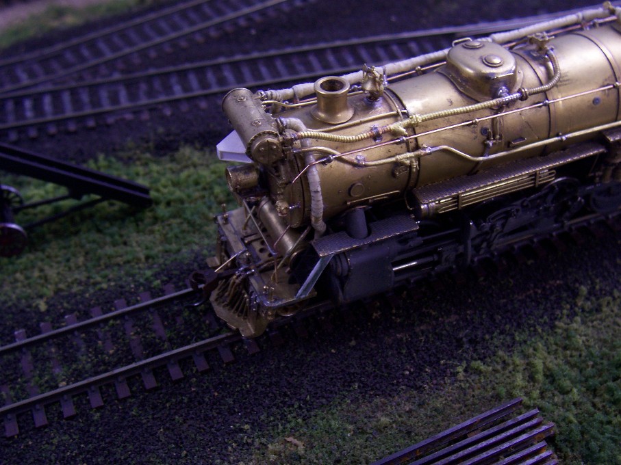

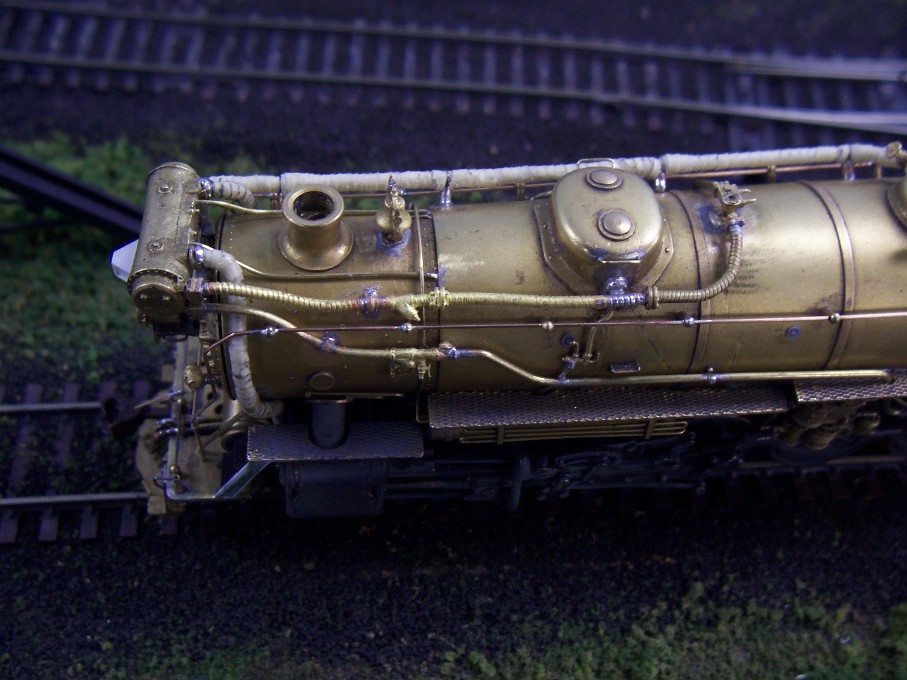

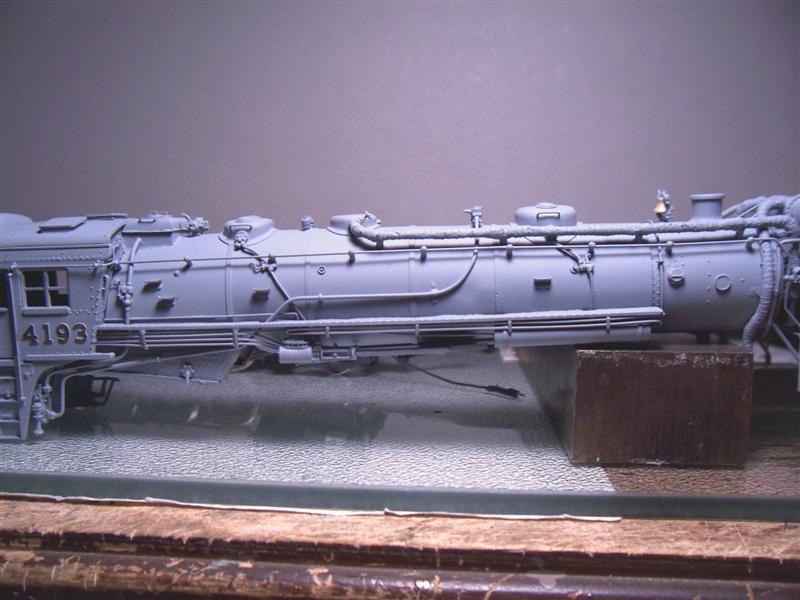

The three views below show the piping and details along the upper part of the forward portion of the boiler and smoke box.  The airline for the bell ringer, along with the steam exhaust lines from the air-and water pumps come out from under the boiler lagging.  The latter two go to the heater bundle.

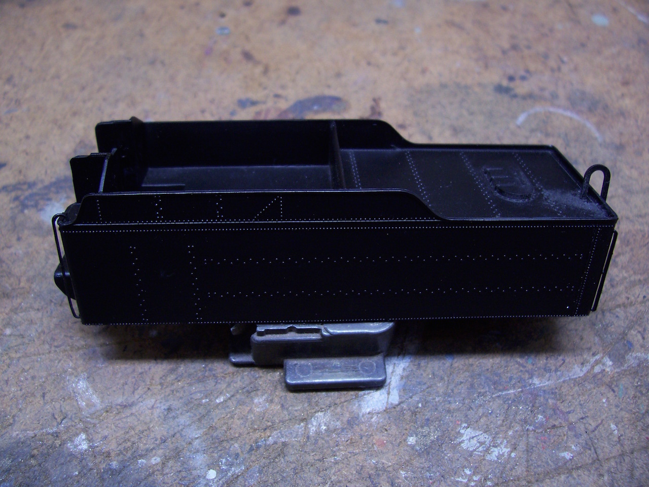

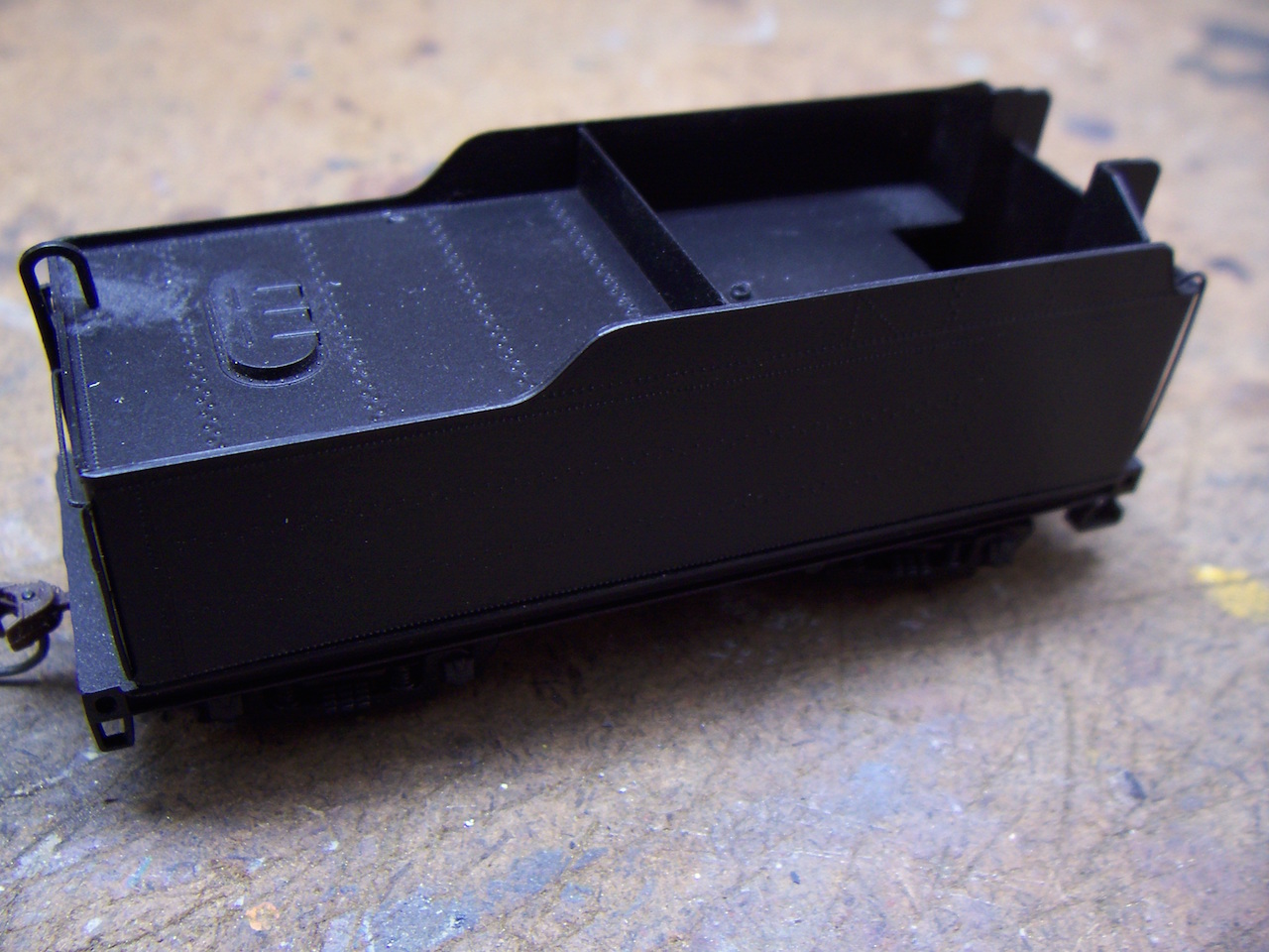

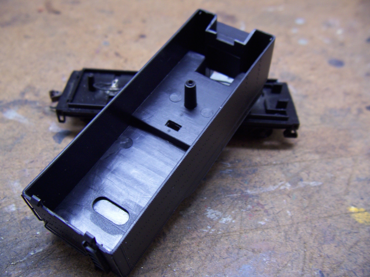

Here's the original Bachmann tender...
...and with some modifications...

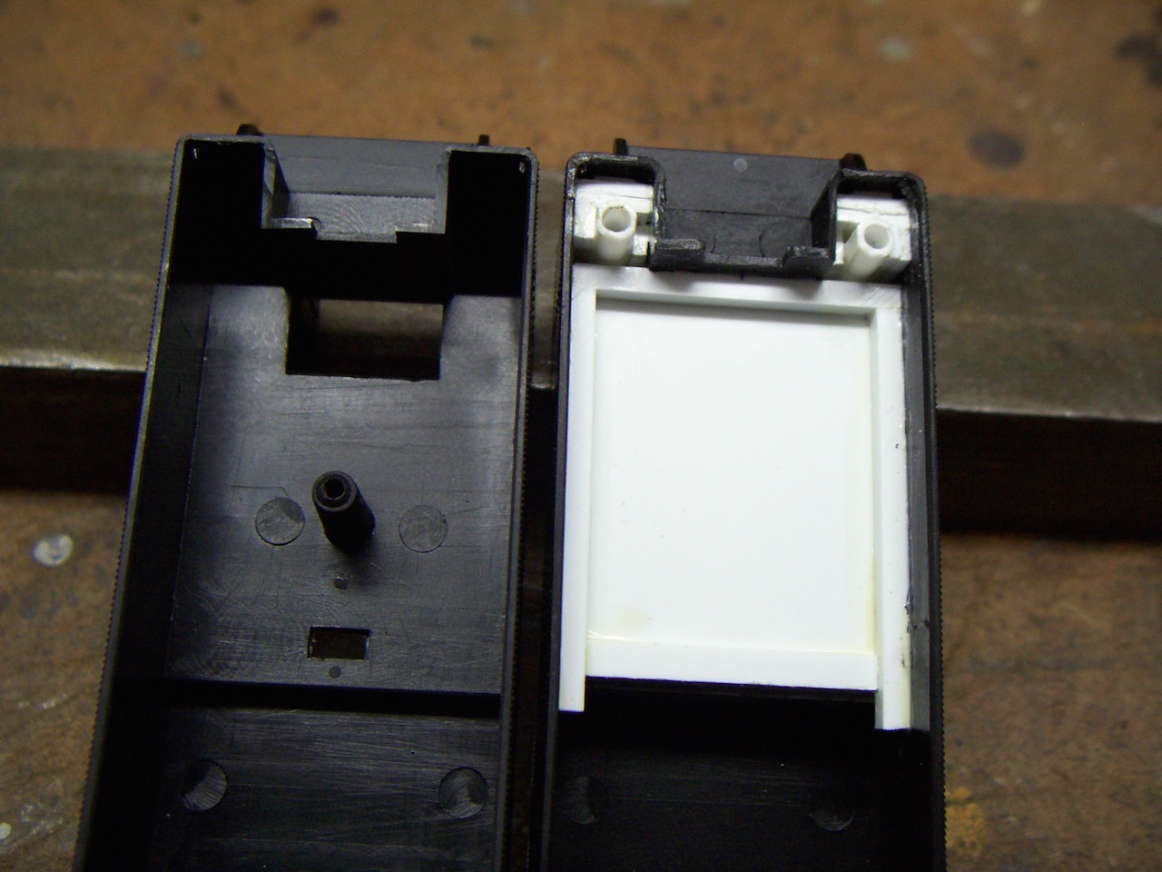

Because of the modifications made, I had to remove the original single-screw set-up for attaching the tender to its frame and running gear, so I added some styrene tubing in the water legs of the tender's cistern.  Screws through the floor of the tender and into that tubing will keep the whole shebang together...

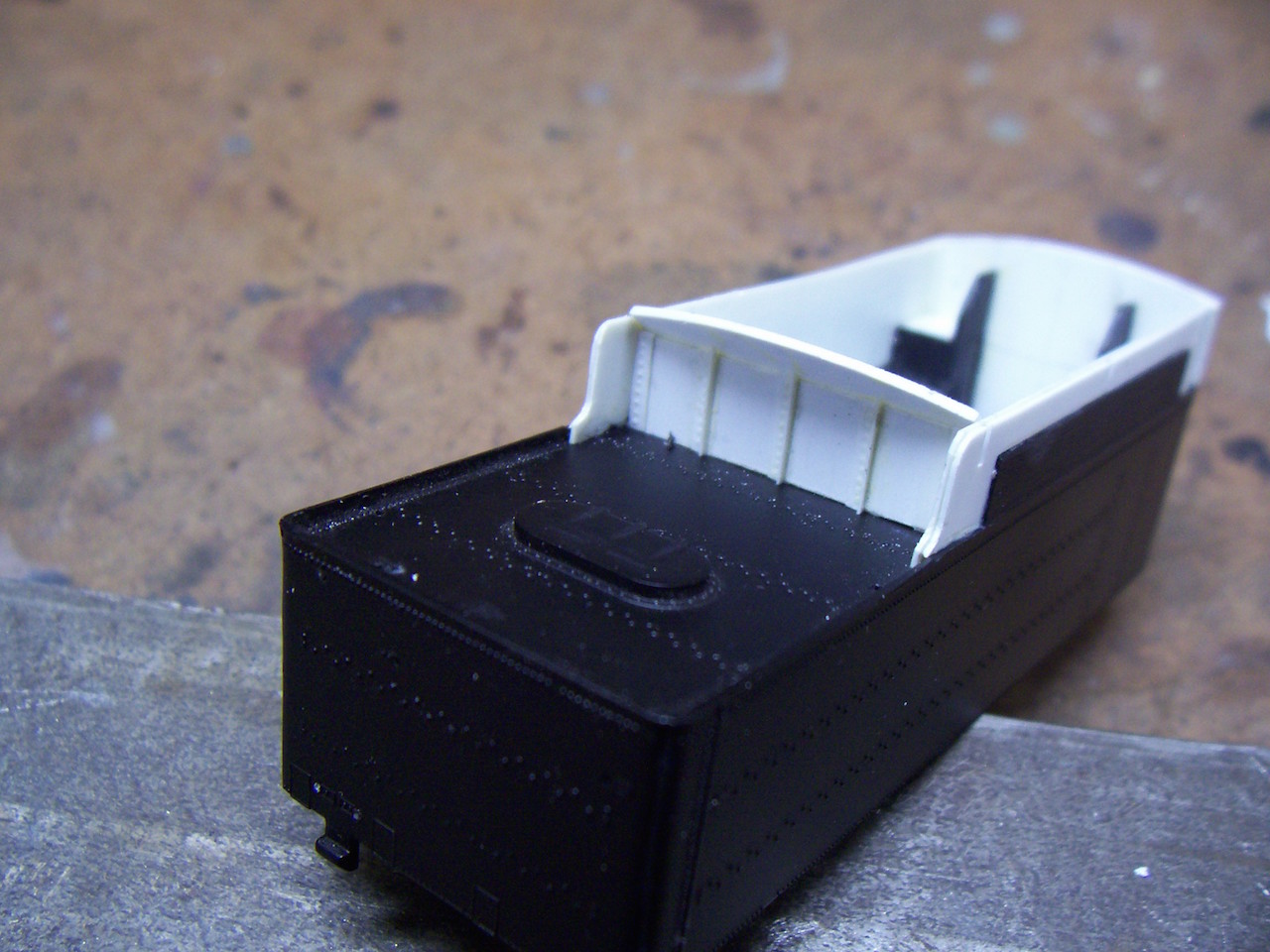

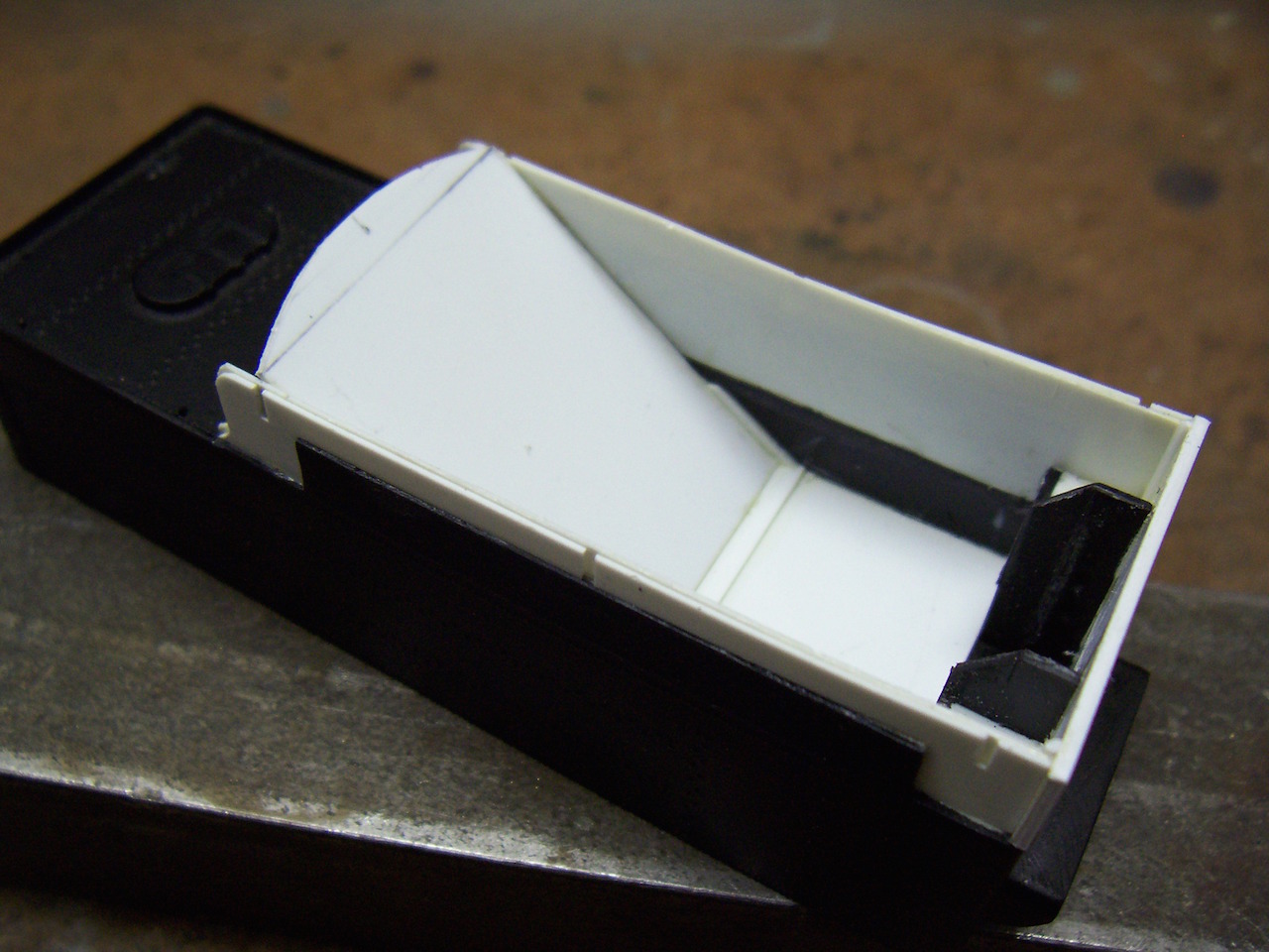

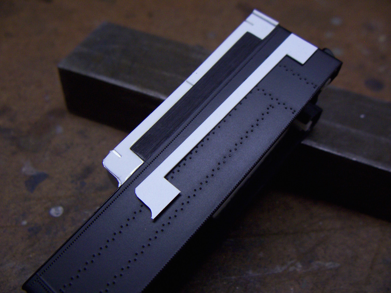

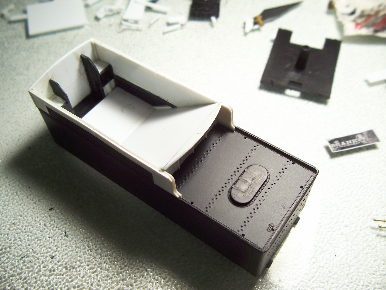

Here are the overlays which will change the appearance of the tender's coal bunker....
...once cemented in place over the one already installed, it will change the slots cut into the installed-one into pockets, in which I'll insert stanchions for the railings which will be fitted to the top edges of the coal bunker.

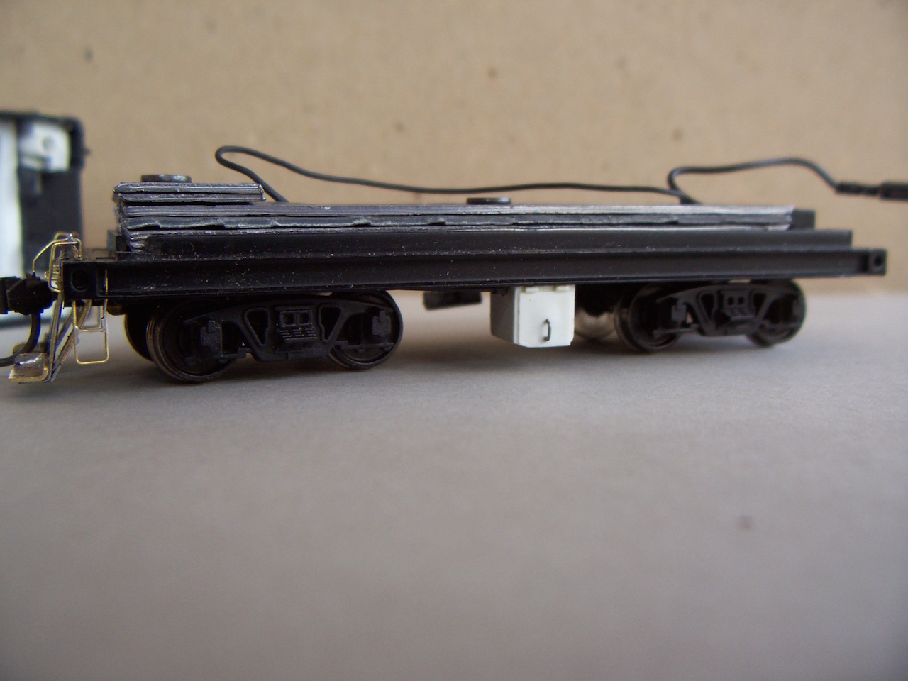

This is the Bachmann underframe for the tender.  The circuit board has been removed (I simplified the original wiring for DC operation) and removed the stock steel weight, replacing it with sheets of lead.  The small toolbox has been added, along with a re-railing frog on the other side...

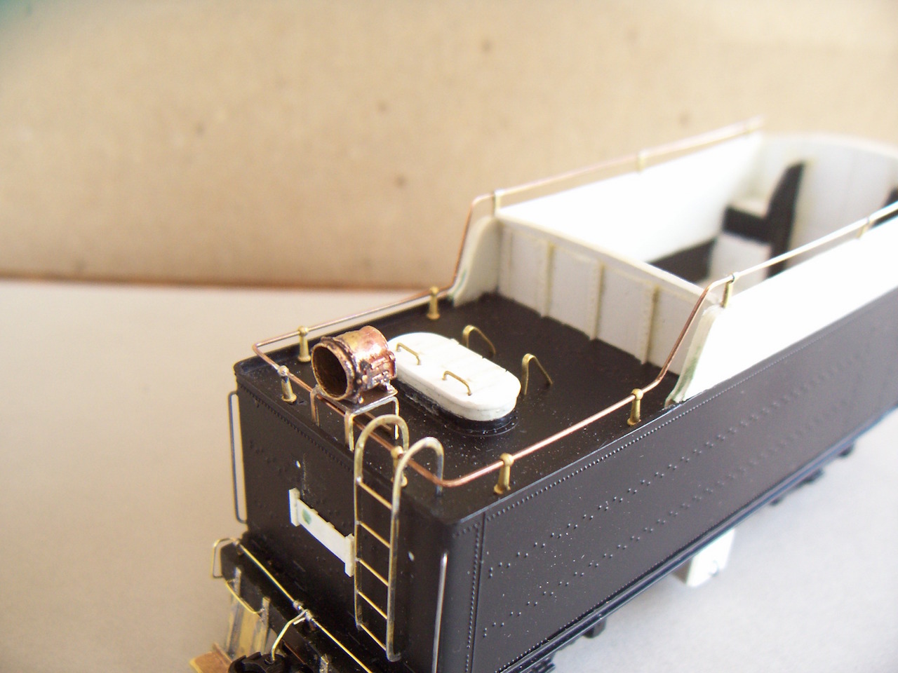

Here's the re-detailed tender....
The ladder was built (on a jig) using .010"x.030" brass strip for the stiles, and .012" phosphor-bronze wire for the rungs.  The same strip material and wire was used for the bunker handrails and stanchions, the latter inserted into those pockets mentioned previously, and likewise for the uncoupling levers and mounting stanchions.
The rests for the cistern water hatch are more brass strip material, while the cistern handrail is supported by brass stanchions from Precision Scale.
I used a piece of brass ladder stock, bent to suit, as a support for the back-up light.

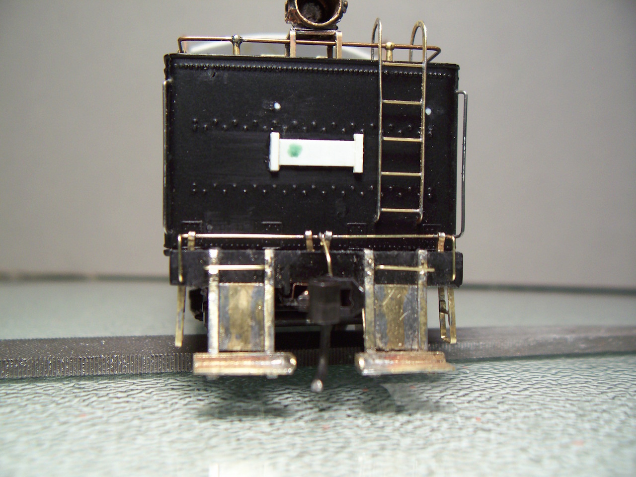

...and a view of the rear of the tender, better showing the footboards, sill steps at the rear of the sides, and the number board on the rear of the cistern...

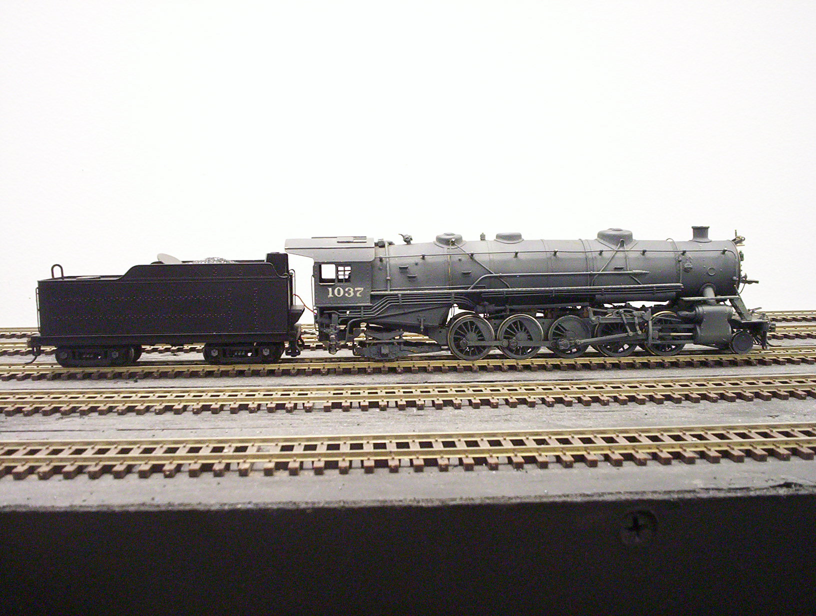

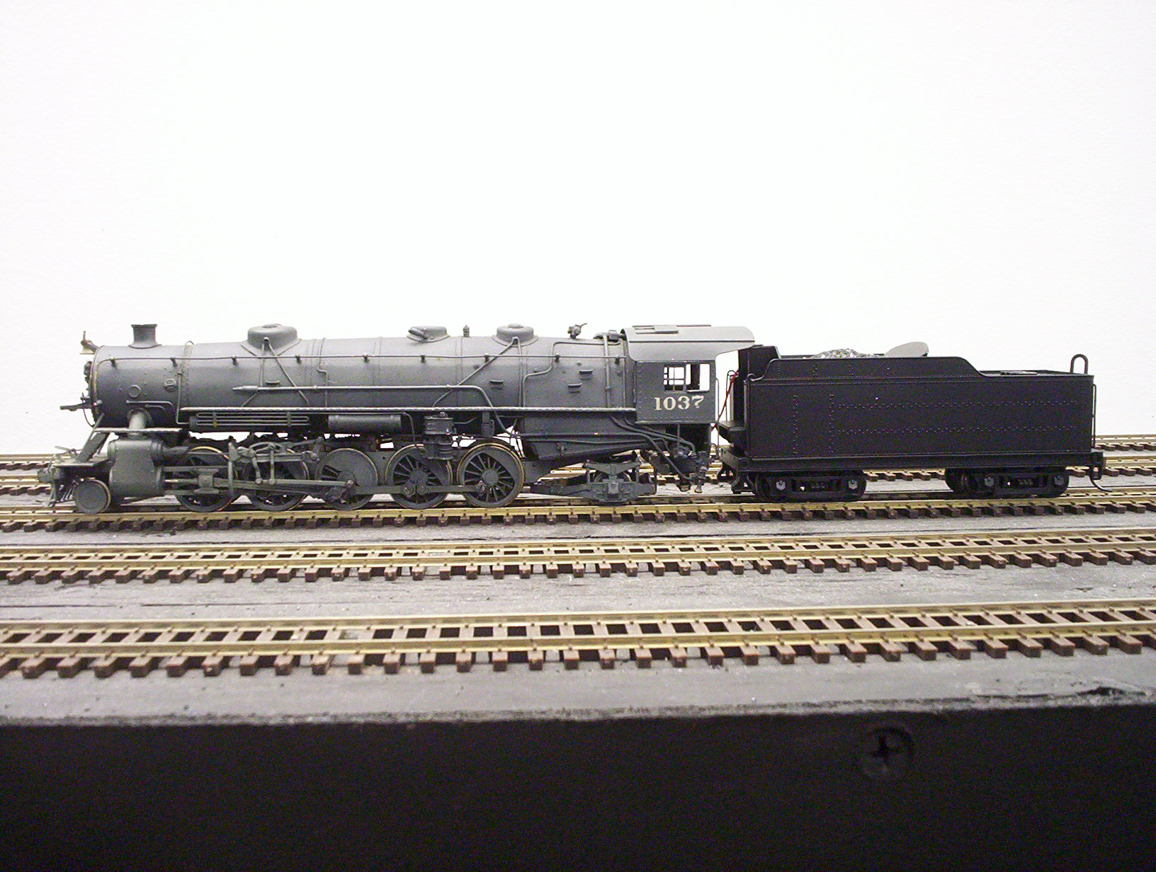

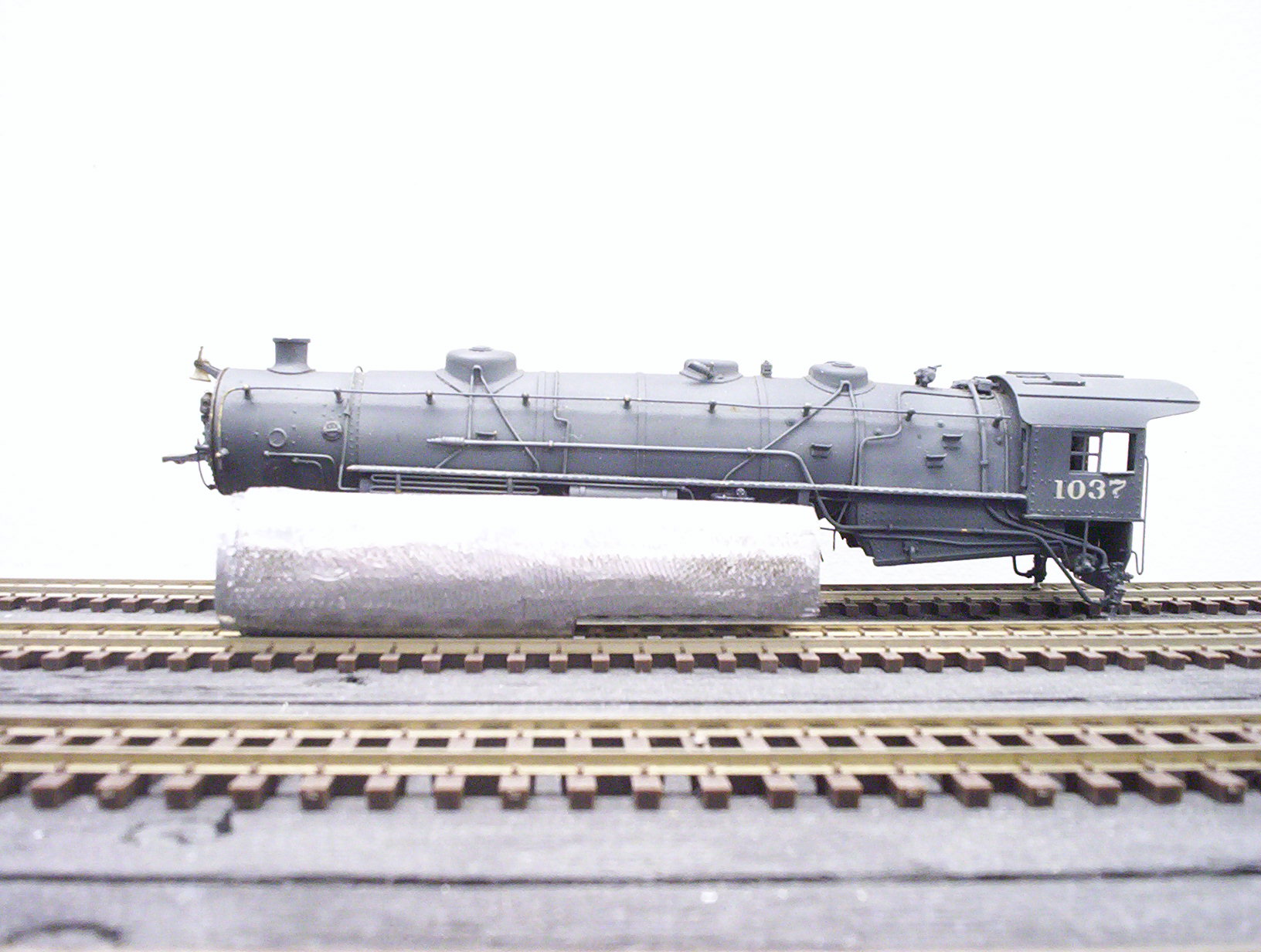

Here's the loco's superstructure in primer...
...and fresh from the paint shop...

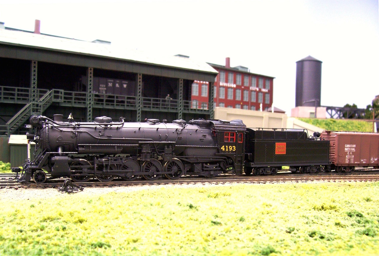

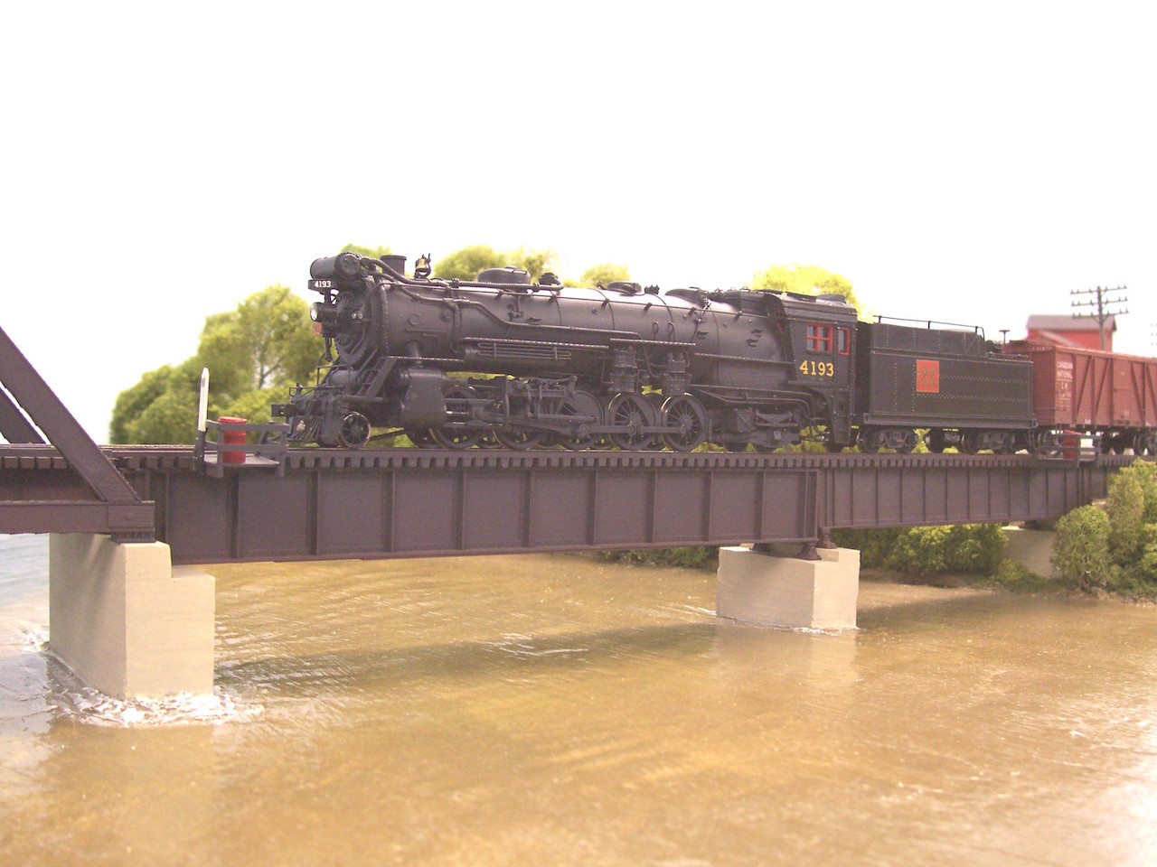

After a light weathering (representing a locomotive just back into service from the shops), the 4193 did a couple of shakedown runs on EG&E's lines, before making the trip back to CNR's Lee Town sub...
That concludes the story of Beeg Boy's re-building.

I've also added a couple which show the various parts of the Elesco feedwater heater system with labels, and a close-up view of the front end of the locomotive.
