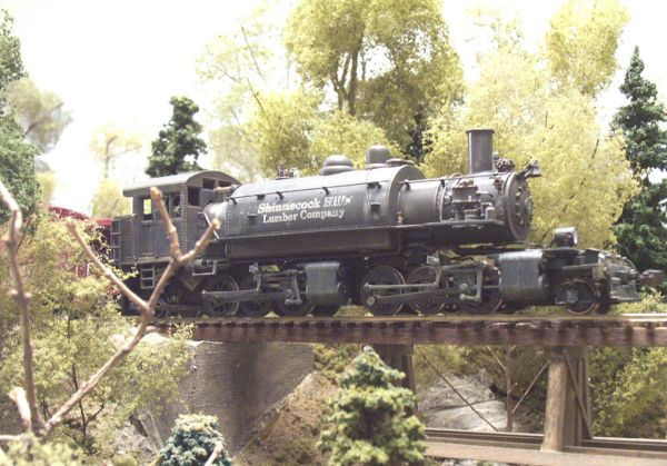

In these attached photos, the Mantua, as a 2-6-6-2T(std gauge), and the SVRY 2-6-6-2 (3' gauge): Both pictures are taken at the same location, on the dual gauge trestle, on my module.
The Mantua has a MDC cab, and the tank is also MDC. the trestle helps to establish a size relationship between the two. The mantua does make a nice standard gauge logging loco.

looking at your photos above, the mantua boiler does not that much bigger or longer than the SV locomotive. The prototypes had to be some huge narrow gauge engines. The photos I have seen show them dwarfing the cars they were pulling.
