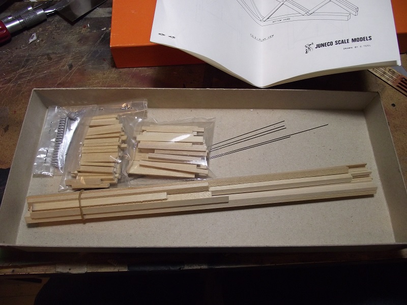

I've never built a wooden bridge kit before. I have a Howe truss bridge further down on the branchline but I had given the kit to my Father many years ago to build as me skills weren't up to the task at the time.
Opening it, it's more like a scratchbuild with the parts supplied. Some of the lumber is cut to size, some isn't. it includes some metal castings for the hardware and water barrels as well as wire for the tension rods.

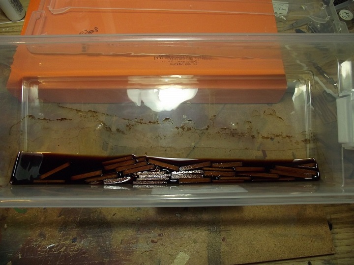

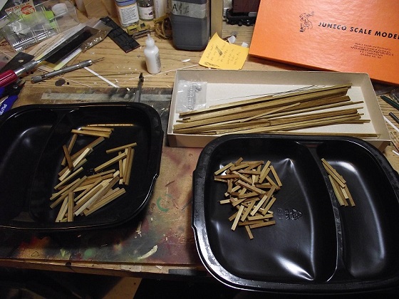

I used some Micro-Mark Weather-it-easy brown stain. I just dumped it into a storage container and let the parts soak for about 30 minutes before fishing them out to dry. Three batches were needed for all the parts.
I liked how they came out in the end. The parts are sorted out using a couple TV dinner plates.

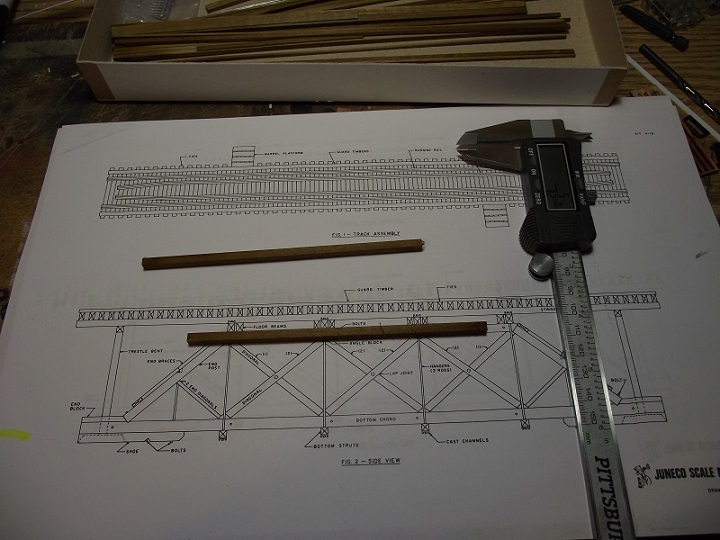

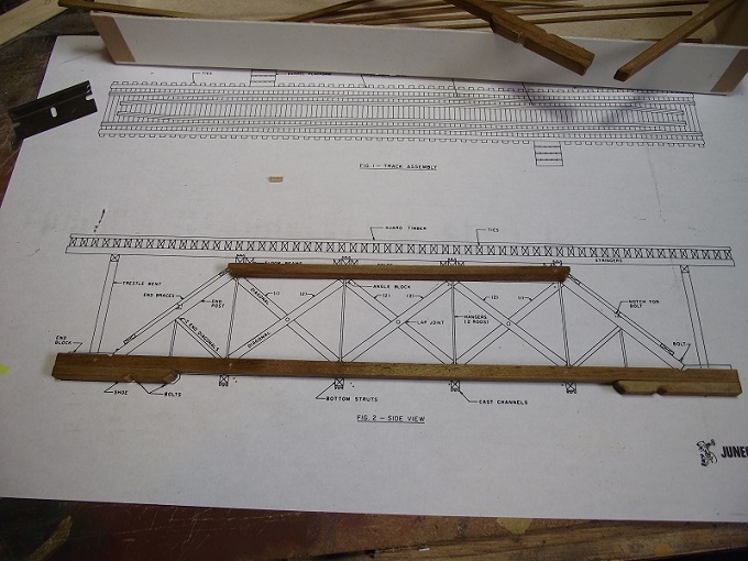

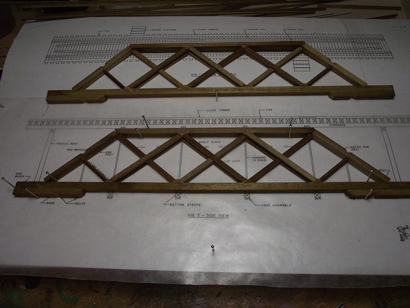

The first steps involve a lot of cutting, notching and drilling of the truss's top and bottom chord pieces. I made a slight problem for myself when I stained all the wood, removing the color-coding that was put on the ends to determine sizes. Because of that, the calipers came out.

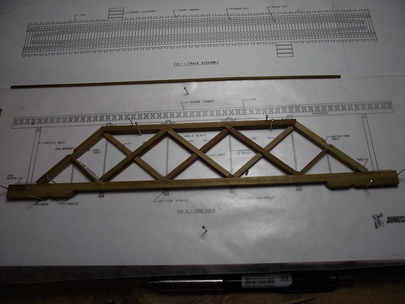

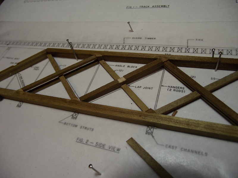

I pinned the templates to a piece of insulation foam with a sheet of wax paper on top. I then started to assemble the trusses by pinning and gluing the parts together onto the template.
After a couple hours work I had one complete truss, and one half built.

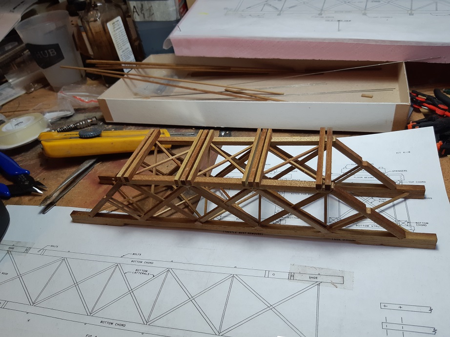

I spent some time in the workshop this evening and finished the second truss assembly:

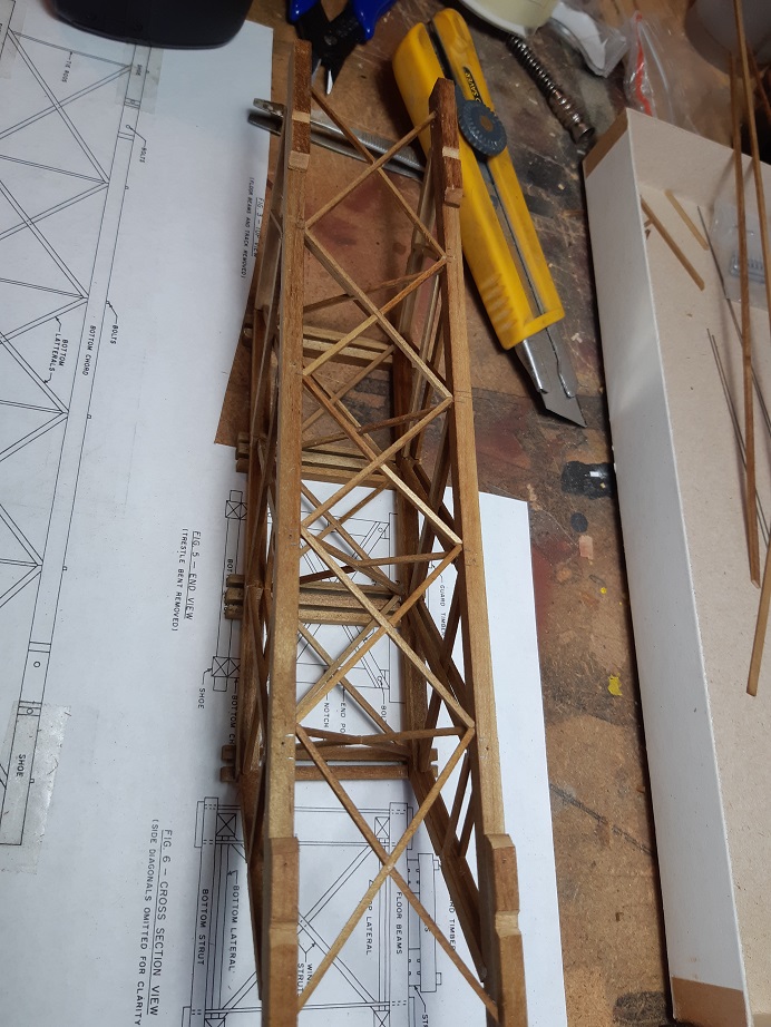

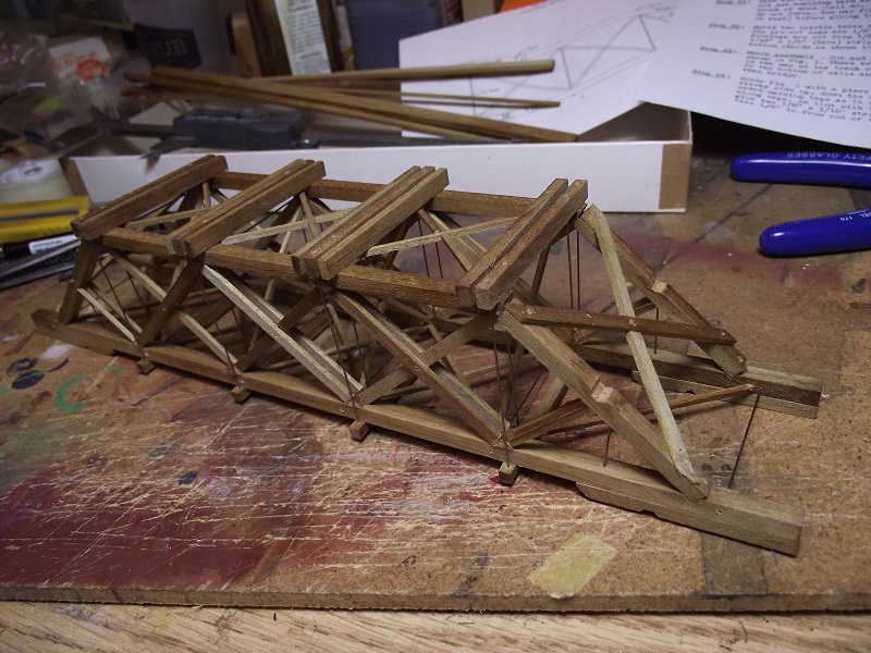

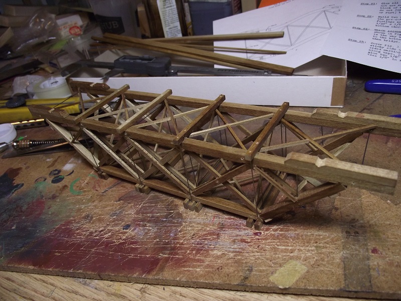

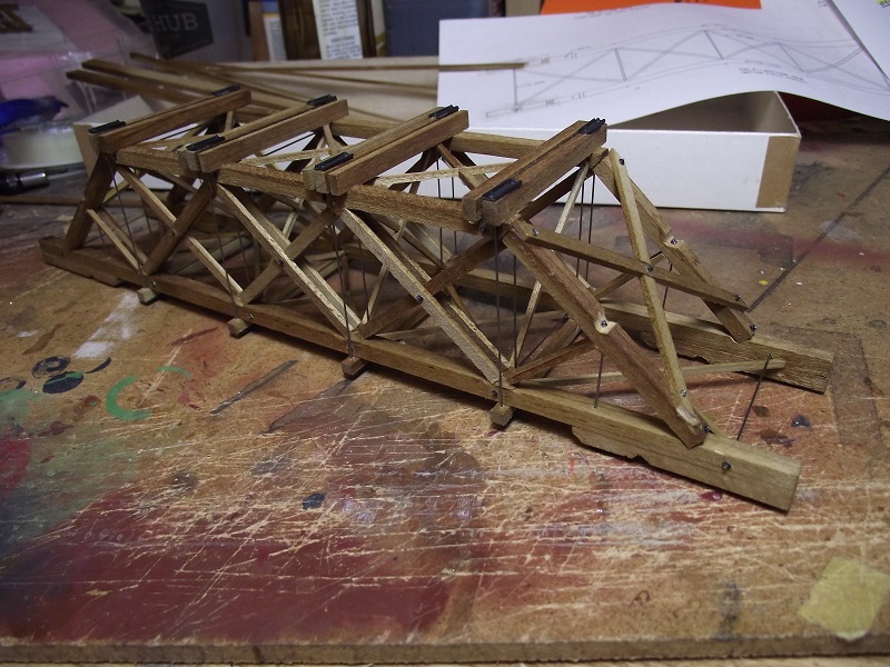

I managed to get quite a bit done over the past week. I've been trying to complete instruction 1 step each evening.

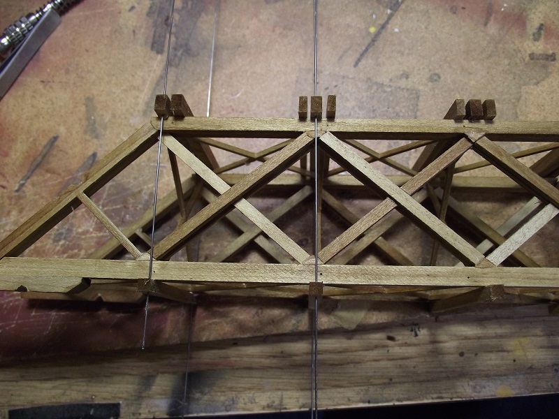

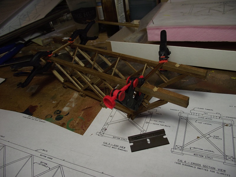

To join the two truss assemblies, I first had to clamp them the correct distance apart, then glue in the  bottom cross laterals. Then I added the wind struts (the cross bracing inside the structure), and then the top laterals. It's kind of like building a spider web out of 1/16 basswood.
I also attached the floor beams at this time.
I then glued the bottom struts. Both the floor beams and bottom struts are drilled for the hanger rods to run through. Since the floor beam were already in place, I used those to locate the struts by running the piano wire through both prior to gluing.
The last thing I did tonight was to installing the hanger rods and the tie rods. Now it's starting to look like something!

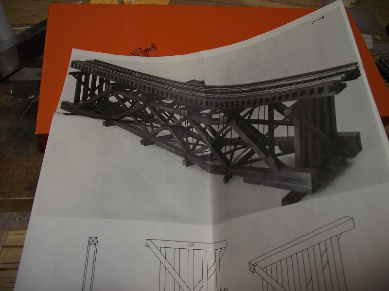

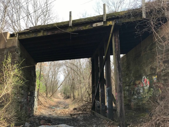

However I have run into a problem. I can't seem to find any photos or plans of what the bridge abutments for this sort of bridge would look like, either wood or stone. I would prefer to scratchbuild out of wood but stone would be okay as well.
RE: Juneco 75 foot deck Bridge - jim currie - 02-13-2021
reminds me of building the dinkey creek bridge years ago. as far as abutments have you tried searching   bridgehunters . com ? here is a photo of a old railroad crossover  not the same kind of bridge but gives you an idea  of what old stone abutments look like.
Jim

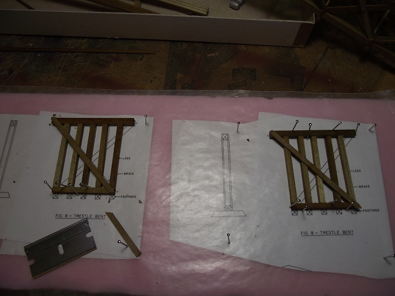

Thanks Lutz and Jim. I checked out Bridgehunters.com and came up with a few ideas for some timber piers/abutments. It would involve building two more bents for the bridge itself, and 4 more shorter ones to make the end piers. More on that later.

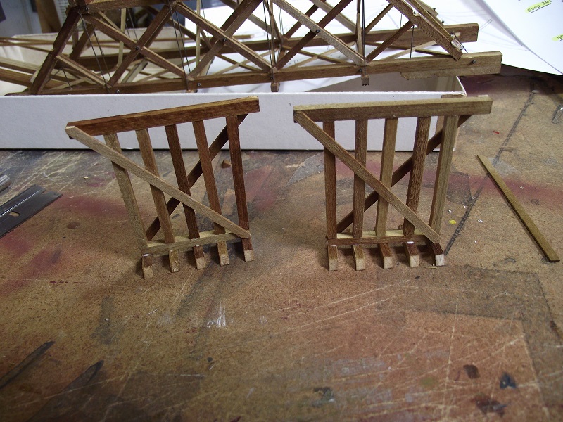

I then built the two end bents, using the kit templates as a jig.
Ready to be glued in place.

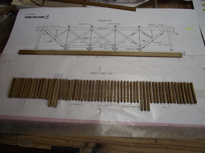

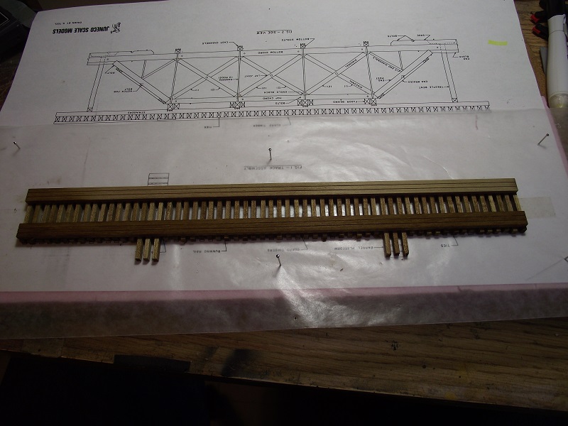

Then I started with the bridge deck, first by taping the bridge ties into place.
Then I glued the glued the stringers to the ties, this is all built upside down.

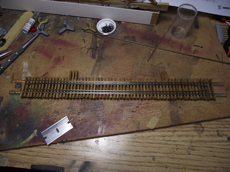

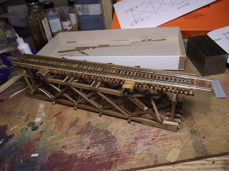

And lastly, I started to hand-lay the track onto the deck. I got about this far when my back started to tell me it was time to stop. I hope to get back at it in the next few days.

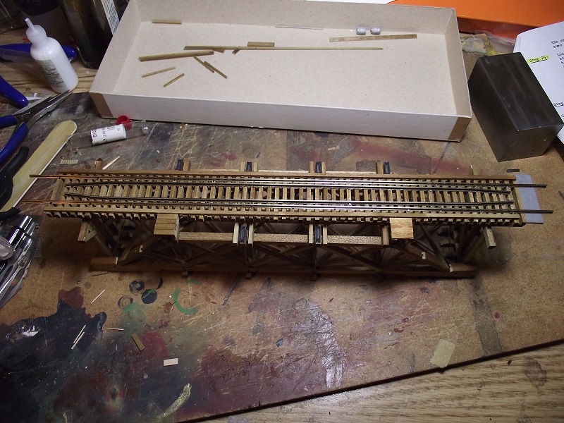

RE: Juneco 75 foot deck Bridge - cnrglen - 02-18-2021
Thanks Kevin. This was my first bridge that I've built. If it wasn't for the top notch instructions, I doubt I could have been able to finish it.

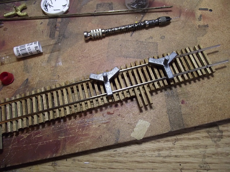

I finished off the trackwork:
I ended up spiking every 5th tie for the main rails, 10th tie for the guard rails. I have spikes that are short enough to just go through the bridge ties and stringers so they didn't interfere with assembling the decking to the main structure later.

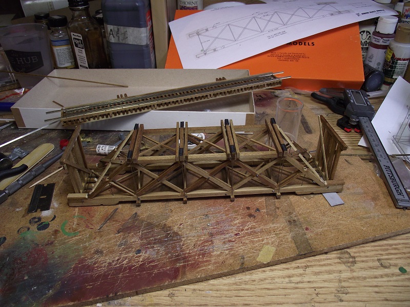

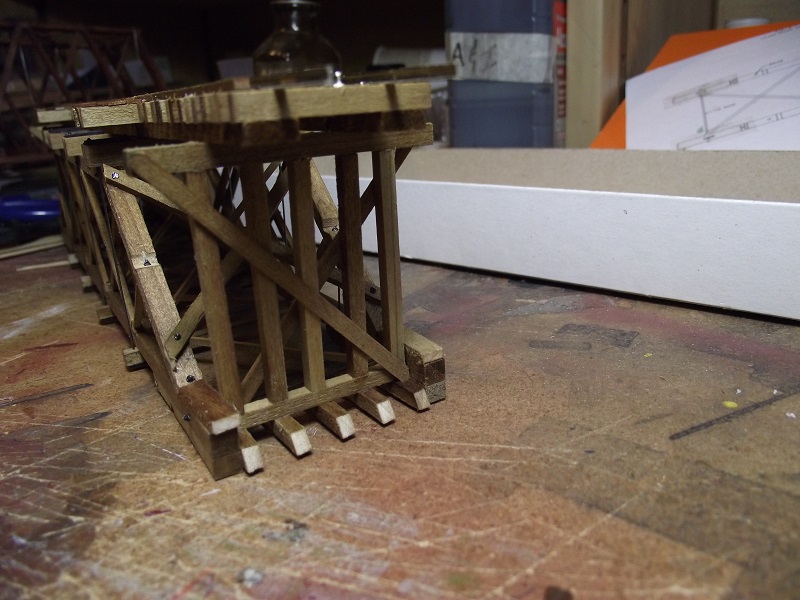

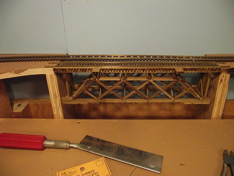

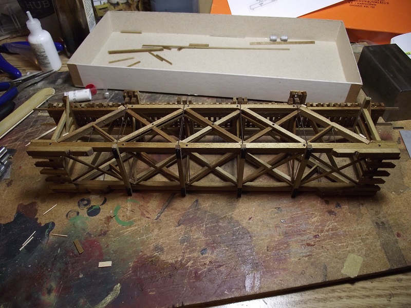

Then I made it through final assembly, starting with adding the bents to the main structure.
and then the deck
Centering the deck on the main assembly took a bit of measuring but it worked out in the end.
And then a quick fit check on the layout:
I was relieved when the bridge fit exactly how I had run the roadbed. Now I have to fill in the benchwork under it and then I can start measuring for the piers and abutments.
