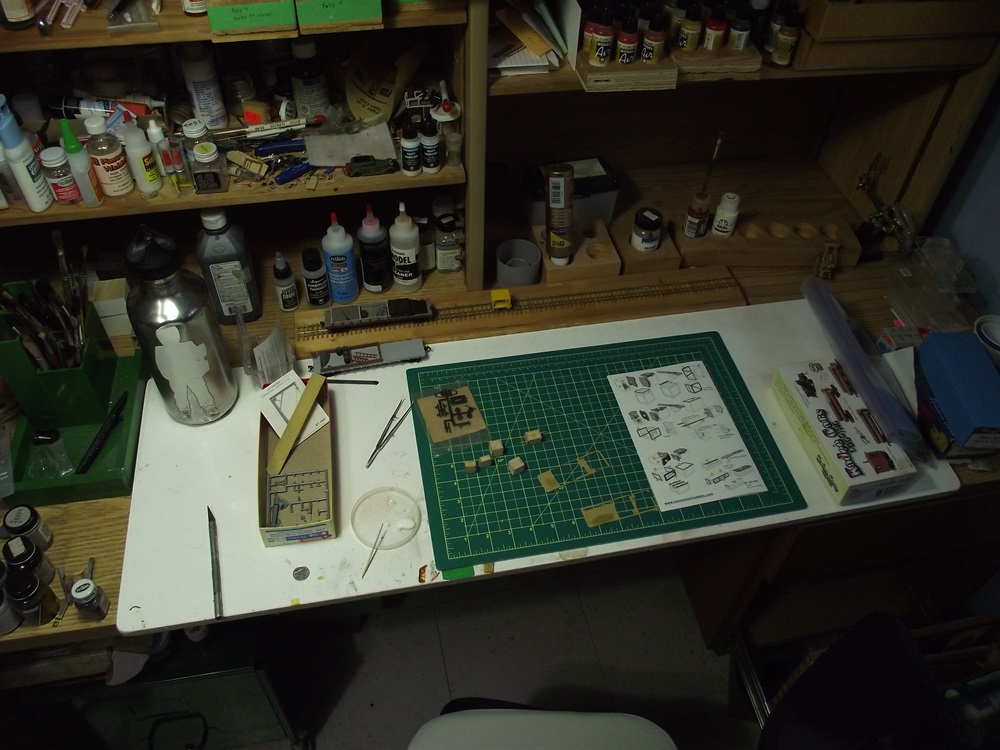

Now that the module is finished and I was able to move it to it's home above my computer desk, I was able to wheel the cart out of my workshop  and place the 'Hemsley' Diorama back onto it.
Then I spent the next day cleaning out the workshop
and the workbench
Now I can walk across the floor withouyt tripping on things and can actually find what I need on the workbench.
