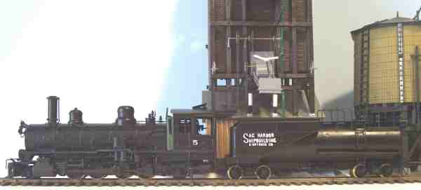

Speaking of Baldwin catalog scaling, the On30 2-8-0 matches this loco in Scale55:
I always wondered why it was so hard to get 1/48 figures in the On30 cabs. I had to use what was essentially Scale55 people.
I have a the spare 2-8-0 in the picture so I will probably make a k-27.

Posts: 2,959
Threads: 158
That Mexican locomotive is from a common Baldwin design, very similar to the c-21 and c-25 class on the D&RGW, #69 on the White Pass and Yukon, and similar to many locomotives used in southern Arizona, Mexico, and Guatemala.
Posts: 179
Threads: 64
The Mexican is a 10-30-e, the Bachmann On30 matches that in Scale55.
