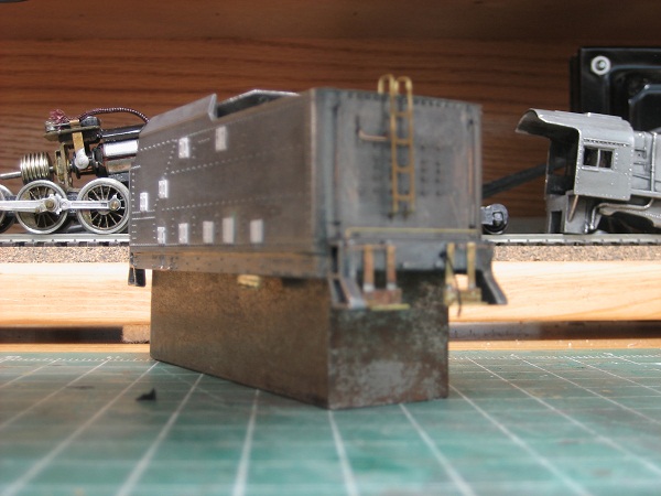

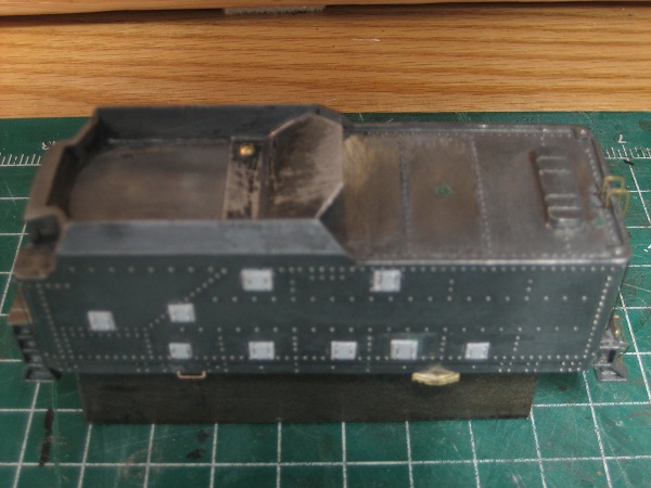

Some progress shots of the tender.I am having trouble finding shots of the tender back. For the standard railroad of the world there seams to be a lot of variations in the way the tender backs looked. I cant come up with a definite location for the back up light. The rest of the details are modeled after the most common locations and styles. I need to hit the LHS for some more supplies.
    I'll post a better shot of the tender rear when I add some more stuff.

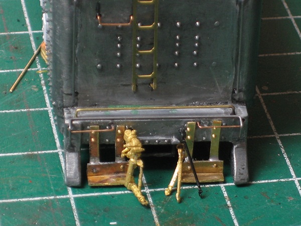

I had a few spare minutes today to install the steam, air and signal lines on the tender rear.
I also added some undercarriage details to the tender floor. I keeping the details on the underside to a minimum, I have no photos or diagrams of the underside. It is also very hard to see them any way.
With this part complete the tender is ready to be washed and primed. I'll paint it at that same time as the boiler when it is complete. N ow I can get that started. Thumbsup

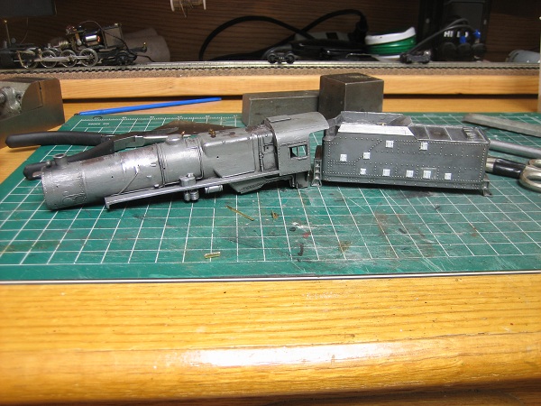

Managed to complete a little more on the L-1. I primed the tender, and did the rough work on the boiler.
I removed all the details that were either in the wrong location or just weren't up to snuff with a rough file and hack saw. I'll smooth those spots with some smaller fine files latter. I'll also fill in any nicks and scrapes with putty before I start to add any new details.
