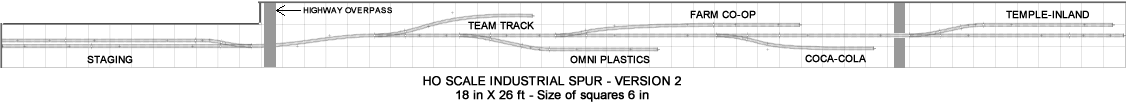

After months of "analysis paralysis" and changing my mind numerous times, I finally took a different approach and have come up with two slightly different versions of a switching layout. The "different approach" was to select the industries that I wanted on the layout and ones that would support the types of equipment I have - the era I am modeling (late 70's to early 80's) - and a mid-west locale.
Since I worked for the L&N Railroad through the 1970's before going back to short line railroading, I wanted the plan to be based on an L&N industrial spur so I could operate L&N power (C-420's - NW-2's - SW-1200's - SW-1500's - MP15's, etc.) in the various paint schemes - the L&N Rebel scheme, Family Lines - even Seaboard System.
The closest thing that I found that would match what I was looking for was Lynch Road in Evansville, Indiana (an area I frequently visit), and my plan is loosely based on that industrial spur, although it's really free-lanced and includes some features from L&N industrial spurs in other areas. I did resist the temptation to fill every available spot with track to duplicate the prototype track to scenery ratio and also I like the nice flat terrain in this area.
Overall, there are just four main industries on the plan, although version 2 adds a fifth.
1) Team Track or Trans-load Track as they are called these days, that will receive lumber, building products, and other odds and ends (2 or 3 cars spot).
2) A farm co-op that will receive feed and fertilizers (3 or 4 cars spot).
3) A Coca-Cola bottling plant receiving tank cars of corn syrup - perfect foreground industry as I need only model the unloading pipes (2 cars spot, room for 1 being held).
4) Temple-Inland Containers - receiving box cars of pulpboard (4 cars spot).

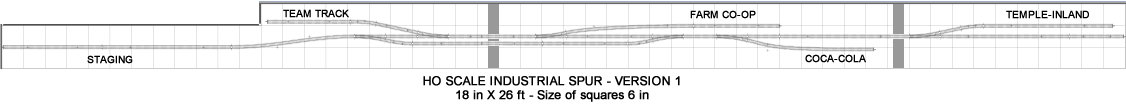

Any way, at this point I'm ready to start laying the track, but am still stuck with a bit of "analysis paralysis" in so far as I'm undecided which of these two versions of the plan to call the final version! The overall plan dimensions are 18 inches X 20 feet with a narrower 6 foot staging section for a total "main line" length of 26 feet.
    Version 1 - has a long run-around track as on the prototype spur which would allow the yard crew to enter and leave the spur with the loco leading and permit spotting cars on the one odd facing spur. On the prototype spur, all industrial tracks switch from the same direction except one, so that's more or less prototypical.     In version 2, I have all the industry tracks facing the same direction and have added one other foreground industry along with a highway overpass that sort of separates the main layout from the staging area. Have also included a second track in the staging area, the idea being that I could have two different trains staged to switch the spur (a first shift and third shift crew). I could do the same thing with version 1 if desired.
Since the right most area of the plan is pretty well fixed, I'll no doubt go ahead and at least lay and wire the track for Temple-Inland and Coca-Cola and just temporarily put a long switching lead down until I decide which plan will be the final version. With the switching required for just these two industries, it should give me a good feel for how the plan will work.
Oh yes, on either plan, the staging track area will have scenery too, as the idea of a bare narrow "staging cassette" doesn't appeal to me, and the staging area is permanent and need not be made removable.
Which version appeals to you folks and why?

While the prototype would take the upper choice with all tracks facing the same direction I prefer the lower layout for a model. It is simply more "fun" to switch with a run around.
I agree with Reinhard, I like #2 for the added interest of run-arounds. But I would add the second staging track as in the first option.
Edit.... er, mistake. I like number 1 for the runaround, but add the second staging track.

After spending some more time this morning positioning track on the bench work, I'm inclined to agree with both of you and for a several reasons.

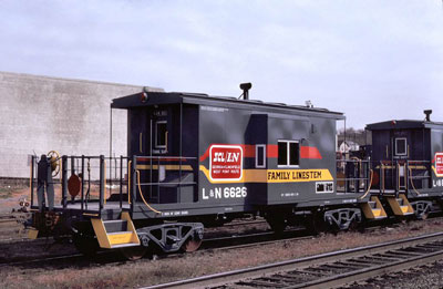

Including the runaround track does help to capture the flavor of the prototype industrial spur that this is loosely based upon. Also in the era I model, the crew would be working with one of these neat L&N cabs when they worked the spur, which adds some additional moves to the operation...         BUT ALSO something hit me on the head and when I came too, it dawned on me that I could operate the layout as different themes should the mood strike me.

Here's my final(?) version of my L&N Industrial Spur plan - which will include the runaround track. I've introduced two very broad curves into the plan and angled the "main track" which looks like it will break up the linear look quite well. Also added two "storage" tracks on the staging portion, although it may end up just being one additional track. When I try to put a runaround in the staging as suggested by Herc Driver, I end up with a rather short siding so I'll just go for having yard jobs staged on these tracks or use two of them for car storage. Also included the highway overpass to separate the main part of the layout from the staging area.     Now I just need to get started layout the roadbed and track!
