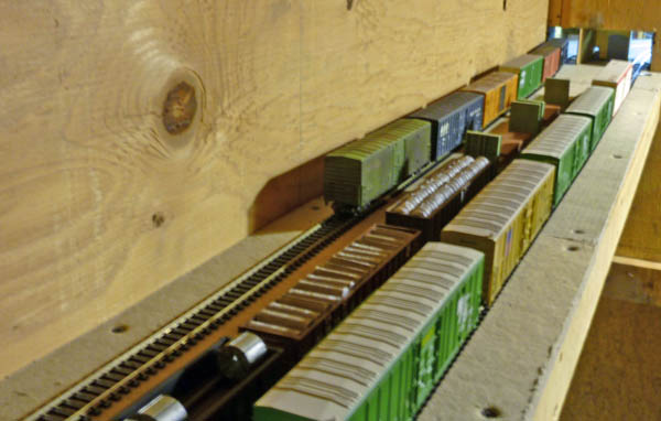

Pier 32 though not on the edge of the layout has three tracks inside which can hold up to twentyeight cars.
