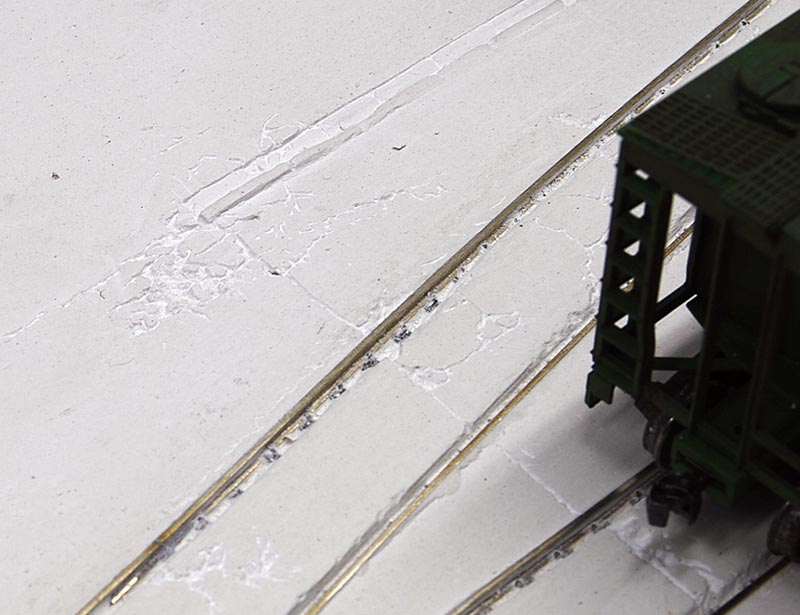

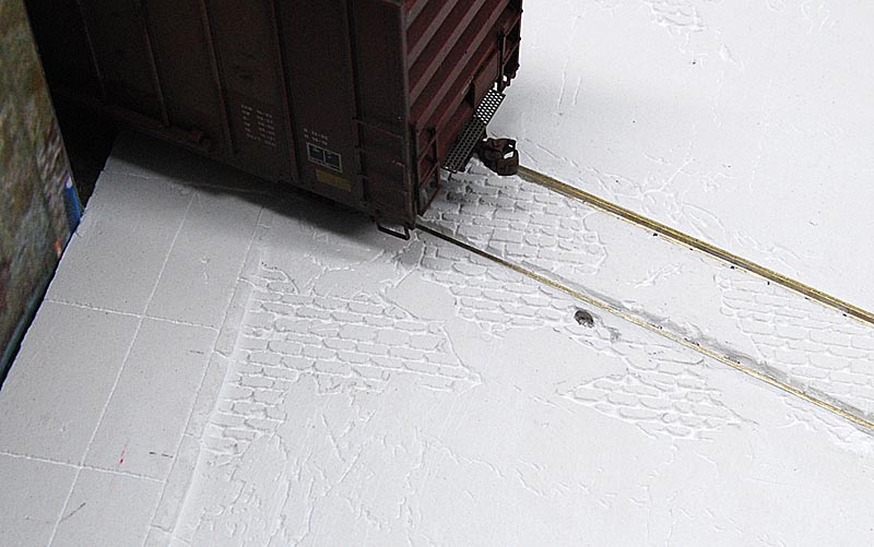

Usually I use cardboard and sanding paper to build the streets on my layouts, but this time I decided to go for plaster, because I want to have details like cracking asphalt and patches where old pavement is showing through. I poured the plaster for the streets on the right half two days ago.
[Image: la7.JPG]
[Image: la8.JPG]
Then after clearing the flangeways and carving out the streets and sidewalks, I am working on the details now.
[Image: la9.JPG]
[Image: la10.JPG]
Kurt

Good luck scribing all of that plaster Kurt. Can I ask what tools you use for carving/scribing the plaster, I think the way you cut out those paving stones and curbstones.
My Miami NW 22nd St layout and modelling blog http://dlmr.wordpress.com/ Please come by and leave a comment.
#25
Dave, I am using a scalpel with a #11 blade to scribe the plaster. I showed how I am doing it here on my last layout thread: <!-- l --><a class="postlink-local" href="http://www.the-gauge.net/forum/viewtopic.php?f=46&t=3895&start=45#p69340">viewtopic.php?f=46&t=3895&start=45#p69340</a><!-- l -->.

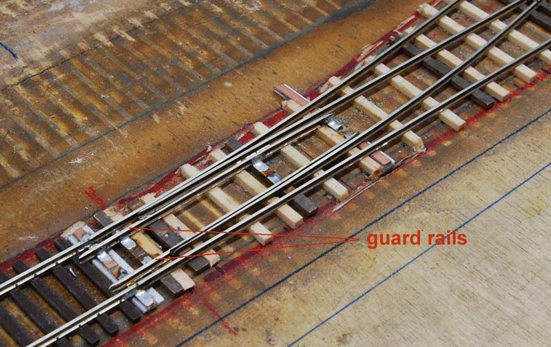

How did you protect the turn-out points from the plaster?
Are you working from photos while carving the plaster?
#27
Good theme and off to a great start!! Thumbsup
#28
Hi Kurt
Like all the other contributors who've posted here, I'm extremely pleased to see you back; plenty of great ideas to pinch (sorry) copy Icon_lol and the Patch too - the line that pushed me over to the dark side!!
However, I'm a little saddened to learn that your not building a historical model of the Patch; I sincerely believe you'd have done it justice. Therefore, any chance of changing your mind before you go headlong into the (almost) present day?
Best wishes, anyway, and welcome back.
Jonte
#29
Gary, I had a close look at the surface of Palmetto Street with Google Street view to see what these cracks and other imperfections look like and then I just carved away hoping it would turn out right.
To protect the turnout points from plaster I first soldered two guard rails to my TO like I saw them in pics showing the street trackage of the Chicago Terminal Railroad. So the points would be protected from one side. Then before pouring the plaster I put pieces of stripwood (flush with the top of the rails) into the gaps between the stock rail (respectively the guard rail) and the point rails. So when I removed these pieces of stripwood after pouring the plaster, only little plaster had to be scraped off to make the point rails move freely again.

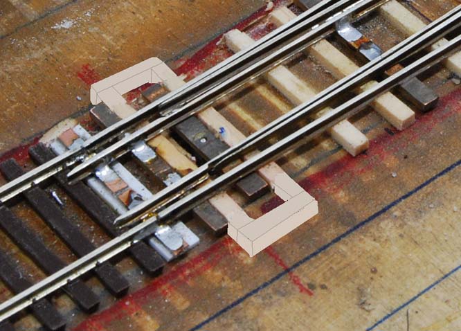

To protect the throwbar I glued some short pieces of ties around the throwbar as shown in the next pic. Then I covered the area with .013" styrene.
