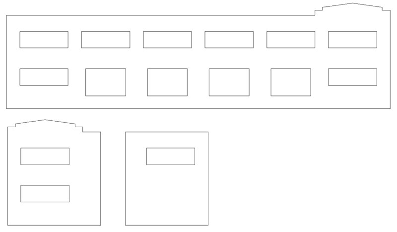

Anyway, today I took a break from carving plaster. I started to build the first warehouse: <!-- m --><a class="postlink" href="http://maps.google.com/maps?q=los+angeles,+palmetto+st&hl=de&ll=34.04039,-118.232999&spn=0.015256,0.033023&oe=utf-8&client=firefox-a&layer=c&cbll=34.04039,-118.232999&panoid=3FPnyFCD3JUTjMZEm8UJ3Q&cbp=13,327.68,,0,-5.5&t=h&z=16">http://maps.google.com/maps?q=los+angel ... 5&t=h&z=16</a><!-- m -->. It has been turned into an office building, so I am building it as I found it in pics from the 1930s and 1960s with a line of loading doors in the wall facing the track. Though I shortened the structure by about 1/7, it is still 18.9" long
As usual I first did a scale drawing, printed it out and glued the printout to a .060" sheet of styrene. If anyone would like to build this warehouse, the drawing can be downloaded here (PDF file): <!-- m --><a class="postlink" href="http://www.cnw.mattheydesign.de/Palmetto_Street_warehouse.pdf">http://www.cnw.mattheydesign.de/Palmett ... ehouse.pdf</a><!-- m -->

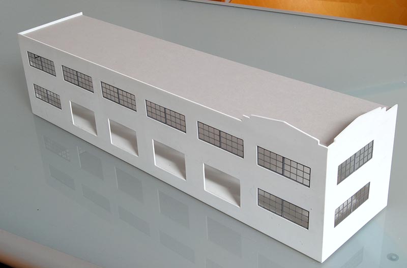

After cutting it out and fitting the windows (Tichy Train Group #8051 – two of them glued together for one warehouse window), the front wall looks like this:
[Image: la15.JPG]

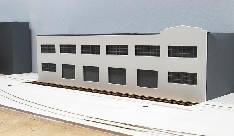

I made a little more progress on my warehouse. Tomorrow when the glue will have dried completely I will sand the corners and the I can go on adding details.
[Image: la16.JPG]
Kurt

cnw1961 Wrote:As usual I first did a scale drawing, If anyone would like to have this drawing (as a PDF file) to build this warehousw, please tell me.
There's this expression of something a bear does in woods, at least that springs to mind here :-) Great looking building indeed!
Yes, I'd like a copy please :-) Thank you!

Koos, I ccould not find any re-inforcements on this building, even in this old pic from the '30s (what a coincidence, eh? Misngth ): <!-- m --><a class="postlink" href="http://www.flickr.com/photos/gvgarcia/5309666267/sizes/l/in/photostream/">http://www.flickr.com/photos/gvgarcia/5 ... otostream/</a><!-- m -->. I assume it is a concrete building.
I uploaded the drawing, so you can directly download it here: <!-- m --><a class="postlink" href="http://www.cnw.mattheydesign.de/Palmetto_Street_warehouse.pdf">http://www.cnw.mattheydesign.de/Palmett ... ehouse.pdf</a><!-- m -->
