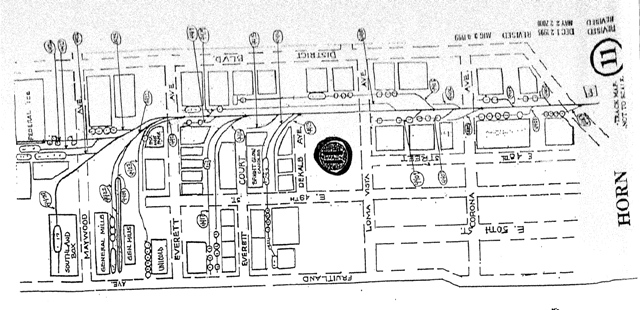

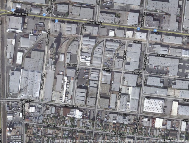

        Here's a couple of images from my collection of info on the Los Angeles Junction Ry's Horn Lead. As you can see it is very compact. This is one of the places visited by Reinhard, Russ & me 7/20/11. The 1st one is the the track chart & the 2nd is the aerial. The industry in upper left is Federal Cold Storage. Below that is Southland Box Co. & to the right of that is General Mills. The only one getting rail service today is General Mills. But in my '60s era version they'll all get rail service! The east-west streets are District Bl top & Fruitland Av bottom. On the left side of the aerial is the UP San Pedro Sub. The connection w/ the J is just about a block north.
Andy Jackson
Santa Fe Springs CA
ATSF/LAJ Ry Fan & Modeler
