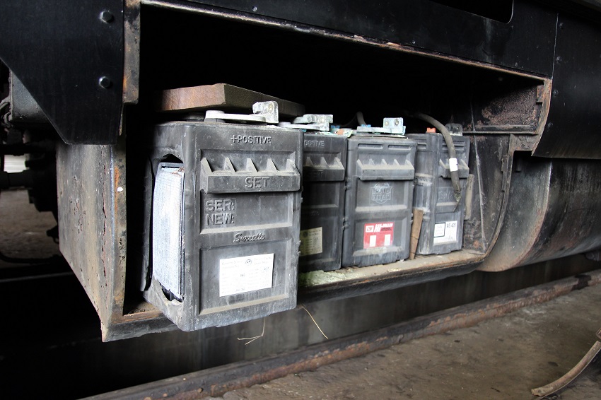

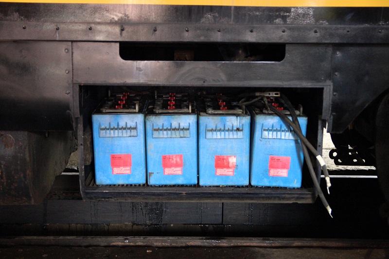

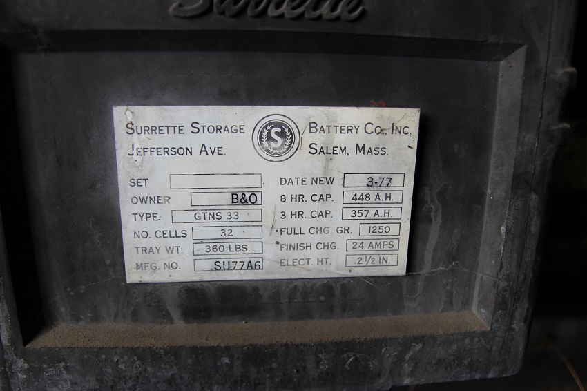

B-unit batteries... The batteries have been prepped for removal. This doesn't sound like much until you do it. They each weigh in at over 300 pounds and have swollen, cracked, and welded themselves into place. They haven't held a charge in about 40 years, and don't even get me started on how corroded the bolts are that hold the cables on. The cables will have to go also. Normally there are 8 batteries, luckily 3 of em are missing. That's 3 less to deal with.
I believe I have brought this up before but 2 of the batteries are marked as coming from the B&O. How B&O stuff ended up on a B&M engine, we don't know.
Once they are out and the cables replaced, we can put power to the unit and find out what works and what doesn't.

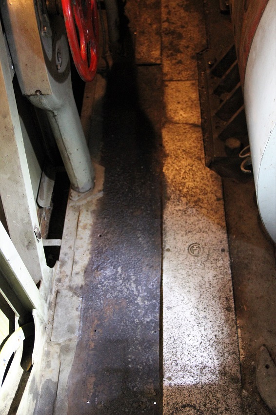

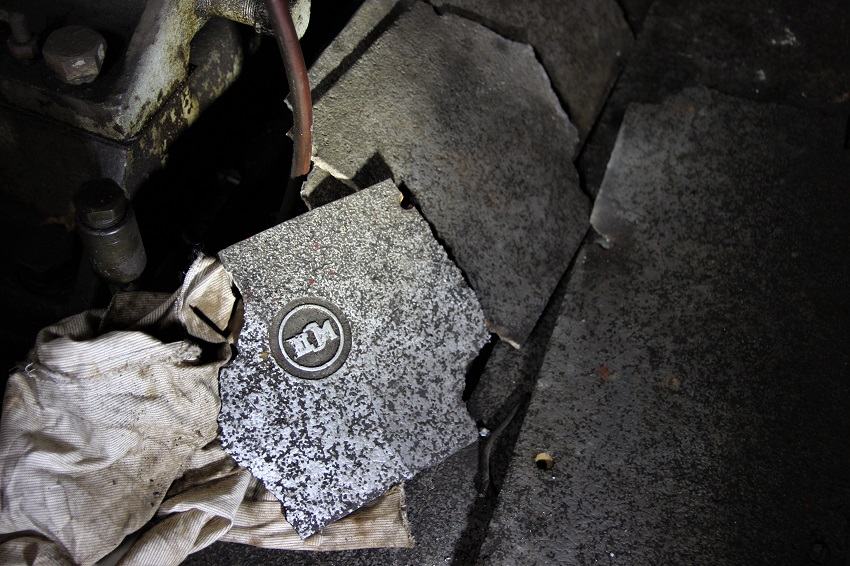

As for 664 we are replacing some of the aluminum anti slip floor treads in the engine room. Some of them are marked with the old EMC logo. They are cracked and warped creating a tripping hazard. They will be replaced with diamond plate.
After they were removed, we coated the steel underneath them with rust converter. What EMD was thinking about when they decided to place dissimilar metals on top of each other, in a battery environment, that does get wet is something I don't know. In a few spots we will cut the steel floor out and re-weld a new sub-floor in, because of the amount of rot that has happened.

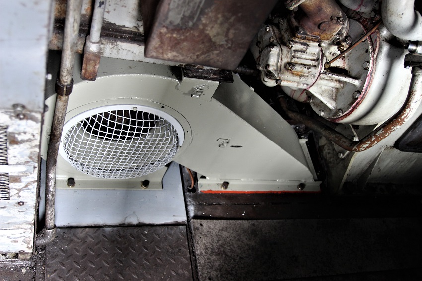

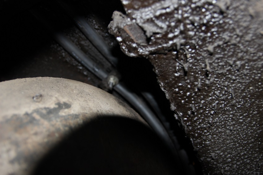

We also removed the blower motor and housing for the #3 traction motor. The oil leek common to all early EMDs keeps ending up in the #3 blower and then spraying into that traction motor. This causes all kinds of havoc.
As you can see we cleaned, repainted, and gasketed, the entire motor and housing. What cannot be seen in the pic is that we installed a dam behind the ductwork that will divert the leaking oil into the sump where it belongs and keep in out of the blower. I don't think that EMD ever thought that this blower would ever be replaced before the units were traded in for replacement loco's or they would have engineered it in a way that it could be removed without a HUGE amount of work.

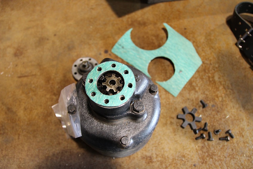

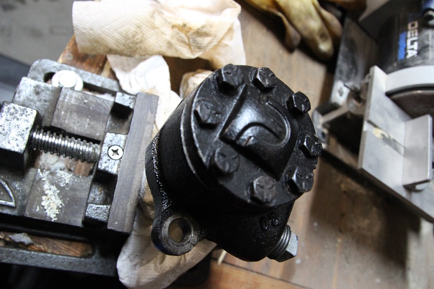

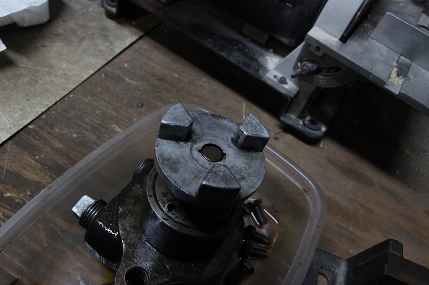

Here's a few pics of the fuel pump on my work bench. Normally it is attached to a 72 volt DC motor, but that is waiting it's turn in a motor shop in Jersey for a rebuild.
She was completely frozen with rust. These pumps are simple and super robust, a little rust ain't enough to keep it out of service. After a soaking in a CRC product called "KNOCK 'ER LOOSE" for about a week, a few taps with a hammer, and a twist of a pry bar she broke free.
A look at the inner workings of the pump.
Here is a shot of the coupling end that normally attaches to the pump motor.

A new gasket was cut for the pump that I have been working on at home. She will be permanently installed into 664 as a pre-lube pump once the motor comes back from the rebuild.

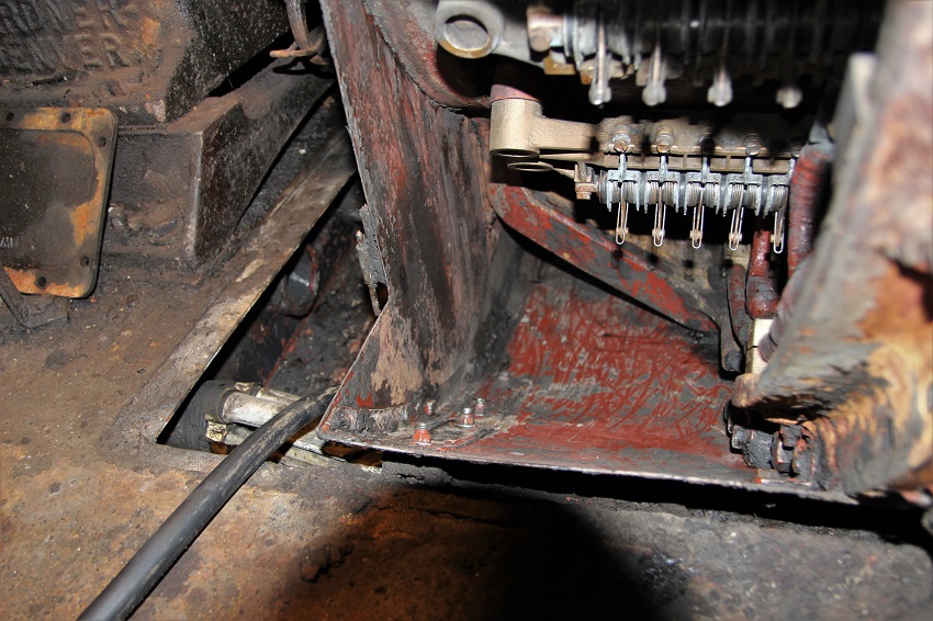

The big job that was accomplished on the "B" this week was to rewire the battery feeds from the boxes to the main cabinet, and to run new cable from the starting contactor to the generator. On locomotives like this, there is no starting motor as in a car. You back feed power from the batteries to the generator to get it turning like an electric motor. This provides the rotation of the engine block to start the diesel engine. The rewire went very well only a few sticking points, like this one...     In the pic that little nut holding the wire clip to the underframe of the "B" doesn't look like much until you realize that it's here.     tucked waaaaaay up over an air tank next to a frame member. The wires in the pic are the positive battery cables running to the battery boxes.

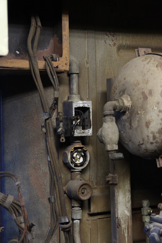

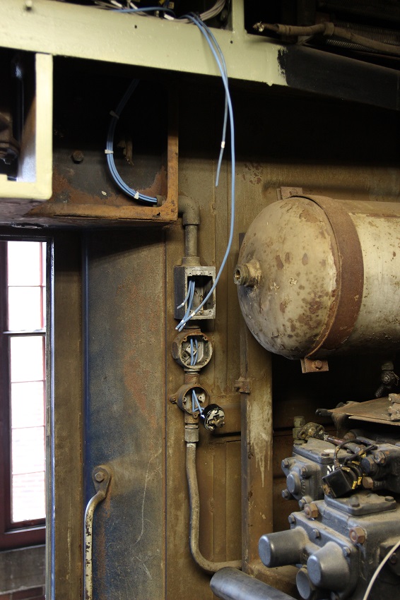

During yesterdays work session we stripped all the wire from the conduit near the end door on the "B".     This was then replaced with new and all the devices tested and reinstalled. The larger wire to the left is from the now unused MU receptacle that was over the end door and a receptacle used to connect the dynamic brakes to other engines. The switches seen here are for the headlight and engine room lights. We will do the same to the other end possibly next week, depending if we get a crimper to install the terminals on the battery cables we installed last week. We are also planning on reinstalling the generator brushes as soon as we can get them in. The only difference will be that the other end will need a spot to plug in the pre-lube pump.
While this was going on another member did some copper work replacing the air line to the horn. This was stolen by copper thieves while the unit was parked in south Jersey. Sorry for the strange angle but it was the only way to get it all to fit in frame. I drew an arrow pointing to the horn valve.

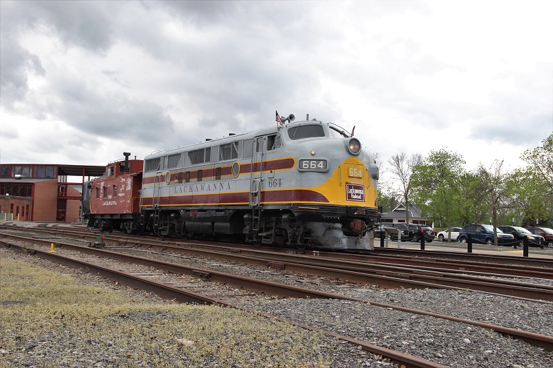

It was a very Rainy day yesterday, as it has been for the last week or two. During a quick break from the rain I ran out to the board walk to catch 664 on the caboose hop.
Steve, where is the horn on the unit?
another query: Is the wiring standard house wire or do you need something heavier?
If you are looking at the end where the cab would normally be, it would be in the upper left corner facing down. That is the standard EMD location, some railroads opted for it to be mounted in other locations. Other railroads, like NS, removed it including the headlights and bell during rebuilds if the holster cabs were removed. But then, the locomotive could not be moved independently, only MUed to another locomotive with a cab. I'll get a pic for you next weekend to show it better. The bell is mounted to the frame, under the locomotive, between the truck and battery box.

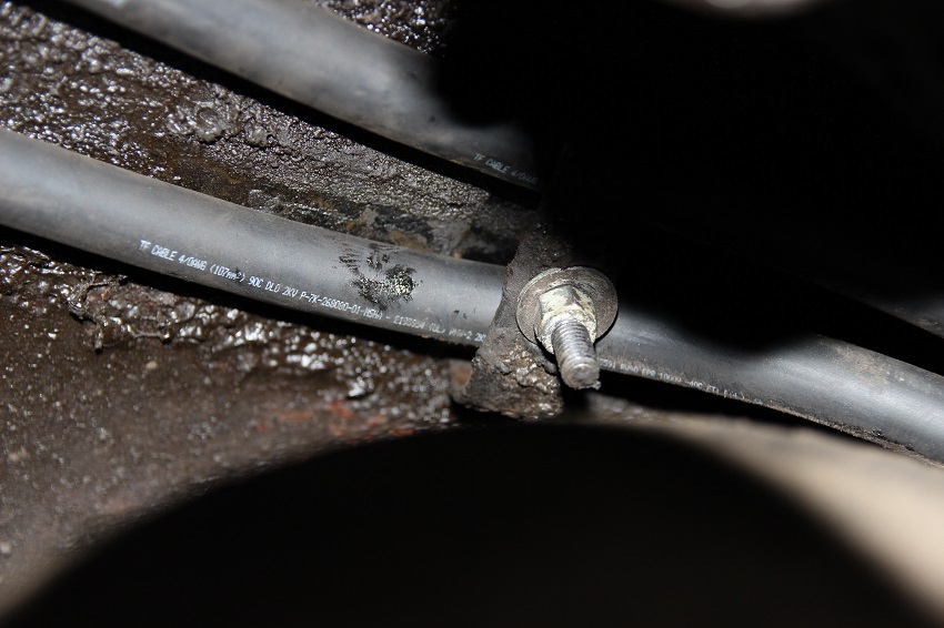

The wire is called DLO wire. It is a finely stranded wire that is very flexible. Each strand of wire is coated in zinc to prevent corrosion. It's capable of remaining flexible even after being heated over and over again for years at a time. The maximum wire size is 500 mcm on most locomotives, but most of the control wire is either #12 or #14.

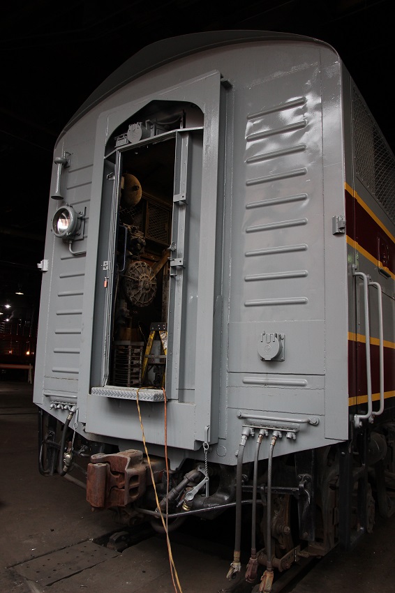

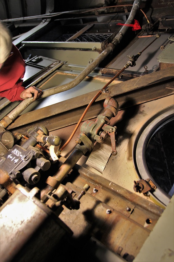

As promised here is a shot of the "F" end of the "B", where a cab would normally be. The horn is in the upper left corner. This pic also shows the original location of the MU receptacle above the door, The B&M had relocated it to the more traditional location where it is much easer to reach just, above the air hoses. We did the same on the other end.
Speaking of the air hoses, looking at the ones under the "MU" socket,, the line closest to the coupler is for the main reservoir and the two smaller ones are for applying and releasing the independent brakes. They are repeated on the other side. The larger hose under the coupler is the train line, or automatic brake. The Headlight is visible next to the door, and is in the same location on the other end. To the left of the upper "MU" socket is another receptacle for the dynamic brakes, soon after these units were put into service the separate dynamic brake sockets were disconnected as it was found that they could be controlled through the existing MU jumper.

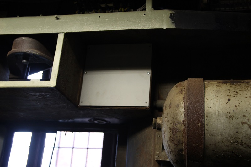

With the wiring completed for the light switches on the end door we cut and primed a cover From some steel to cover up the junction box.

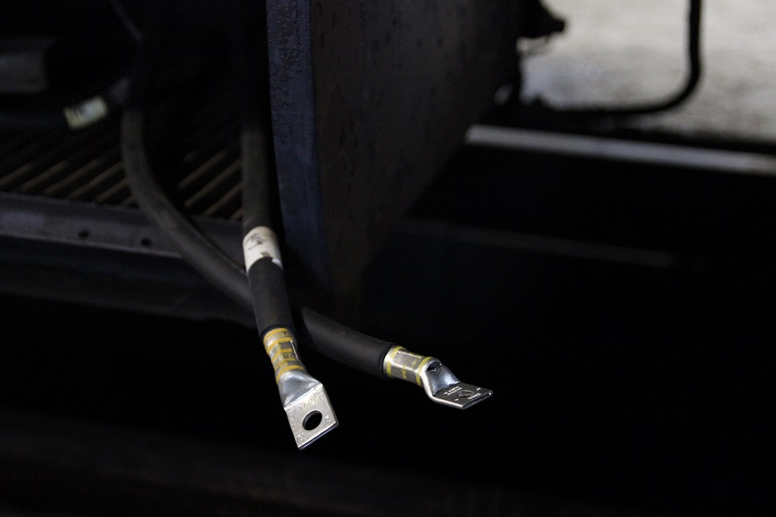

New terminal ends were crimped onto the battery lines that were pulled the other day.
And with the help of a forklift eight temporary batteries were wrestled into place.
