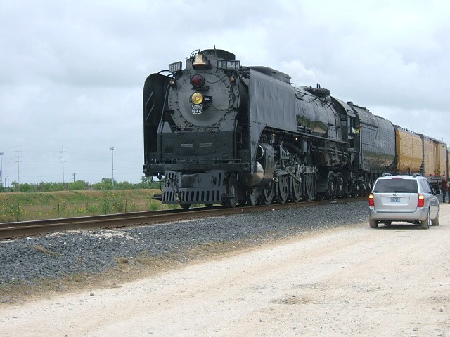

Great shot !!! you can clearly see that 844's drivers are as tall as the vehicle ! How's that for a sense of proportion !!! Big Grin

The size of the engine is staggering....But what is more impressive is its mechanical "perfection". When it began to move I was expecting all sorts of creaks and groans...Not to be...It started up as smoothly as your grandpa's Cadillac...Amazing.... Eek
