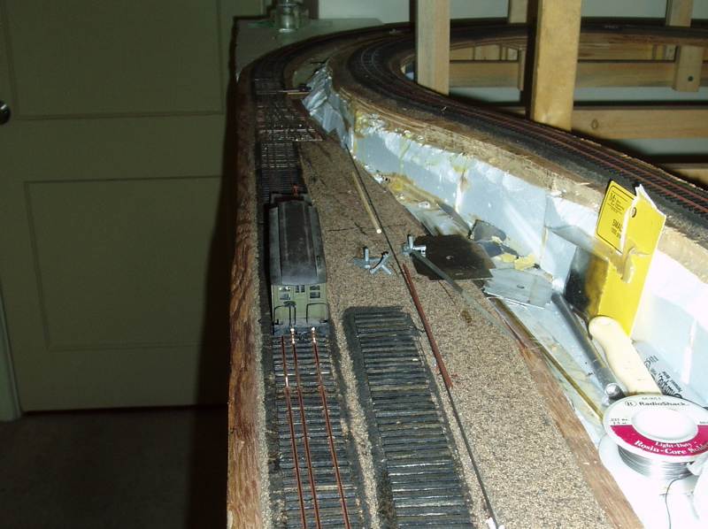

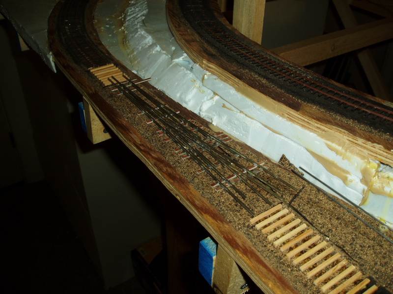

Here is a just completed dual-gauge turnout, ready to install in it's new location. Perhaps I will get that done tomorrow night. After that, it's trains in circles for awhile to test my trackwork before hiding it in tunnels Smile

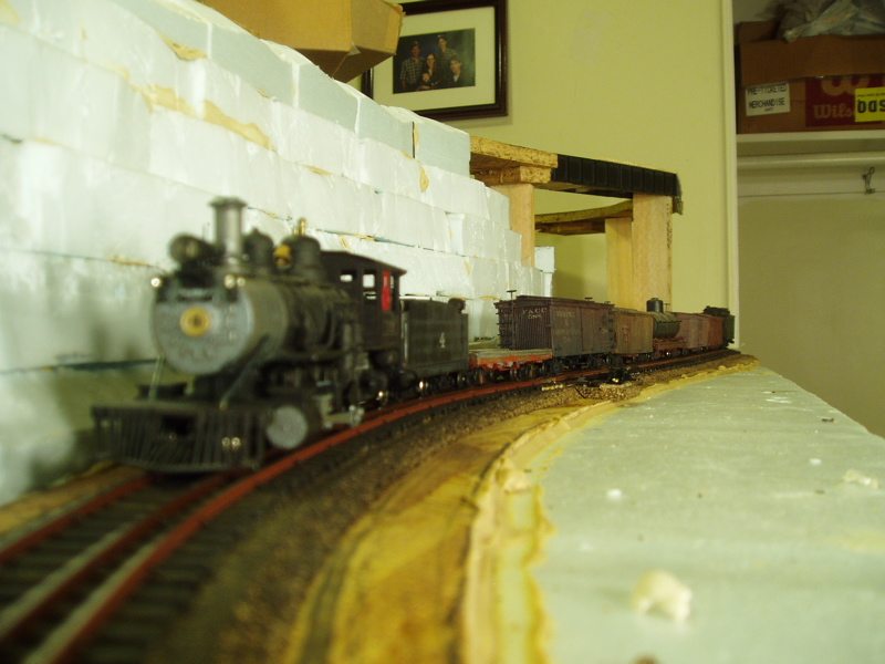

For the first time in about two years, I got to run some trains! I was just testing my trackwork out, but I ran a standard gauge train with about 6 cars continuously for about an hour, then the other direction for an hour, and then actually backed the train around the loop a few times and had zero derailments. One of the cars was bumping a little going through a switch, but I traced that to a wheelset slightly out of gauge. Then I made up a narrow gauge train, seven cars plus a caboose. Again, it made several laps and zero derailments.
2-8-0 #4 is another story. I had her down for awhile while I converted her to an oil burner, and at the time noticed the crank pins were really worn. I had to drill out the counterweights and custom make new crank pins out of brass tubing and some 00-90 screws.

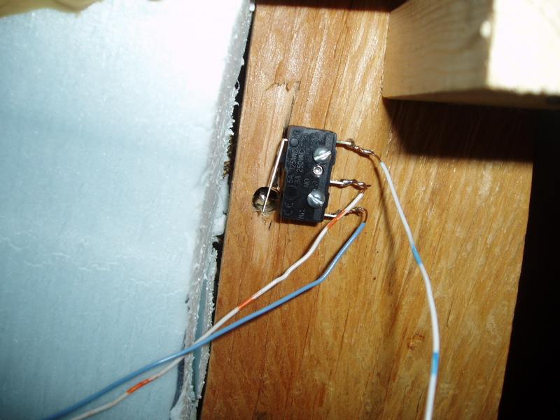

I'm surprised someone noticed that detail! Before I was using one of those caboose industries throws with the electrical contacts in order to power the frog. Needless to say, I was dissatisfied with its performance, so I changed it so now the frog is powered using a SPDT switch mounted under the layout and controlled by a rod from the throwbar. Because there is a section of benchwork below that switch that prevented me from mounting the SPDT, I had to make a new throwbar and re-locate the ground throw to the other side.

Quote:so now the frog is powered using a SPDT switch mounted under the layout and controlled by a rod from the throwbar.

That is just, just,.......beautifully simple!

I am not sure where I got the idea from, but I am sure I saw it on somebody's website or posting online. And it is remarkably simple, and so far works well. All you need is to find a place to mount the switch, and some way to transmit the motion of the throwbar to the switch. I used stiff steel music wire protruding from the bottom of the throwbar through a 1/4" hole in the subroadbed.

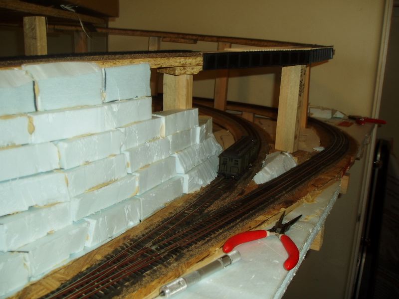

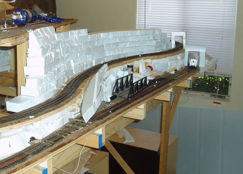

Well, I got a little antsy and started building some scenery before all the tracks were laid. "Antsy" is only part of the story - I was also concerned as to how the scenery would lay out according to my plan, and if my plan was even feasible. I also had frustrations of dropping track-laying tools through the benchwork and a lack of places to lay down my pliers and rail gauges. So, vertical scenery has begun, and hopefully this won't mean I have to change my track design in the town of "Joys Camp" to accommodate some topography.
I am using 1" foam to build landforms. As foam is typically used to insulate basements, and there are few basements here, 1" is all that is available in my area, in 2x8 foot sheets. I have little experience using foam for scenery; in the past I always used plaster. I chose foam because my plater mountains always had a "bulbous" appearance, and I wanted to emulate more layered conglomerate rocks. Plus, there is none of that plaster-drippy mess. I cut the foam into smaller pieces and stack it like blocks as I feel this will result in a "choppier" appearance with more nooks and ledges. I have also been making my landforms hollow by staircasing the foam along the edges of the escarpments, leaving the center open. This saves foam, and will allow easer access to the inside of the tunnels from under the layout.
The top of the topography will extend about 10" above the top tunnel portal that you see. The total vertical relief will be about 18" - not bad for a 4x8 layout.
