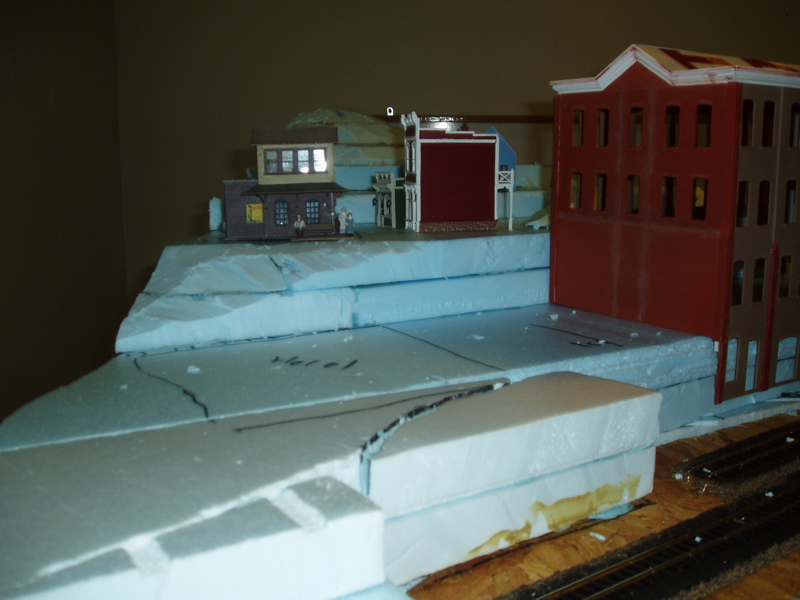

I now have a decent size hill on one end of my layout. Unlike most areas, the town will be built on the side of the hill (note the cut and fill contouring) I still have a bunch of work to do on the town side of the hill, but that will happen as I get buildings finished and the footprints of the buildings are known. To build the hill, i simply stacked up layers of 1" foam and carved it with a knife. Once I get the basic shape the way I like, I will cover the whole thing with sculptamold.
It looks like it will be a steep town, but the reality is it won't be as steep as the prototype. Eek Much of Morenci Arizona was built before automobiles, but even after autos came to town, many houses were only accessible by mule or staircase!

I love it that the town looks too steep, yet isn't as steep as the real thing!

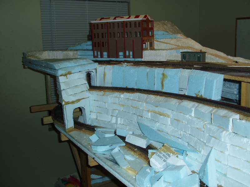

here are a couple more quick snapshots showing more scenery cosntruction.
#55
Those rock faces are going to look really dynamic once you get them all done up. Should make for some cool photos. Congrats on the Golden Spike moment too! Thumbsup

I am still deciding how I want to do the rock faces. In one location, the rock face will likely be the edge of a slag pile.
I have also been considering using different methods for the rocks on each side of the layout. On the "junction" side of the layout (where the NG and standard gauge join), I want that area to look like an area further out into a valley. The idea is that the narrow gauge diverges from the standard gauge in a valley, then the NG proceeds to climb uphill toward the mining town of Joy's Camp. Having different rock types exposed along the line may help with the illusion of distance. Transitions between mountains and valleys have a predictable geologic sequence in southern Arizona, most of Nevada, and western Utah. The mountain ranges are a combination of tilted and faulted sedimentary rocks, and crystalline igneous and metamorphic rocks. As one travels towards the center of the valleys, thick sequences of semi-consolidated conglomerate rocks are encountered that get finer-grained towards the center of the valley.
I want the "junction" side of my layout to represent these conglomerate rocks. I have been considering different ways of modeling this type of terrain, but will probably try carving the foam into a basic shape, and then coating the foam with some kind of a slurry that contains a varied assortment of sand. It needs to have a particular layered appearance, and that may take some very careful attention to detail.
The other side of the layout will be hard rock. I want this side to represent where the railroad has made its way uphill towards the ore-bearing bodies. I will probably model the crystalline rocks using standard rock mold casting techniques, and may include some tilted sedimentary rocks at one corner of the layout.
No matter how I eventually model the rocks, I want the entire landscape to be constructed of foam before before I start adding rock faces.

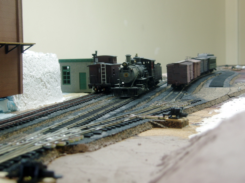

I've slowly been making progress on my layout.
The first photo shows the progress of my town, all of the buildings need details such as window glass and signage, and I think that will wait until I decide exactly where they go and what they will be before I add those details.
The second photo shows the progress of my trackwork. I have the siding to the company store and the team track/station completes, as well as one run-around track. I still have one more yard track to complete, as well as the enginehouse, turntable, and smelter tracks. Unfortunately, I have to buy more rail before that happens. The good thing is I have enough trackwork done that I can play around with switching cars around and testing out the turnouts. So far, things have been working well. One turnout (the first one I made) needed an adjustment to the points, but it was no big deal.
