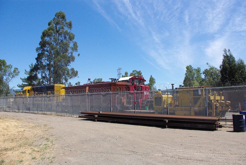

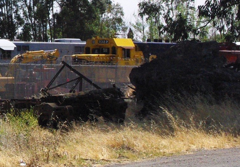

If you're looking for a Santa Fe GP7u still in California on a short line, there's the Northwestern Pacific (restart as of 2011). It has a number 1322:
The NWP isn't much like the LAJ, though -- it runs through gentrified exurbs.
