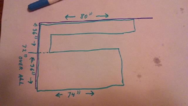

#24
No art award here lol
#25
Hi Harry,
Thanks for the drawing. I was seeing a few configurations for the dimensions you gave me, but that wasn't one of them. Glad I asked.

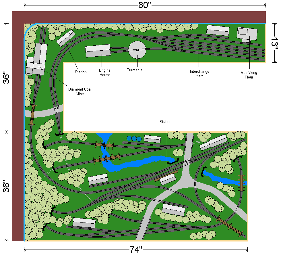

Hi Harry,
Here's my first attempt at a layout for your space.
The track plan consists of a continuous run loop with a passing siding, and two branch lines. Both the yard and town site are on the branches off the main loop. There is also plenty of opportunity for some nice scenes with river crossing, overhead highway bridges, along with a few tunnels and mountain scenery.
Operations of the daily local would consist of making up a train at the interchange (staging) yard, circling the loop a few times doing some switching along the way, then cutting off to the town to do more switching. The loco would be turned on the wye and return to the yard. Coal trains would operate between the yard, and the Diamond mine as turns.
Here's the design:
Take care,
Rob.
#27
sounds interesting but no design showen up??

Hi Harry,
I had a link to the graphic file on my server, but the server seems to be down this morning. I placed it as an inline attachment.

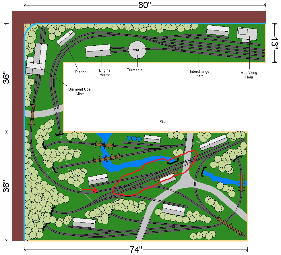

#29
I like what I see so far out of this design. Only thing I'm trying to visualize is how a few coal cars with the engine in the lead may set the cars out or wait for another engine to come up to the point of pick up. Worst case for me but not a huge deal if other switches could make things better feel free to add to it to see what changes may be better.

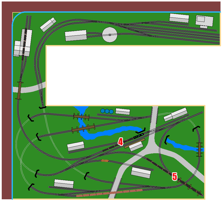

Hi Harry,
I'm glad that you like the plan. I think it offers a lot of operational potential, plus give some nice scenery options. As for switching the mine, it is pretty straight forward even with the track that is there, but I will try to explain my thinking using both words and graphics.
The graphic above shows the start of the day with a train of 10 empty 2-bay coal hoppers ready to leave the interchange yard depicted in position #1. There are also 10 loaded 2-bay coal hoppers waiting at the coal mine to be picked up depicted in position #2. The empty coal train leaves the yard, and makes a few laps around the mainline.
After making the laps, the caboose if cut from the train and left of the mainline. The crew then pulls forward and drops the 10 empty hoppers on the siding depicted by #3. The loco is then backed onto the caboose and taken into town and both turned on the wye. The caboose is then left on a siding while the mine is switched.
After dropping the caboose, the crew runs uphill to the mine and brings down just 5 loaded hoppers at a time to the position depicted as #4. The crew uncouples the loco, and runs around the 5 hoppers, and starts building the outbound loaded coal train on the wye depicted as #5. Once the outbound train is finished the crew takes just the loco down to pick up the 10 empties still at position #3.
The loco pulls the 10 empty hoppers back to town and stops in position #6. The crew then pushes the 10 empties up the hill, and splits them between the two tipple tracks at #7. The engine crew returns to town and backs onto the 10 loaded hoppers still on the wye in position #5. Before leaving town, the crew backs onto the caboose and then departs for the interchange yard where it started.
