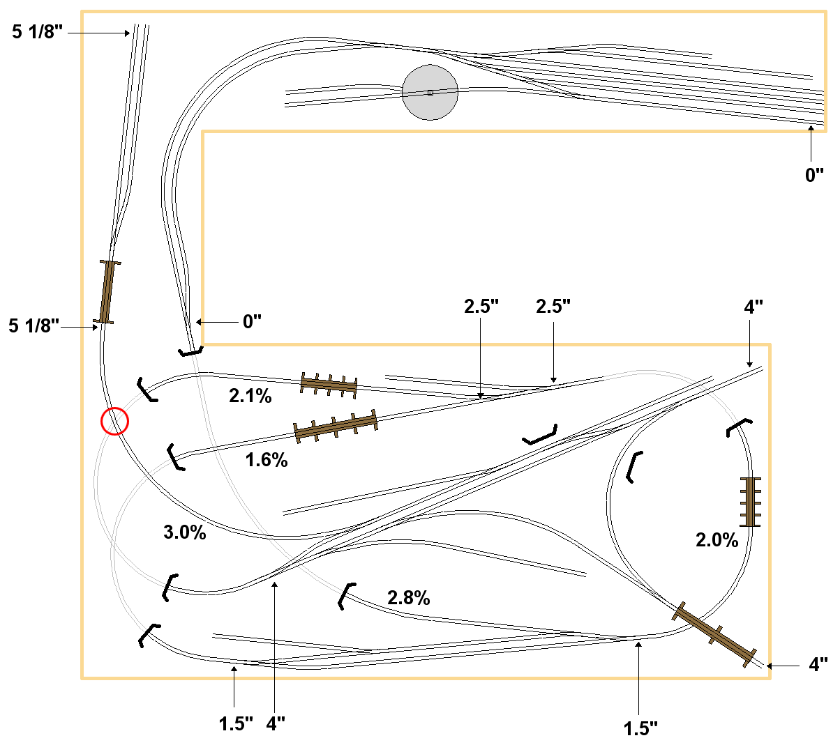

Ok Rob all makes sense now. Next question is what and where are grades. Also what are inches from base to e;evations in places?
#32
Hi Harry,
I worked out the grades, and elevations as follows:
  • The interchange yard is at your base elevation of 0".
  • There is a 2.8% grade up from the interchange yard to the mainline.
  • I kept the grades on the mainline loop as gentle as possible and only varied the elevation from 1-1/2" to 2-1/2" giving grades of 2.0% and 1.6%.
  • There is a 2.1% grade from the mainline up to the town with the wye, which is set at an elevation of 4".
  • The grade to the mine had to be steep at 3.0% to gain enough elevation to cross over the grade to the town which puts the coal mine at an elevation of 5 1/8".
  • I circled the only critical elevation in red, and from my estimates it should give you about 1-1/2" of clearance.
Take care,
Rob.

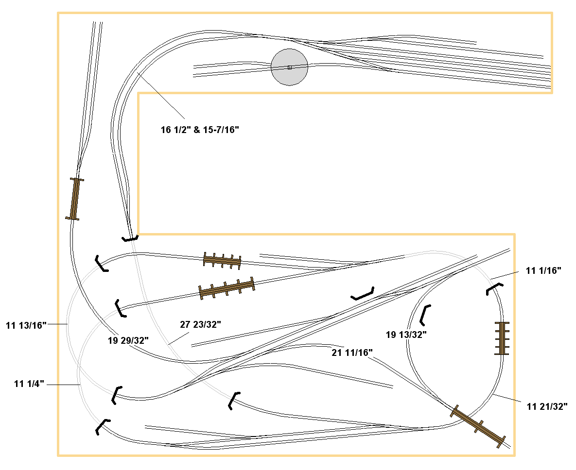

Hi Rob and no not the electric part of it. I ment as in 11 degree curve track 12 degree curve track flex tack if needed things like that.
#39
Hi Harry,
You threw me off when you said "what radios needed and where they need to be" ... I wasn't really sure why you were talking about radios. I will get the radius info to you in a bit.
Take care,
Rob.
#40
The radius info:

Ok Rob I take most of this is flex track laid?
#44
HI Harry,
Actually, all of it is flex track since I don't use sectional track for my designs.
Take care,
Rob.
#45
Ah that I was not aware of 219 That is one of my weaker points is radius with flex track 35
