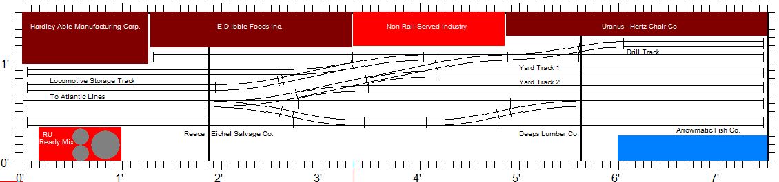

I finally bit the bullet and redid the track plan with Peco Code 75 track and medium radius turnouts. I used a 3 way turnout on the left side of the runaround. All of the turnouts will be Electrfrog. I think that it really makes a difference in space efficiency. By converting to Peco, I was able to shorten the length of the layout to 90x18 inches. this allows me to fold the layout into a 45x18 inch transportable unit. I'm toying with the idea of changing the industry in the upper left to a brewery.
