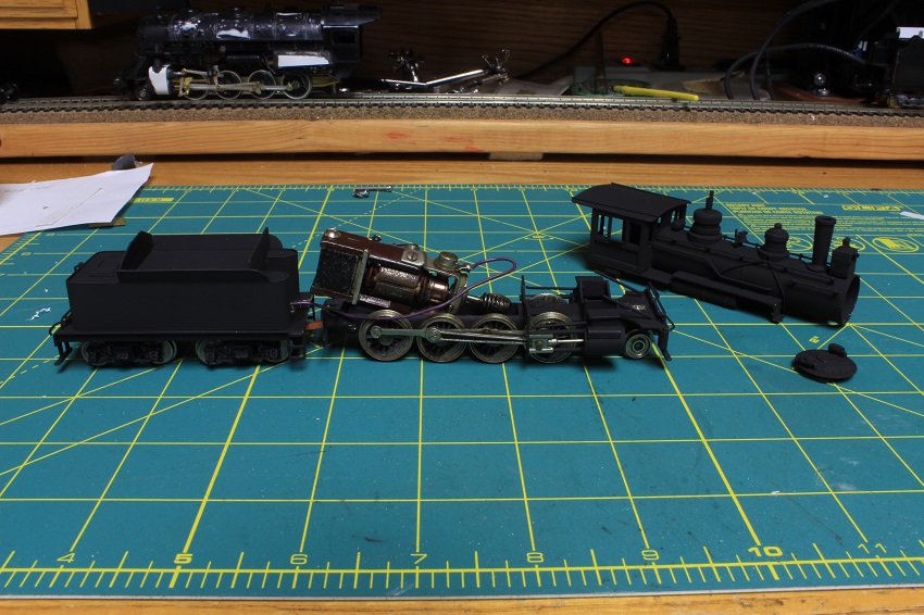

A project that I am working on for Toptrain. I don't know the age (or manufacture), but the factory coupler that was on it pre-dates the X2-f.

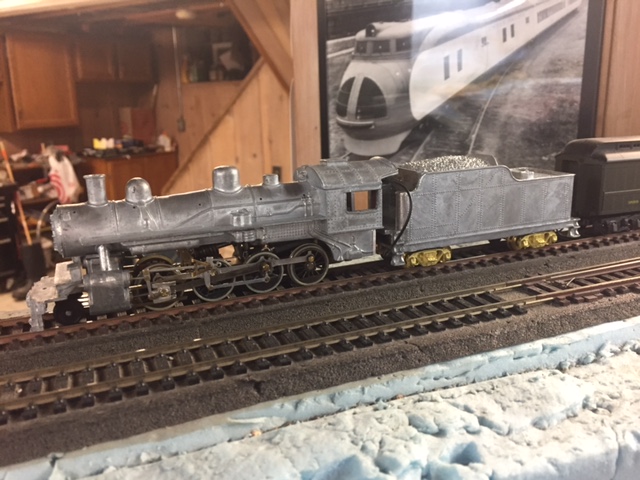

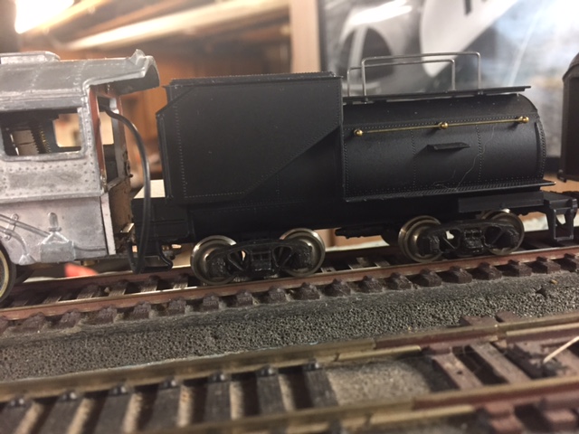

I made some progress on my Connie today. It seemed to be running very poorly, and the only way to get it to run was to bump the tender or put some weight on the tender. I decided to try a different tender, so I pulled out an old MDC Roundhouse Vanderbilt tender someone had given me because it was missing trucks. I had bought a set of Cal-Scale tender trucks from a friend along with a mess of detail parts for $10, so I screwed those to the bottom and hooked it up.
The loco ran great! No stalling, no stuttering, no slipping! It could easily pull twice as many cars, and could creep along! Hard to believe, but maybe the sprung Bowser trucks were the problem. I installed the Cal-Scale trucks on the Bowser tender, and once again, the loco runs great:
So now I'm thinking I should try these trucks on my E-6., and if they work, buy more. Cal-Scal/Bowser doesn't seem to have tender trucks anymore, though Sad

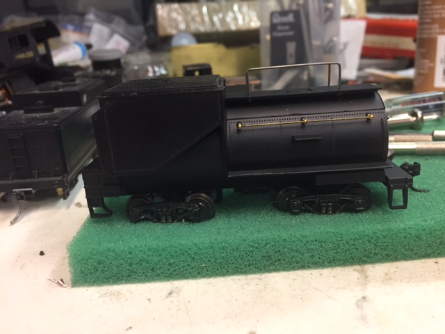

I put the Bowser trucks on the Vandy Tender and built it up, but I think I need to find some Tender trucks. Any suggestions?

I looked at Bachmann's parts site for tender trucks. They have the 2-8-0 tender trucks as an assembly. If I want the K4 trucks all the parts are available separately (truck body, wipers, wheelsets).
Mark, I think you are correct about the sprung Bowser trucks. I have a Boswer Casey Jones with rigid Andrews trucks, and it runs fine, so I'm going to try these brass trucks on my E-6. If it improves it, I will go on a hunt for new trucks. Are Kiesels the correct trucks for Pennsy Tenders? For some reason, I thought Dolphin trucks were correct.
Some Googling brought me to a few places that sell tender trucks:
http://greenwayproducts.com/greenway-pro...d-drivers/
http://bethlehemcarworks.com/Products/Ki...tml#Trucks
I'm interested in the Symington-Gould Tender trucks from Bethlehem, (#1212), but I have no idea if they will work as power pickup for Bowser tenders, so I sent them an email. The Greenway brass trucks look very nice, but the prices are giving me pause, and no one seems to sell Kiesels....

Thanks Mark. There are some SPF on other forums, so I can ask there, but what you say makes a lot of sense. The E-6 trucks look like Kiesel trucks:
The Bowser trucks from this kit were stripped off a different Bowser Tender, which may have come from an H-9 kit. They do have a brass pickup strip, and they work about as well as the brass Cal-Scale trucks. It stalls on turnouts no matter the trucks. My K-4 kit has similar trucks.
I tried yet another set of trucks on my Vandy tender, this set from an old New One/Aristocraft 2-8-2. The other trucks have 33" wheelsets, and these seem to be 36", but after cleaning they pickup fine and my Connie ran well, though the tender looks like it's on stilts:

e-paw Wrote:A project that I am working on for Toptrain. I don't know the age (or manufacture), but the factory coupler that was on it pre-dates the X2-f.
[ATTACHMENT NOT FOUND]
Hi steve
That is A Ma and PA old time 2-8-0 made by Akane. I located it in a 1962 catalog on HOseeker.

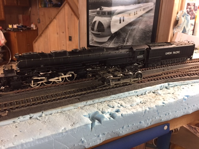

I was running my Big Boy the other day, and it was running badly. It got to the point where it would only move forward about a foot, then reverse a foot. I thought maybe the motor was stuck, so I took it apart, but the motor was fine--the front set of drivers was grinding badly. The gears looked bad, but rather than try to change the gearbox, I took a front driver assembly off this junked one:
[Image: file.php?id=33667]
Installed:
Whoever had it, though, painted the driver tires and rods white, and the drivers black, and they laid it on thick. I'd like to remove it, but alcohol doesn't seem to touch it. would Lacquer thinner work if it's enamel?
My cat likes to sit in my lap while I work, but few days ago I found her on the layout and shooed her off. She left some cat hair behind that I cleaned up (or so I thought), but I ran my Big Boy and it got stuck again. "I just fixed this," I thought, "how can it be jammed again?" Then I saw the cat hair wrapped around the cranks.... Eek half hour with the exacto and it's running smooth again...
