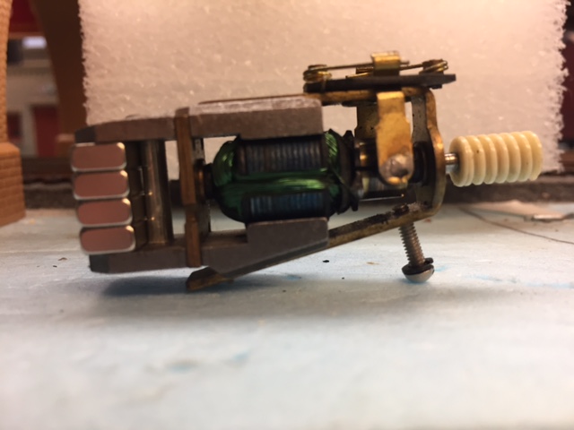

I've also been stripping the paint from this old favorite:
I replaced the old magnet with supermagnets and lubed the motor:
I'm thinking of installing a small decoder in the cab and trying a keep alive.
