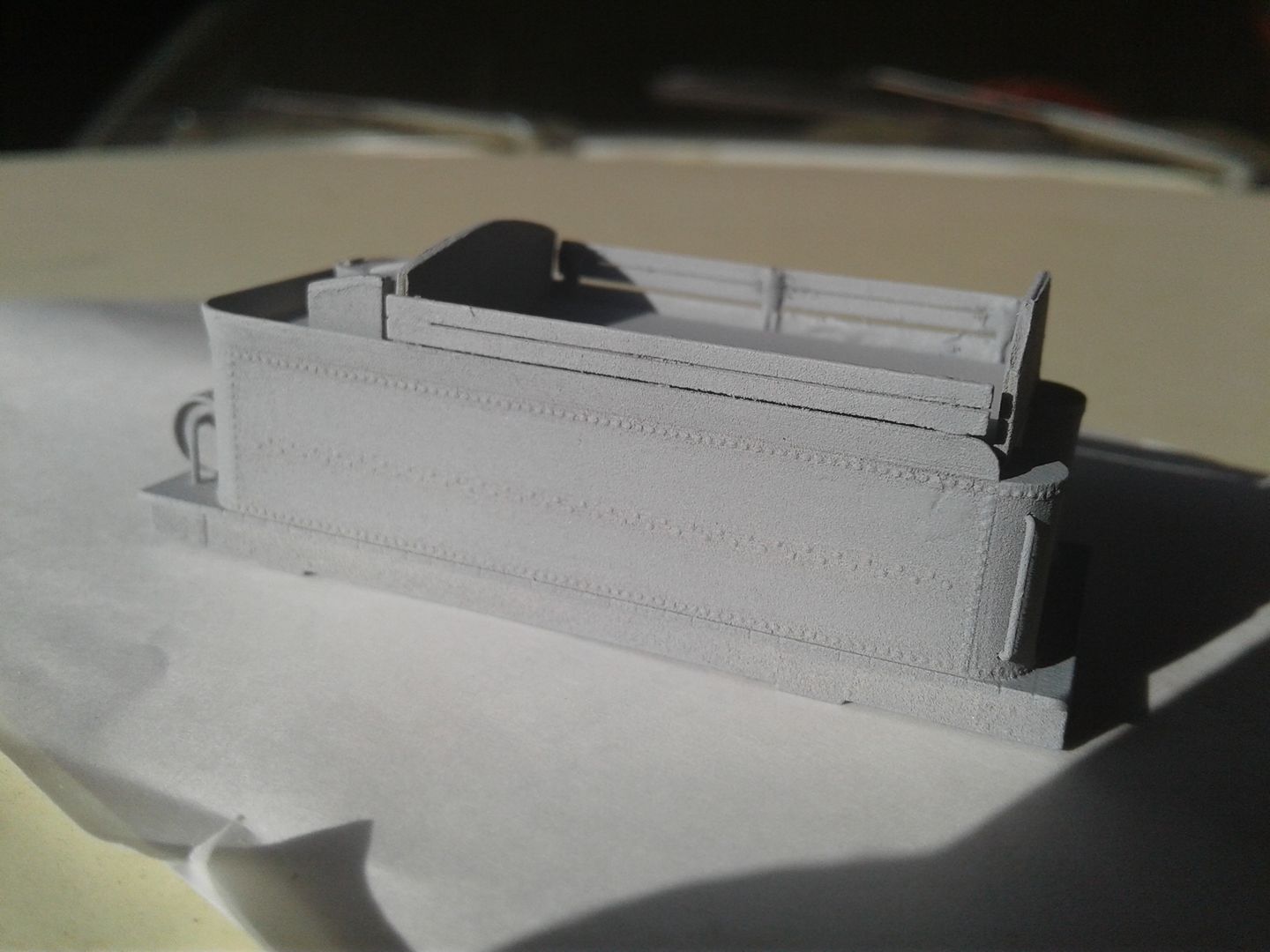

Here is the complete tender - this printed all as one piece! I added some wire details and gray rattle can primer. Not bad?
