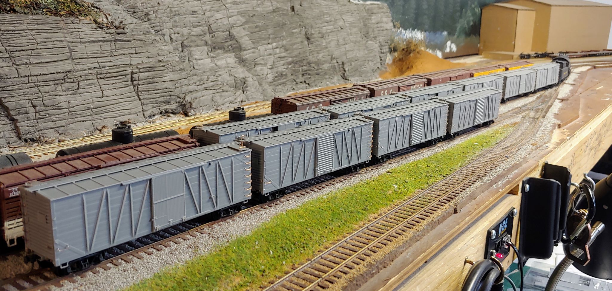

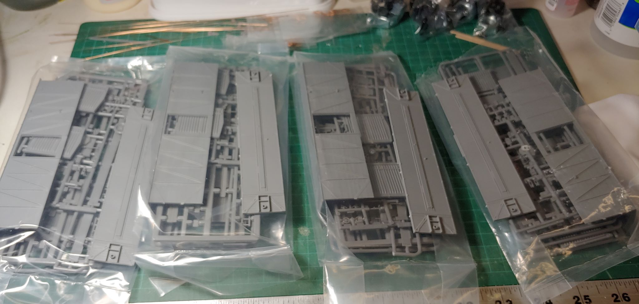

I also just finished building some Tichy USRA boxcars I built from a Bulk 6 pack I picked up years ago.  I still have another 8 cars to build which I ordered 7-8 Murphy ends and AB Brakes for so that they look closer to CPR USRA clones.  So when those bits arrive I'll get started on them.  That said, I was very pleased to get the initial six out of the way and built them as is with the 5-5-5 ends and k-brakes.  I still plan to paint and number them as CPR boxcars.  I filmed a celebratory roll-by video of the undecorated boxcars before I remove them from the layout to get them primed, painted and put the decals on.

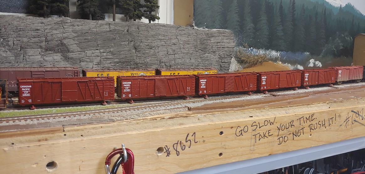

Another update.  I finished building ten of the Tichy Box Cars I have.  Four more on the bench with six more still in the box.  Yep...20 in total.

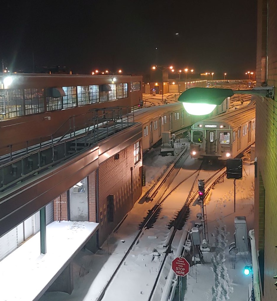

I also attached a pic I took a couple weeks ago before starting work in the morning.  Trains come out of Greenwood yard for the (roughly) 5:45 am weekday start.  I drive a train...a subway train.

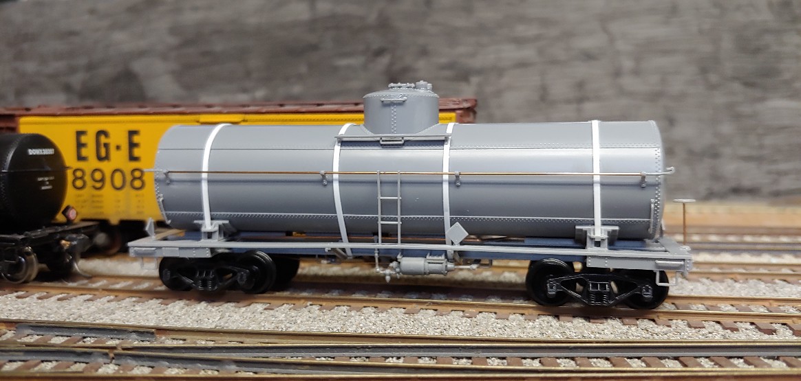

I completed one of six Tichy 10000 gal. tank cars I have a week or so ago.  To be honest these felt easier to build then the USRA cars.  Maybe because I didn't have to drill dozens and dozens of #79 holes for the brass grabs.

Interesting side note.  The Tichy trucks and wheels are made of Delrin plastic. A real pain to get acrylic paints to stick to.  So after some research I found a clear primer for automotive plastics that will help my colour coat stick to the trucks when I airbrush them.  It's called Dupli-Color Adhesion Promoter.  I found mine at a Napa here in Toronto.  That said, States side Napa sells their own house brand that called a Polyurethane Primer.  Similar stuff apparently.  I'll also let you folks know how it works out.

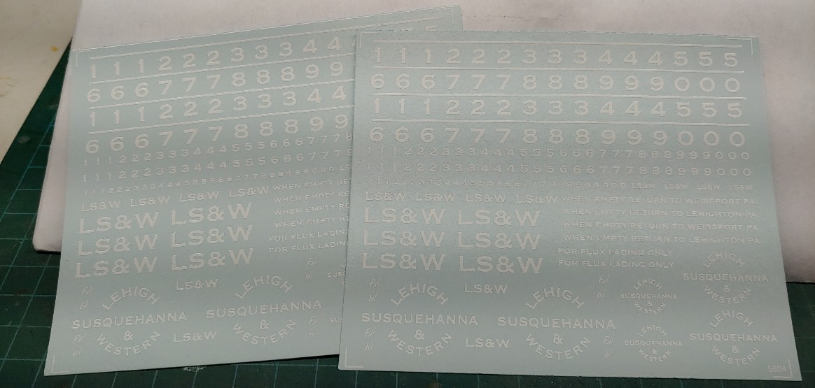

Look what I found the other day....I'll be putting these to good use in the weeks ahead and looking forward to it.  I have three sets and plan on doing three of the USRA boxcars with them.

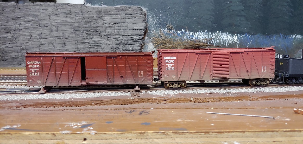

Here's what I accomplished tonight.  I haven't applied dulcoat to the model on the left yet...however this is pretty much where I'm headed.  I used a brown/black acrylic wash that was brushed on.  I then used some Mig Ammo streaking effects which I brushed on and then after a while rubbed with some cotton swabs in a vertical fashion.  The effects are very subtle...which is all I want.  I then made a road spray out of some thinned brown and light grey acrylics which I simply sprayed along the bottom with my airbrush.  To my eye the boxcar is a big improvement over the first one I did. My hope is each model shows some progression and my techniques become better or more refined...stay tuned for further updates.
