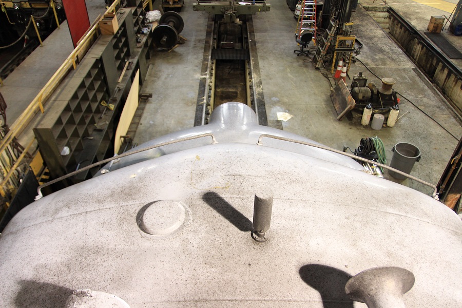

Afternoon gents.. At the request of Dr. Wayne I have done some research on F unit grab irons for a friend of his that needed some info for a modeling project.  I measured the diameter  of the grabs and found that they are all 1 1/8 inch except,,, for the long ones going into the cab, and the ones that are located at the rear ladders that lead into the engine room ( I'll get to that latter). I took a few pics to clarify this, but I will focus on the standard EMD grabs as each railroad added and removed as they felt necessary. I tried to get the pics to show the locations and size of the grabs. If you have any questions just ask and I'll do my best to answer them.

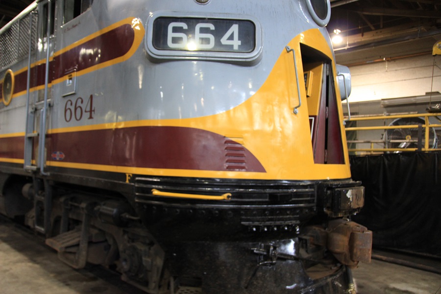

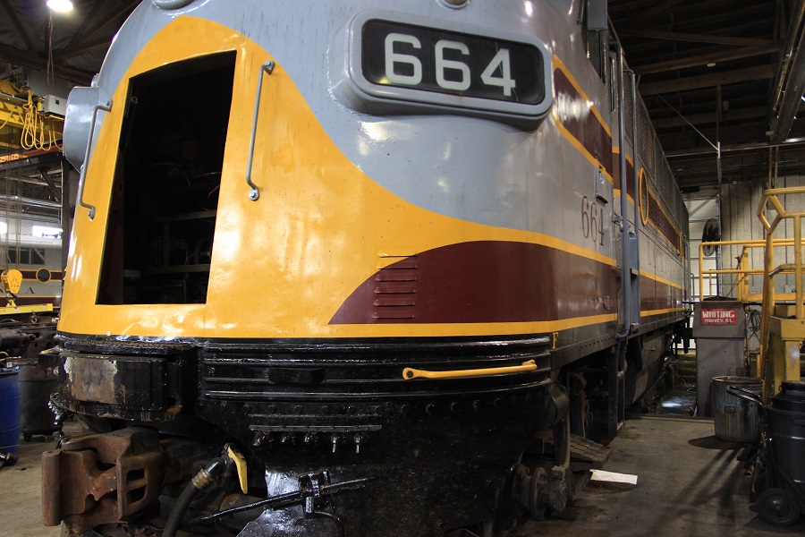

First the nose..... Here 664 does the honors, these are the stock locations for EMD's. One on either side of the nose door, and one on the anti climber on either side of the unit.

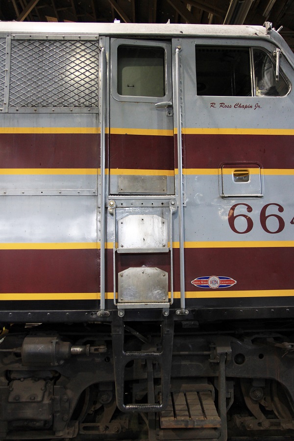

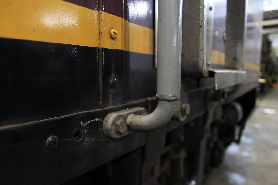

Now for the front ladders. These have a diameter 1 1/8 inch at the ends where they attach to the unit and a larger section measuring 1 1/2 inch for the long vertical section. I have shown the welded joint where they meet here.

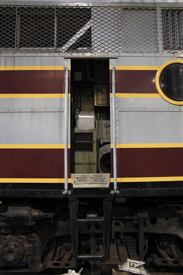

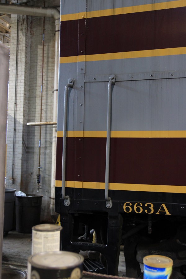

Now for the rear ladders.. I walked over to 663 for this one. They have the same measurements as the front ladders of 1 1/8 and 1 1/2 inch.

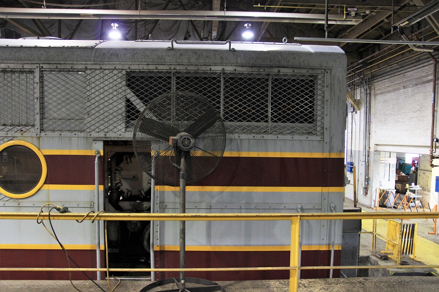

Now back to 664,, this grab is only found on boiler equipped units, and only found on the fireman's side. We believe it was to hook a ladder onto to gain access to the roof for servicing the boiler hatch. It's located on the roof line just past the rear engine room door.
 And a close up of the same grab.

Now onto the roof....Here are the eyebrow grabs over each window.

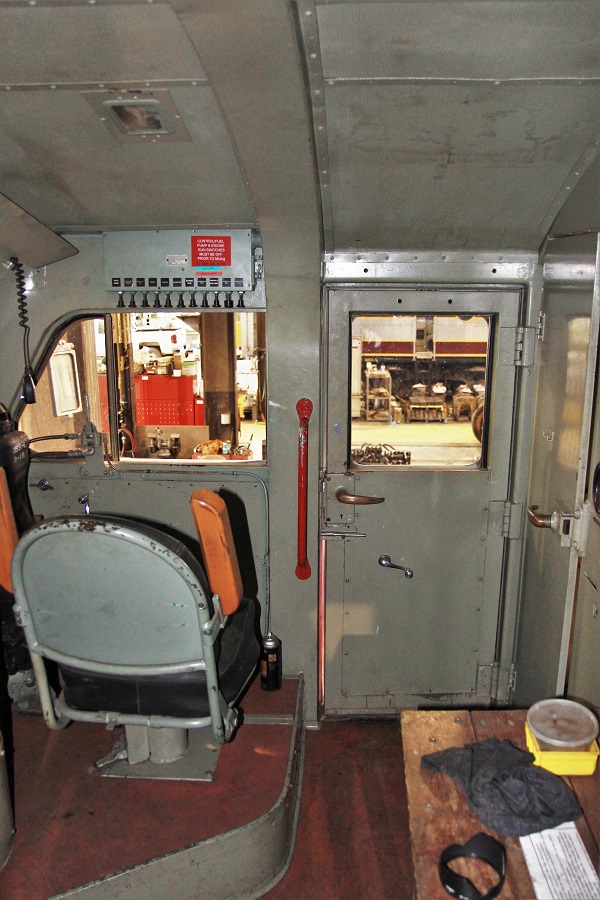

If you are doing a cab interior you can also do the two grabs near the doors..Once again same 1 1/8 as all the others.

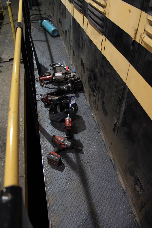

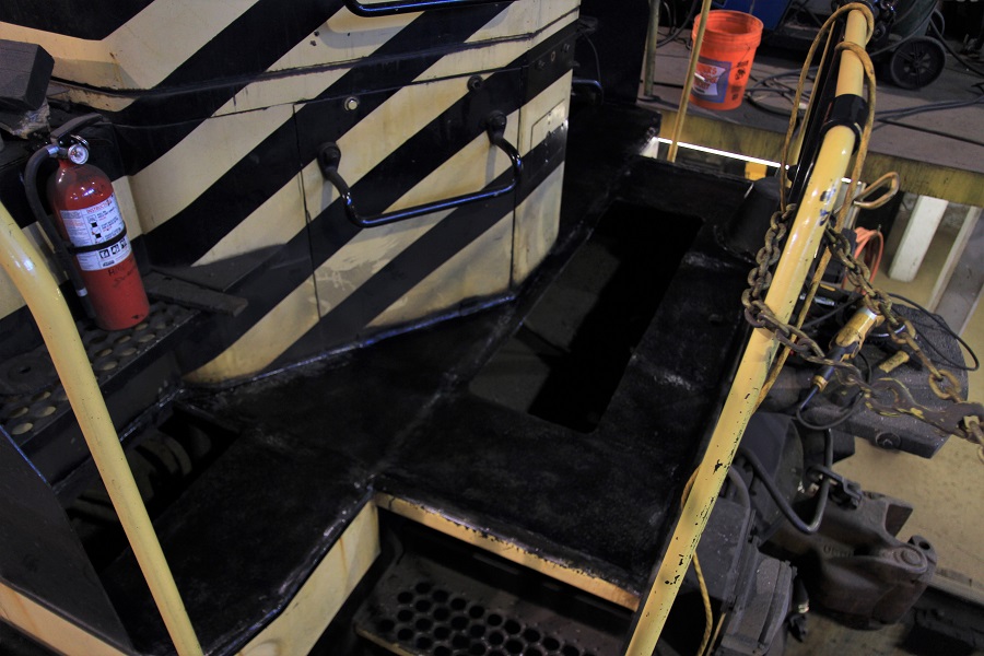

The walkway project is complete in 664's engine room , except for the decorative plates with the EMD/EMC logo on them.  Those will be added when we receive them from the fabricator. The same welding contractor is now replacing the walkways on the 514, This should be finished in the next few days. The fireman's side is complete as seen here.
The section in this pic is of the short hoods walkway after the old plates were removed. They have since been replaced with new steel at the time of this post.

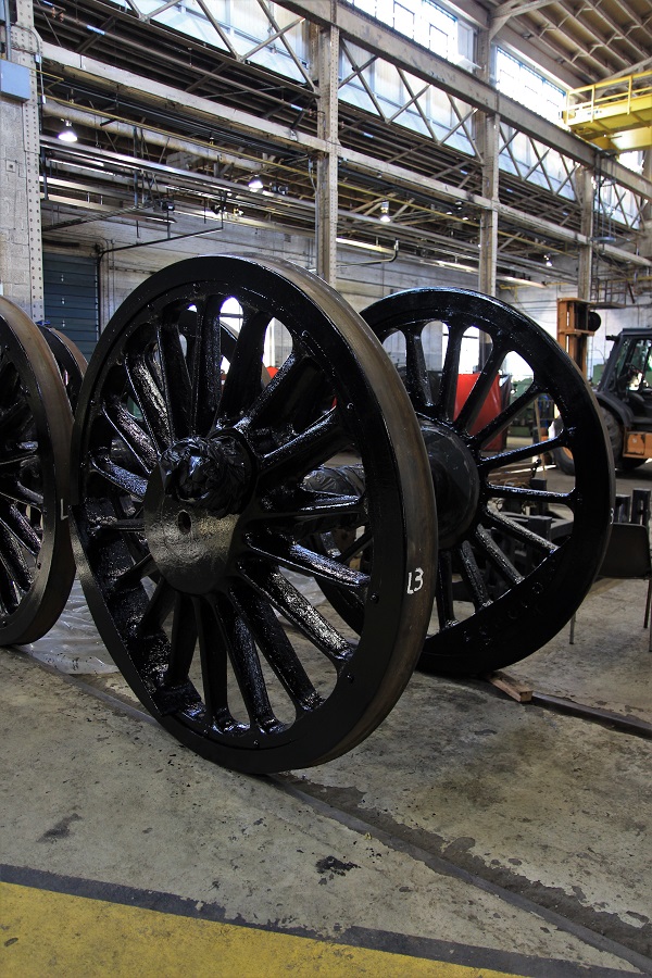

On the steam side,,, the drivers for the B&M Pacific have been inspected, turned, re-quartered, and primed. Just after I took this pic they started to receive a coat of black paint.
The Baldwin 0-6-0 is also getting some side rod work done in preparation for the operating season.
B&M drivers are painted.
