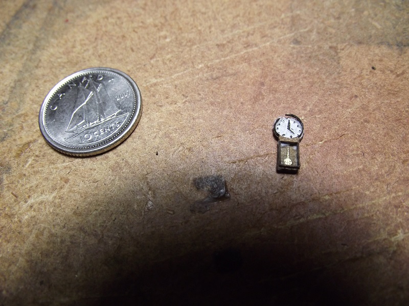

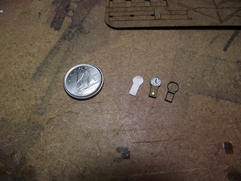

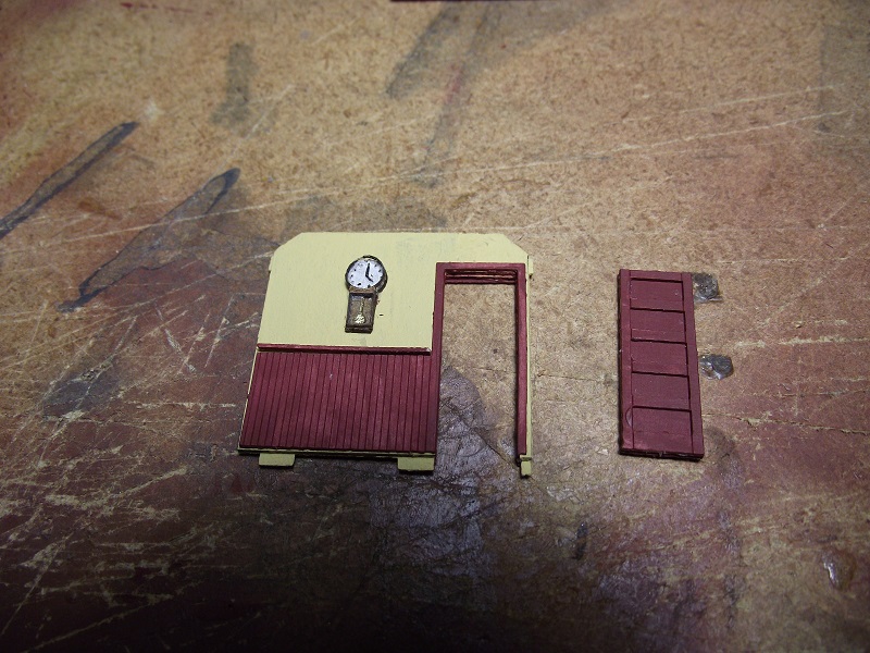

I made some good progress on the model today, starting with one of the interior walls. but first I had to build one of the little gems in the kit, the regulator clock:
The clock is made of three parts. I painted the clock face and the pendulum, then I used a micron pen to paint the dial features.
Then I glued them together and used a brown sharpie to touch up the sides.

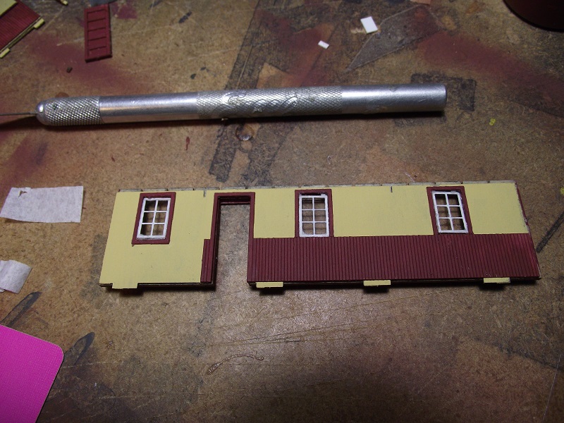

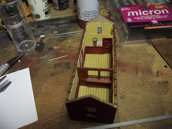

The wall went together by layering a number of wall components together so you get the wainscoting and chair rub bar, as well as the door frame attached to the wall. This is the interior wall that separates the waiting room from the stationmaster's quarters.

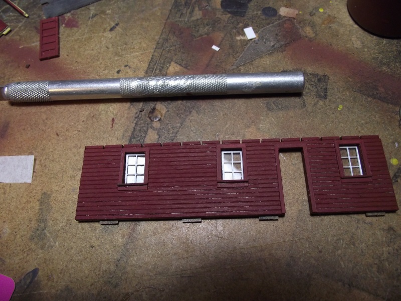

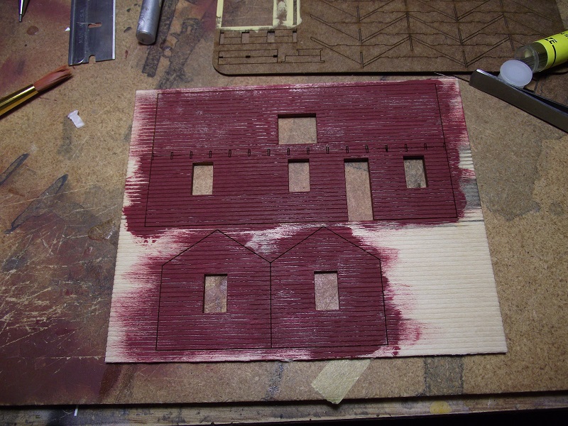

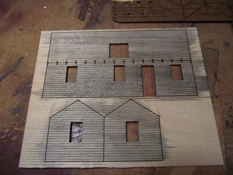

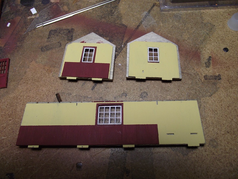

Before I can go any further, I decided to paint the exterior walls. I started with staining the basswood walls with some A&I as a base.
Then I painted the Barn Red over top. I didn't paint completely over, but used a semi dry-brush technique to show the weathered wood underneath. I did paint the front a bit more through though, since that would be the most noticeable to railway customers.
I also painted the window frames and exterior door frames since I'll be assembling them next.

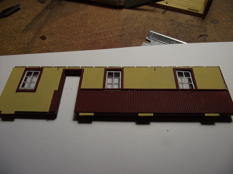

Thanks everyone. I completed the front wall this evening.
It took an evening or two to build the front wall. There is quite a bit of layering to achieve the right look, especially in the interior:

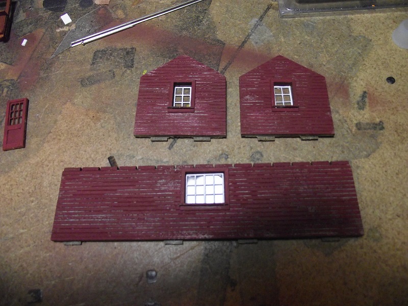

I finished off all the walls this weekend.
Since there is an interior, the building process takes a bit more time, but the end result will be worth it.
I still have to add the chair rail above the wainscoting but other than that the walls are almost ready to be assembled.

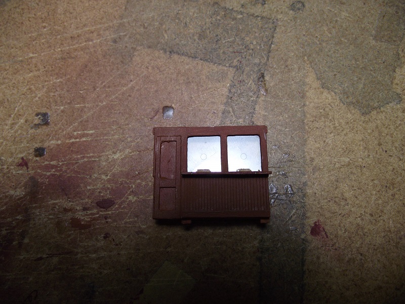

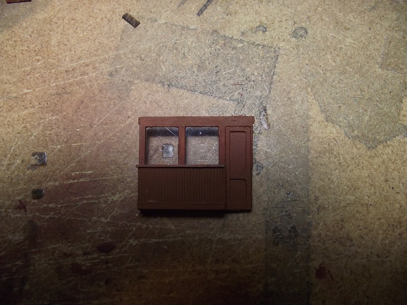

I also built the interior ticket wicket wall:
It's made of a number of parts, again layered on top of each other to make the 3 dimensional result. I decided to paint this wall with burnt sienna for a bit of contrast in the interior.
The window is a laser cut piece complete with speaking holes and a ticket slot in the bottom.

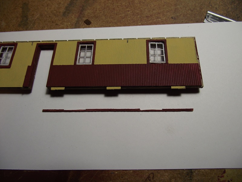

The back and side walls are glued in place, the ticket wall was temporarily set in so I could square up the rear wall. I had to trim the chair rail around the ticket wall, something that has to be done with the front wall as well. The floor is a piece of laser-cut basswood that I stained with Flo-stain pine.
There were a number of things to do before installing the front wall. The first was to add the chair rail that had to be trimmed to fit around the window frames.

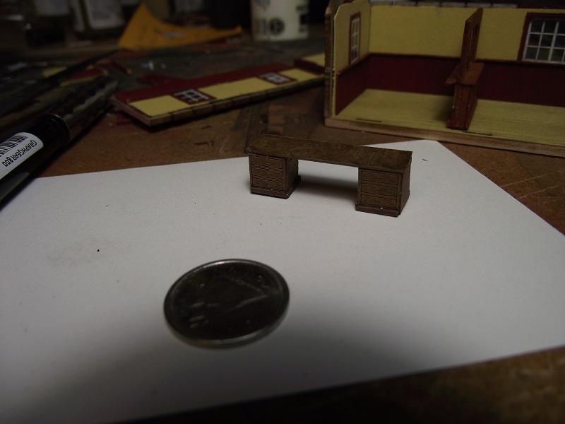

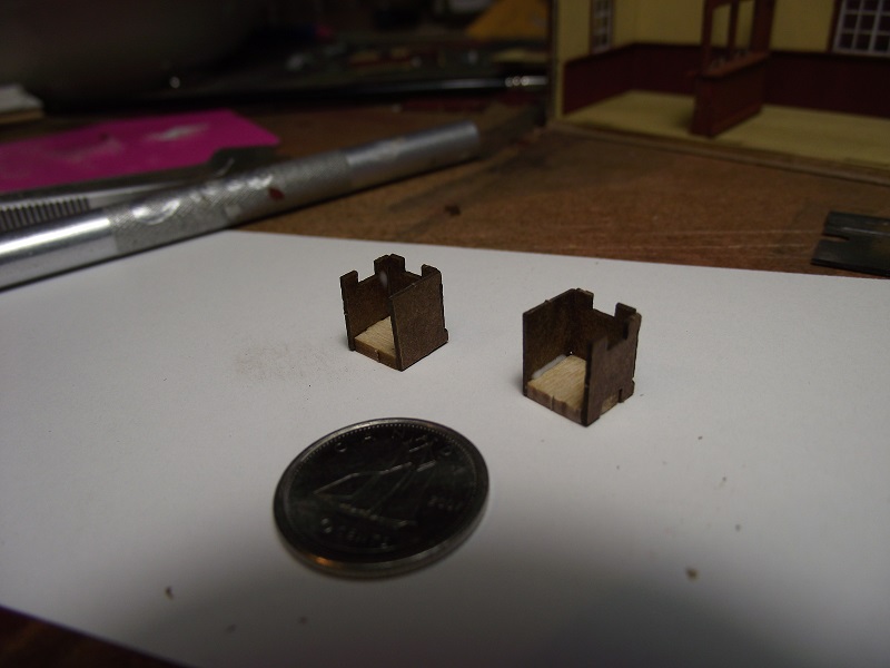

Then the desk had to be built and installed, starting with the two pedestals
Again that's a dime for scale.
And the finished desk. There are 17 parts to the desk, and it still needs the chair. The desk is the same width as the station interior so it has to be added before the front wall goes in, otherwise it wonts clear the chair rails around the walls.

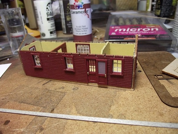

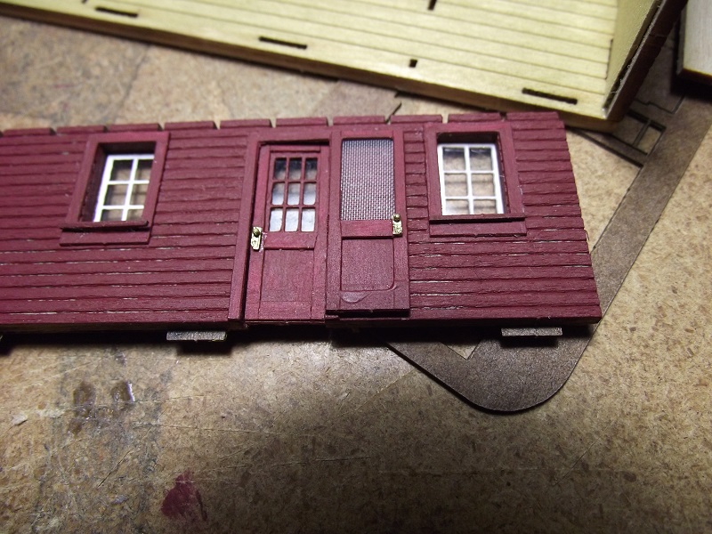

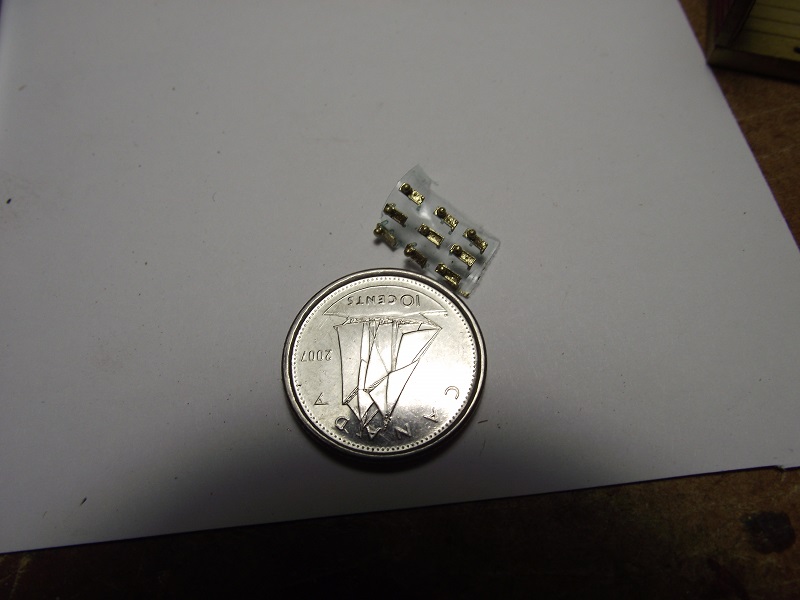

Then I turned my attention to the doors and the door knobs. The door knobs are 3-d printed parts and extremely fragile. I painted them brass while still on the carry sheet and then removed them.
I glued the doors on and then the door knobs. I really like how the screen door looks.

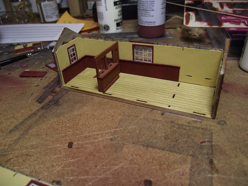

I added the front wall but first glued in the desk and the two interior walls.
And finally, the front wall.
Next is the interior furniture and fittings.

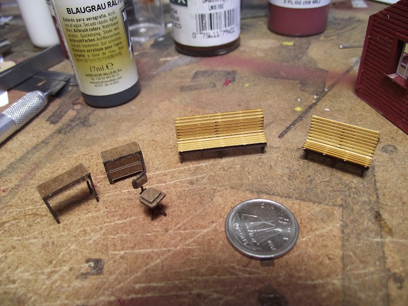

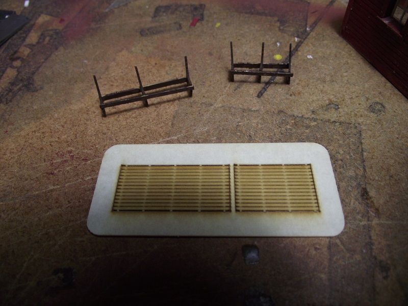

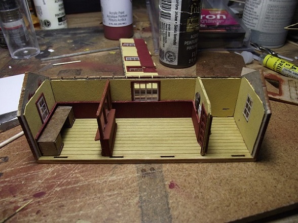

I got quite a bit more done today, starting with the furniture:
Included is a desk chair, a dresser, bedside table, and two benches. They all take a steady hand, tweezers and patience to assemble.
The two benches are easier to assemble that they might seem. The 'slats' are actually one piece that are laser engraved and cut to look like individual pieces. The lay onto the framework and bend easily around the seat and back of the bench.

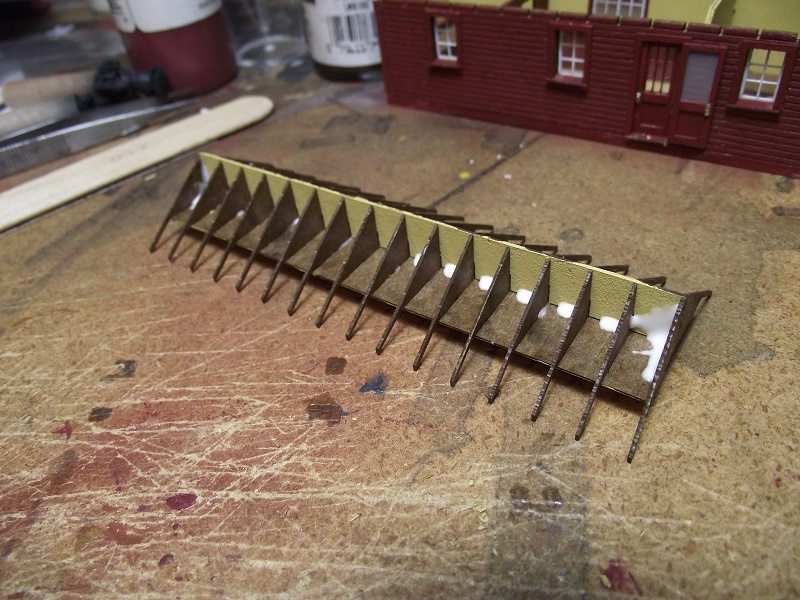

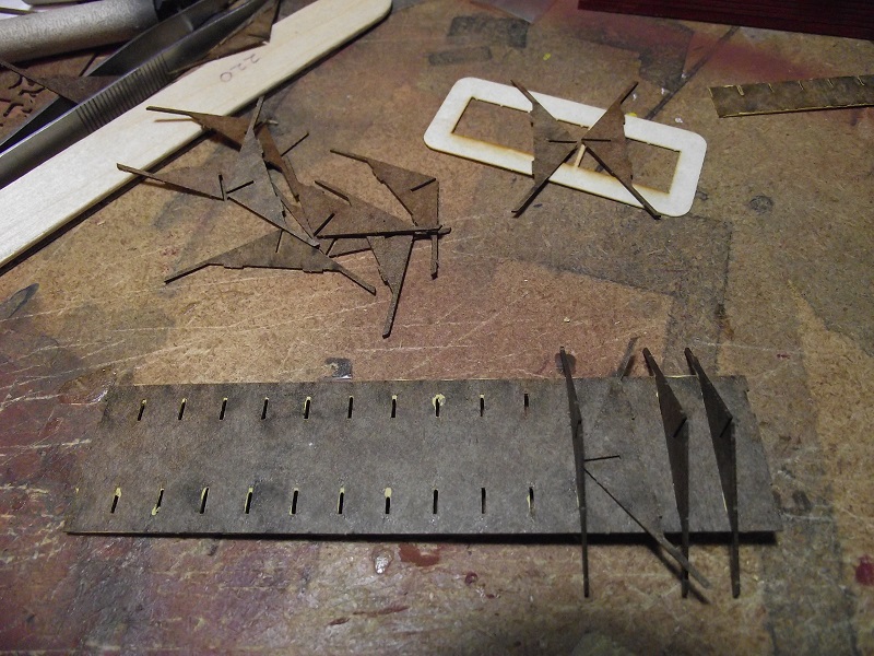

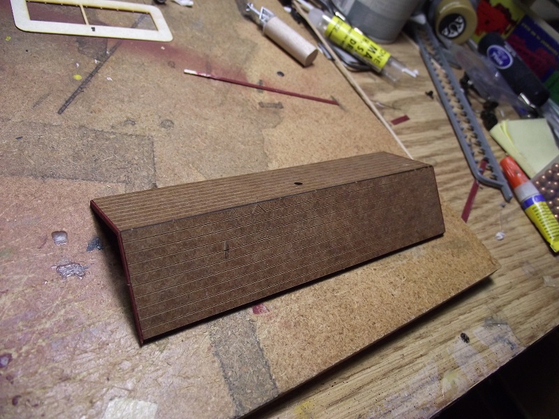

I also started on the roof, assembling all the rafters into the ceiling plate.
After that I glued the ridge panel in. The roof is built very sturdy because it's designed to be removed so you will be able to see the interior when it's done.

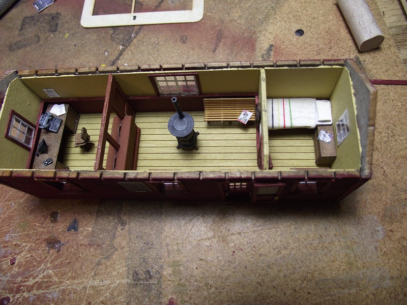

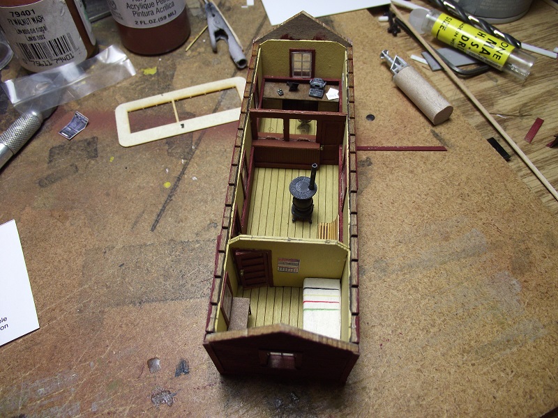

I've almost completed the station in the past week, starting with the interior:
I painted and added the 3-d printed stove, typewriter and telegraph equipment. The telegraph parts were very fragile and I broke them a bit but it's not very noticeable. I also installed the furniture and bed in the bedroom. The mattress for the bed comes as a laser-cut wood part. I made the blanket using some double-ply tissue and glued it to the mattress. I then painting it with an off-white and airbrushed the stripes to make it into a Hudson's Bay Blanket. (What could be more Canadian than that?)
I then used some photo-reduced copies of magazines and papers to populate the waiting room and office space. I'll probably add some figures in later.

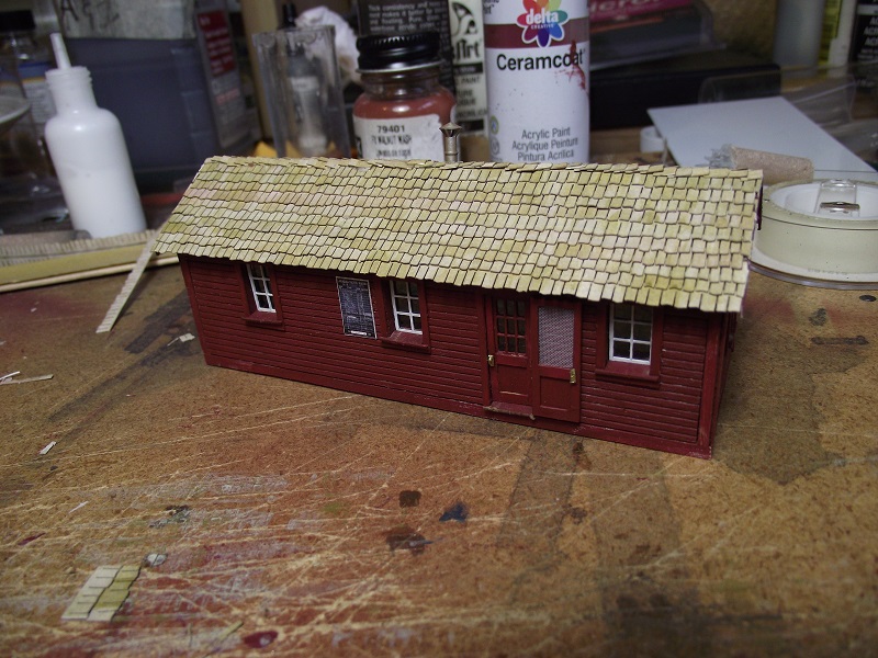

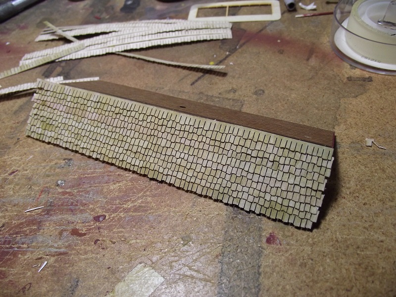

I also finished off the roof. I sheeted the top and added the fascia boards to the ends

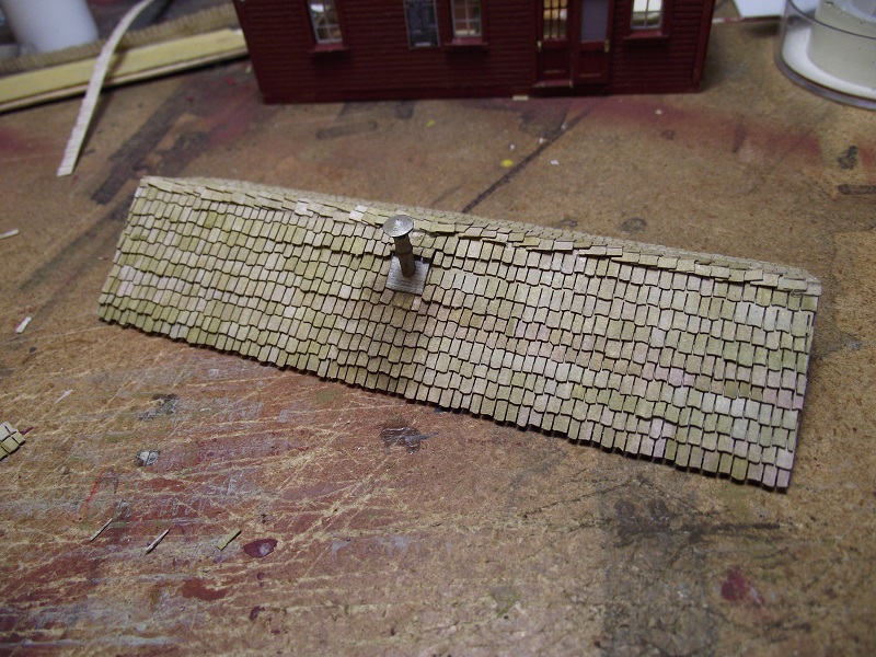

Then I added the shingles. I used Scotch double-sided tape to stick them down.
It takes a bit of finesse to get the shingles around the chimney, but they look pretty good when completed. I used some weathering powder around the chimney.
And then I installed the roof. The roof is designed to be removable so it's a friction fit with the rafters fitting into the slots on the top of the walls. I did have to trim some of the slots to get a proper fit but it went together fairly easy. It was at this time that the instructions tell you to add the kit's LED lighting but I have a different plan so I'll do that later when some parts show up.

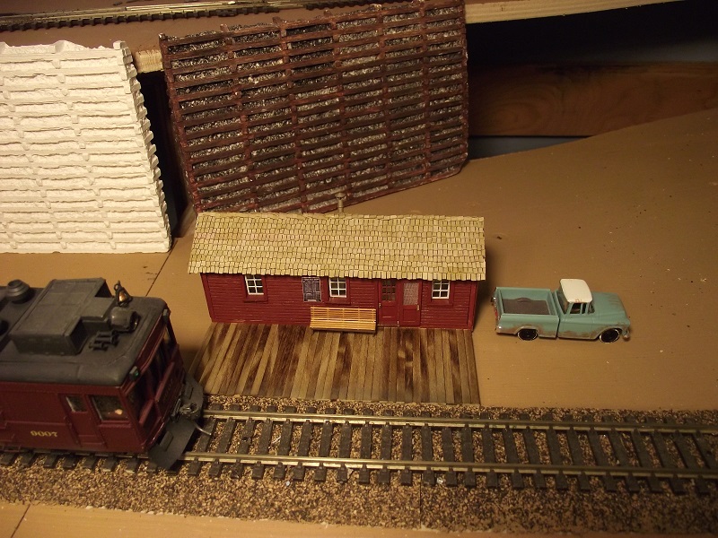

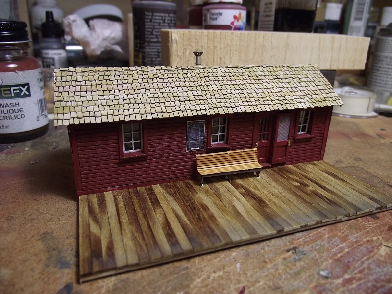

I pretty much finished off the project. All I needed to do was to build the front platform.

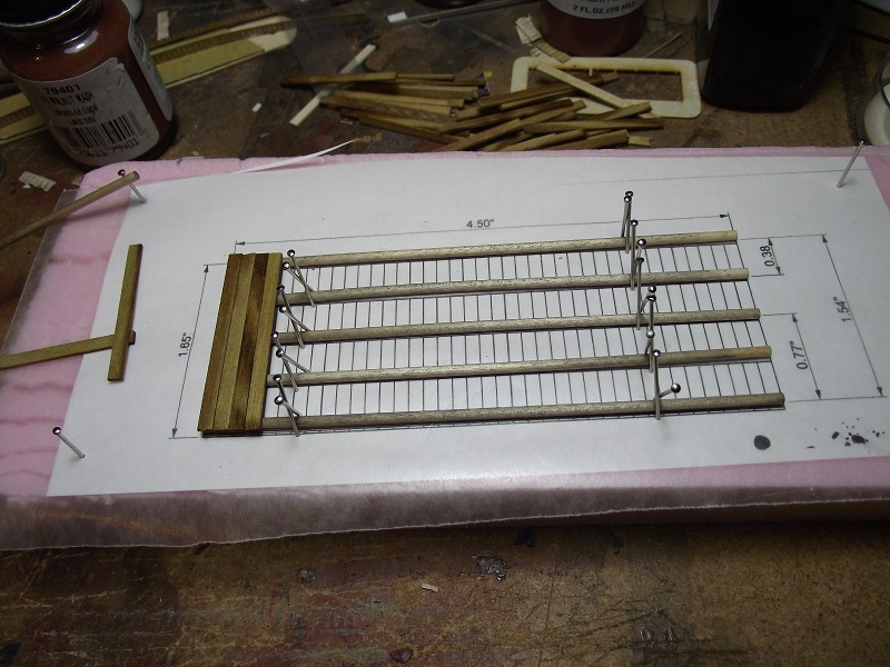

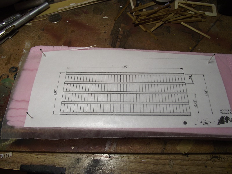

The kit comes with some stripwood and a template for it. I pinned it to a small piece of foam with some wax paper over it.
Then I pinned and assembled the platform on top of it. I stained the wood with Micro-Mark's Brown weather-it stain.
and then it was done.

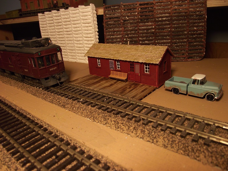

I placed it on the layout where it will eventually go. I haven't done any real scenery in this area yet but you get the idea. I am thinking of shortening the width of the platform to 2/3 of it's size as it seems a bit wide for the area I've chosen.
