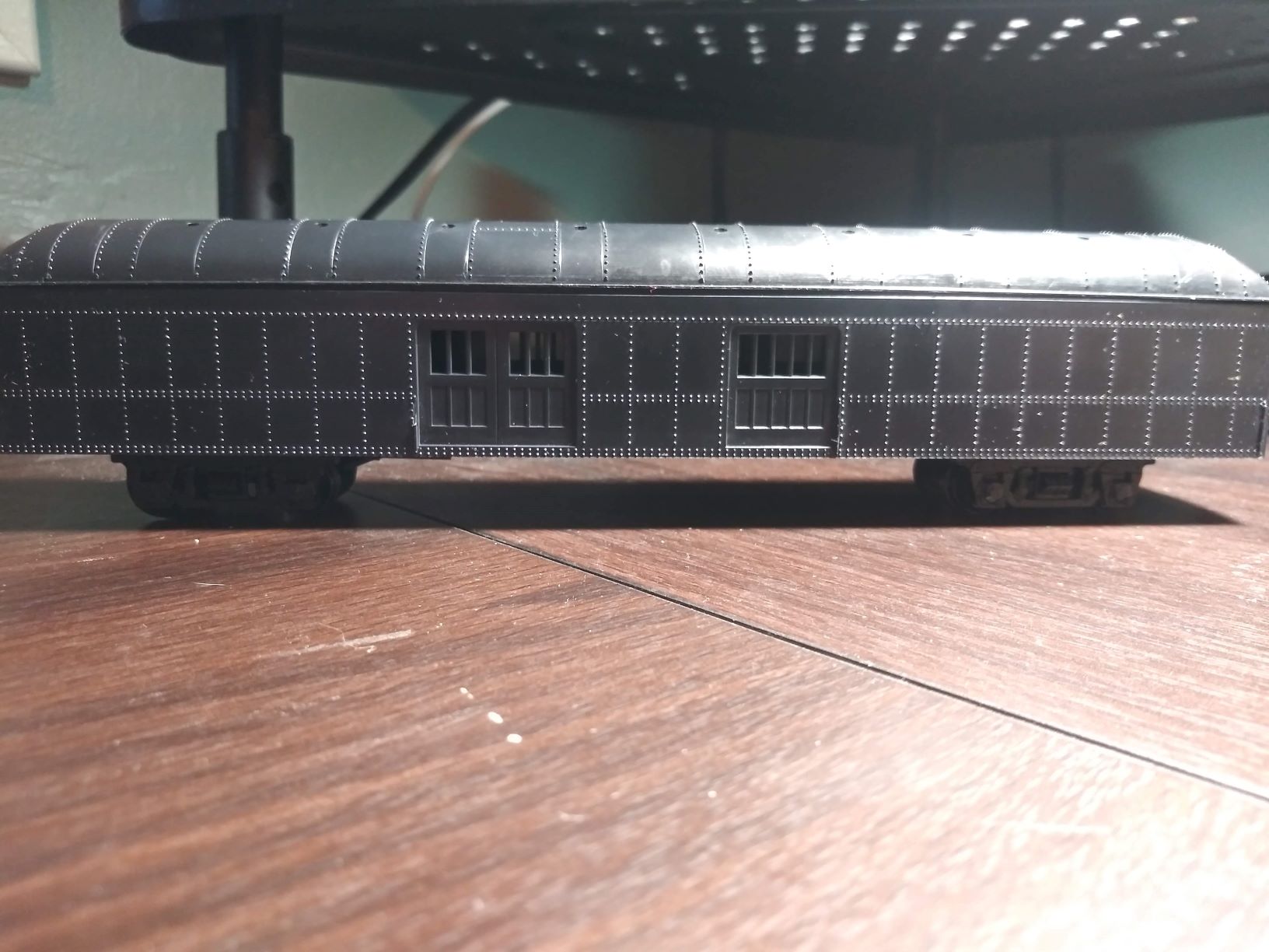

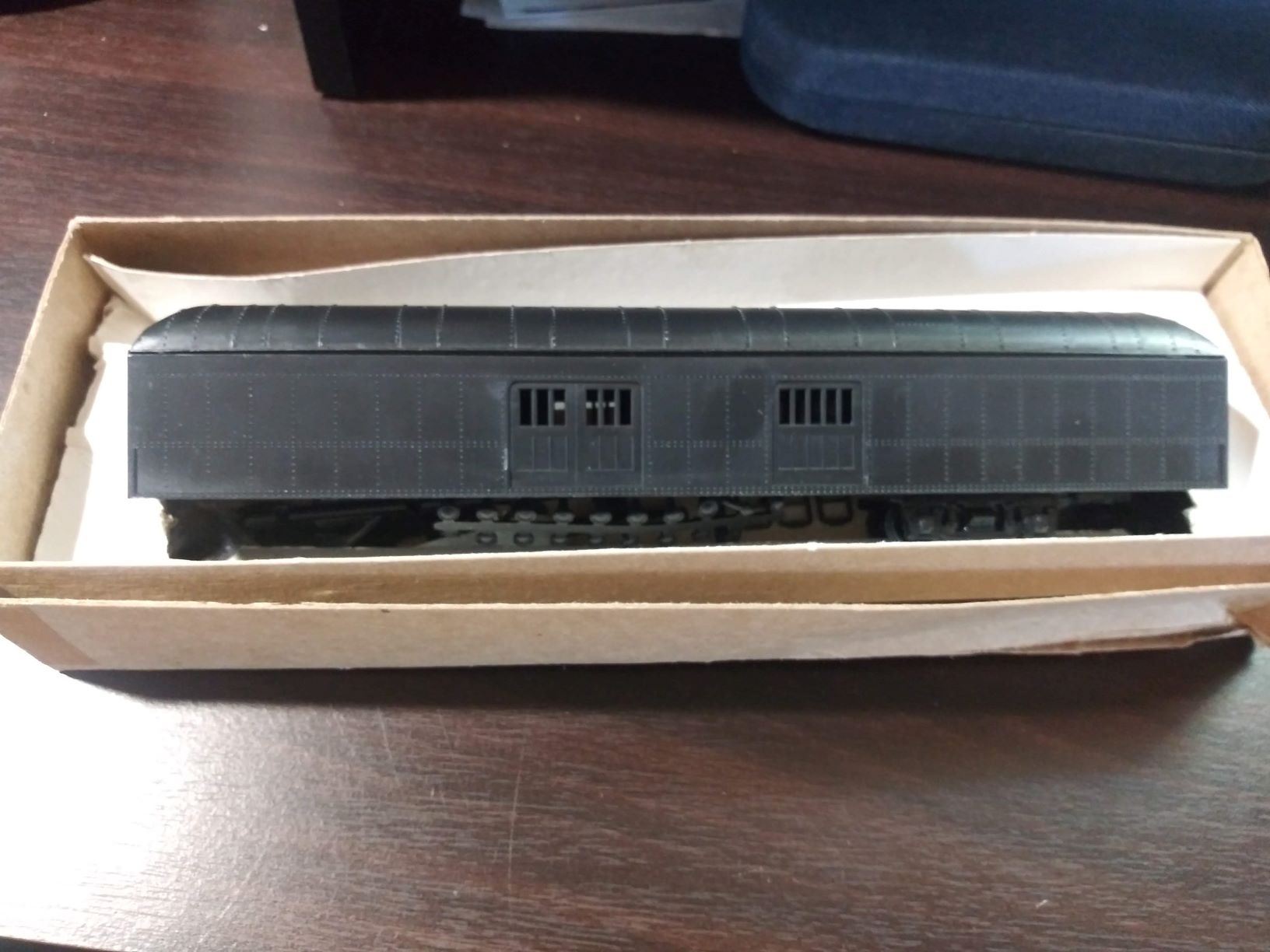

Well, here is the car.  Bought used off EBAY for a decent price.  The kit is missing a truck screw and a coupler box screw.  Neither will be an issue.  I think the tooling for these cars dates to the 1970s - and there are issues.  I've learned that these kits have incorrect trucks per prototype.  Also, the baggage car shares the same truck spacing with the coach and other cars, and thus has the truck bolsters too far from the ends because the baggage car does not have vestibules.  I am fine not correcting those issues, as I have far too many other things to do besides cutting and gluing.
I also noticed that the two sides of the car are identical.  Not sure if this is prototypical or not.  I would think both long doors would be on one end of the car and both short on the other.  But the way it is, each end has one long and one short door.  If this is an error, it is definitely not fixable.
I will probably start with the roof, putting the roof vents in.  Not sure how many roof vents a baggage car needs, but I will probably just build it per the instructions and it will look fine.

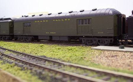

It's actually not too much work to move the trucks closer to the car's ends.  All that's required is new bolsters of a thickness similar to the ones on the underframe...it could be a full-width one, or simply a built-up square (or strip) of styrene.  Drill holes for the screws, and, in most cases, simply install the trucks...the screws will generally cut their own threads in the plastic.

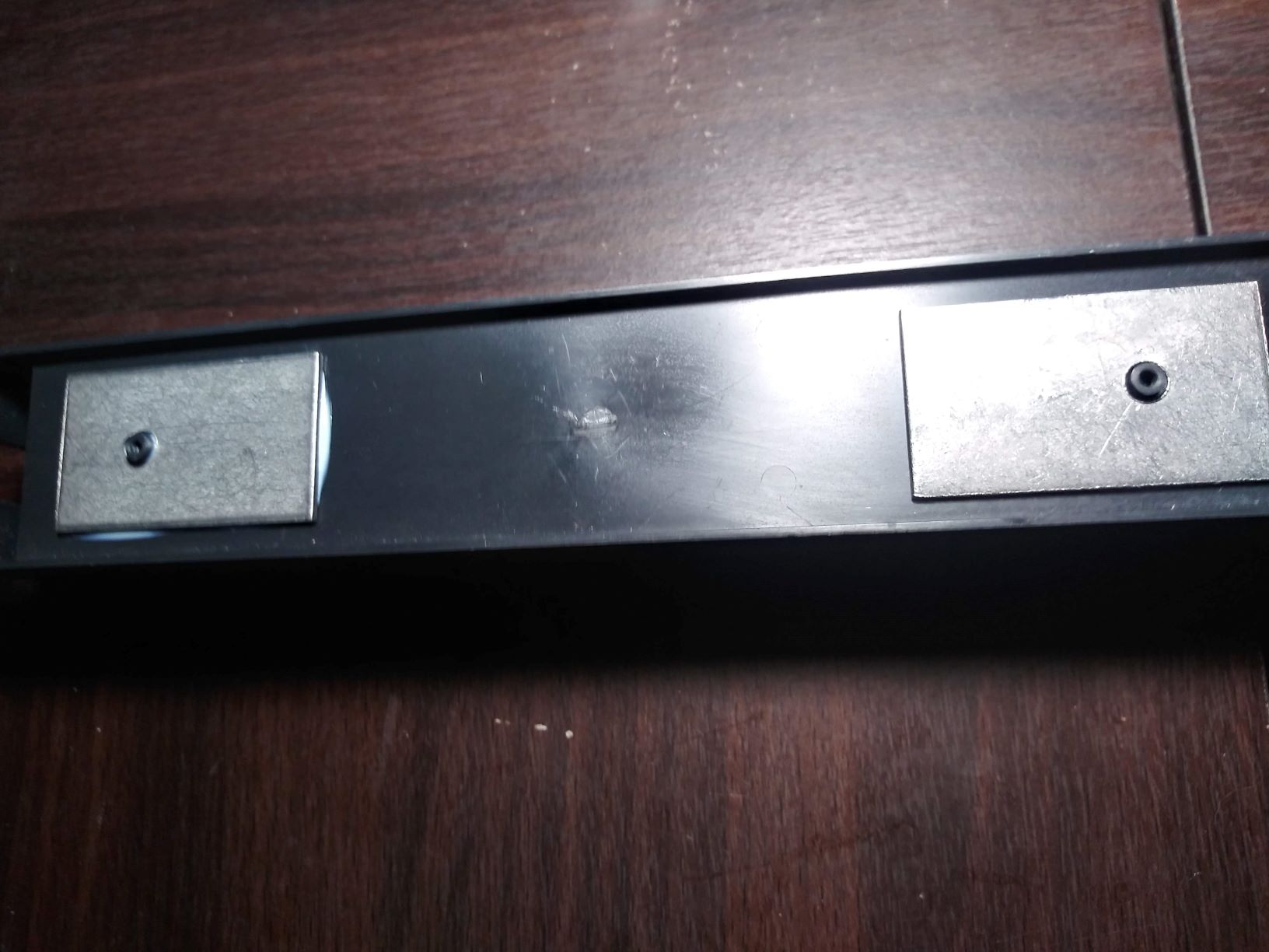

The first step was to glue the weights in.  I chose canopy glue, and it seemed to hold and is flexible enough  .  I used CA for another car years ago, and the glue eventually broke free and the weights now rattle.  Probably could have used a contact cement, but sometimes I have had issues with that distorting plastic.
After that, I screwed on the floor and trucks.  The floor was a warped so I used plastic cement to glue it in a few places - just enough to secure it.
Looks good so far.

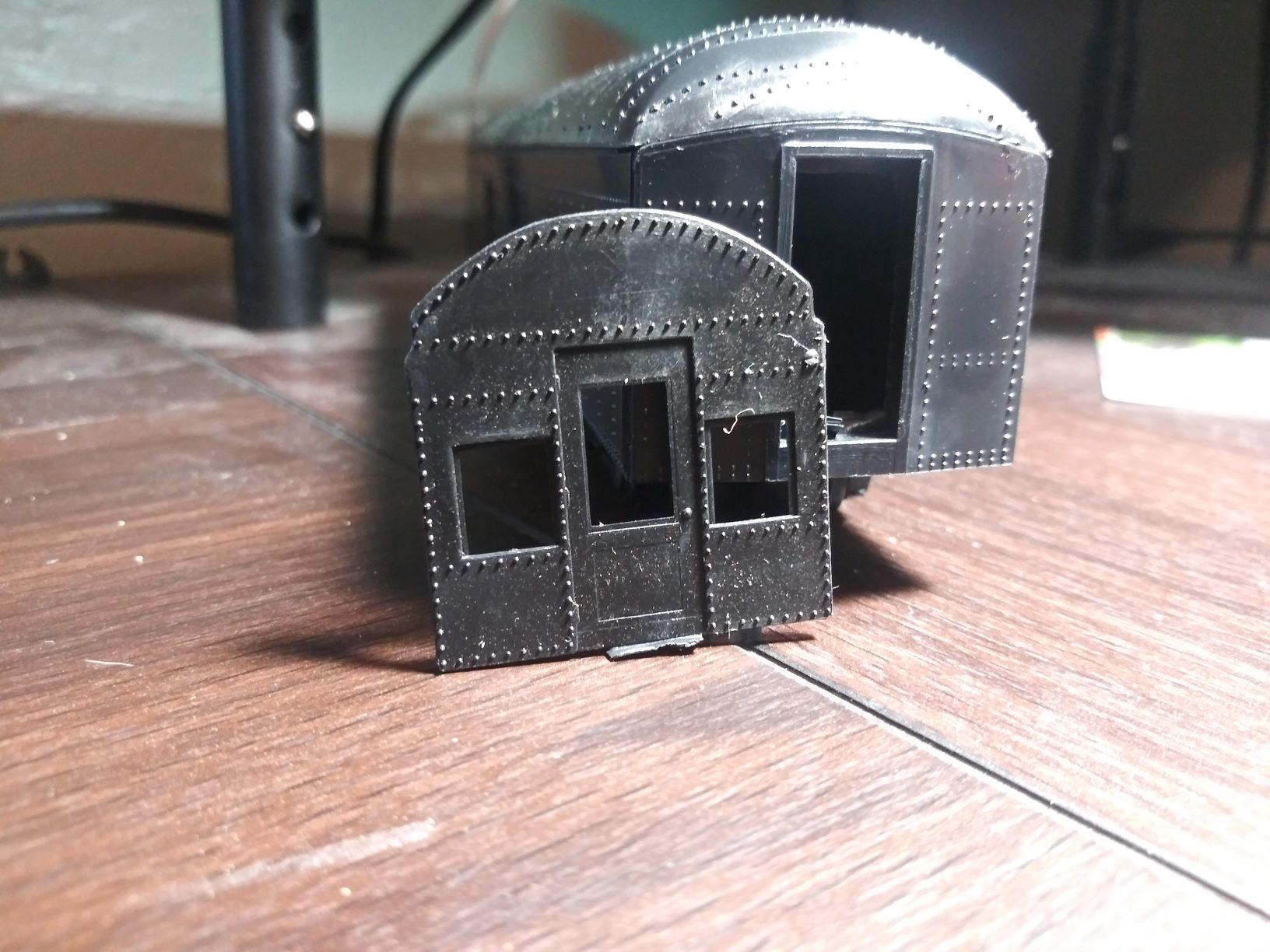

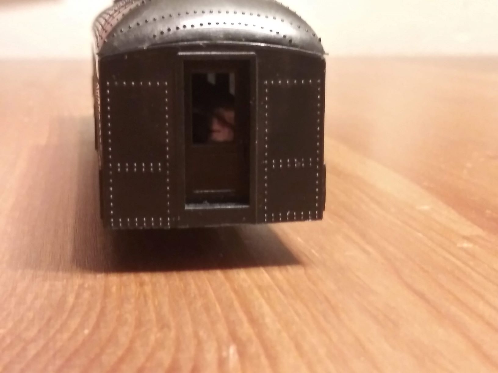

I figure the ends of the baggage car need doors.  I don't want to just see down the middle of the car when it isn't coupled to another car.  The kit came with the standard parts the same as all the other cars in this product line, and that means the vestibule ends that would not be needed for a baggage car.  Trying to utilize the parts in the kit, I cut out the doors from the rest of the vestibule end and glued them to the back of the opening.  A prototype car probably would not have a window in this door, so I may blank out the window later.  It looks much better with the door.
Nice job

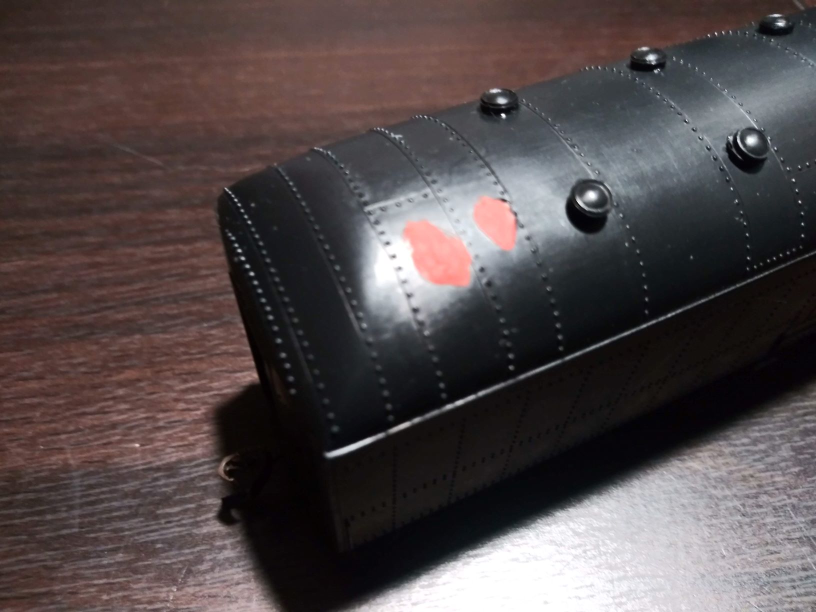

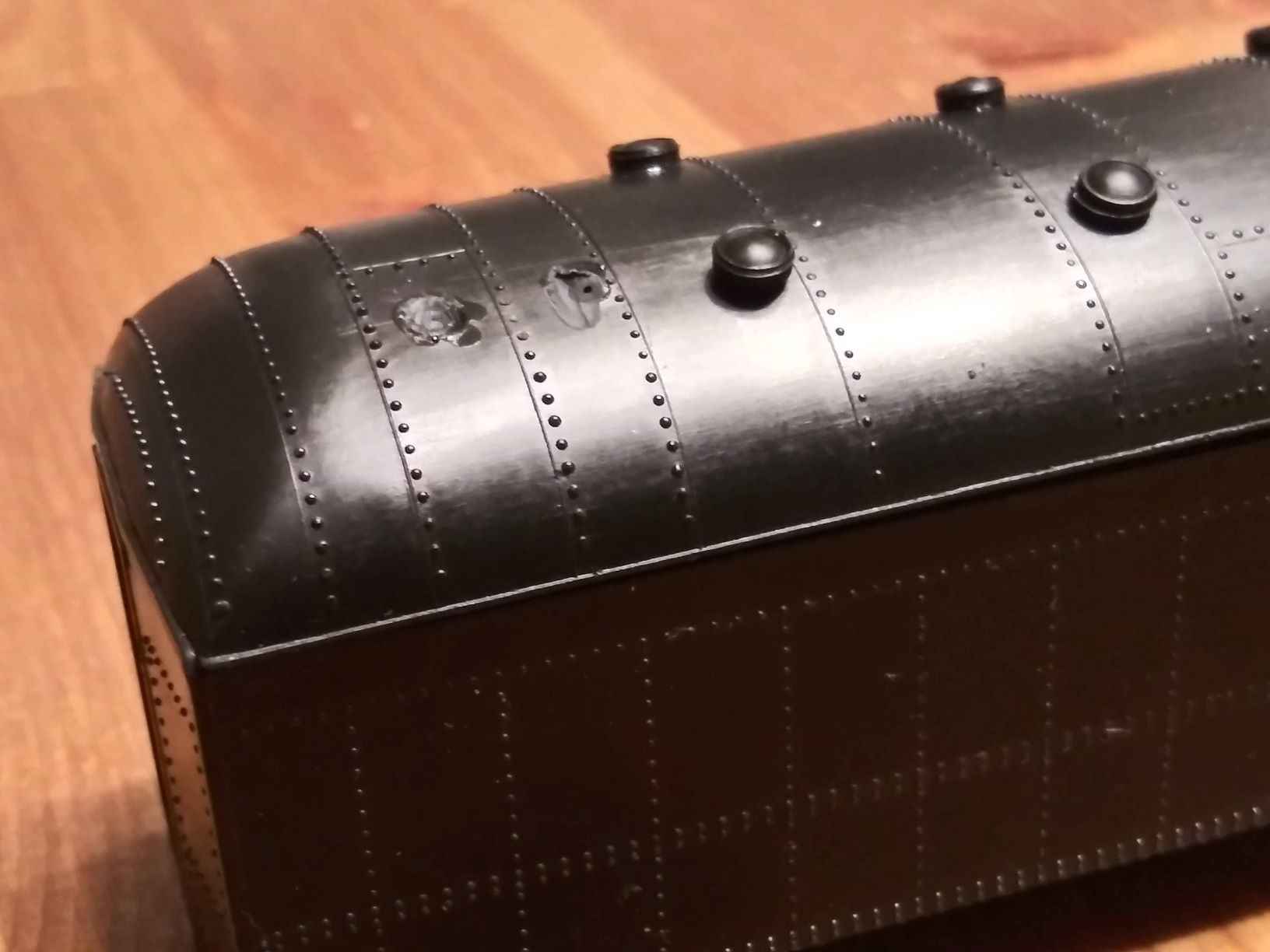

I decided to use all the roof vents, even considering this is a baggage car.  Logically, I would think that a baggage car would not need as many roof vents as a coach or observation car.  The main reason I left them is because I didn't feel like filling that many holes.
I think MDC used the same roof piece for all cars in this product line, and that is why there are so many vents.  There are two smaller vent holes that I think correspond to restroom vents, or possibly vents for heating.  Considering that I doubt a baggage car would have a restroom, I decided to blank those out.  I simply cemented the detail part in place, then cut it off flush and applied putty over the area and sanded flat.

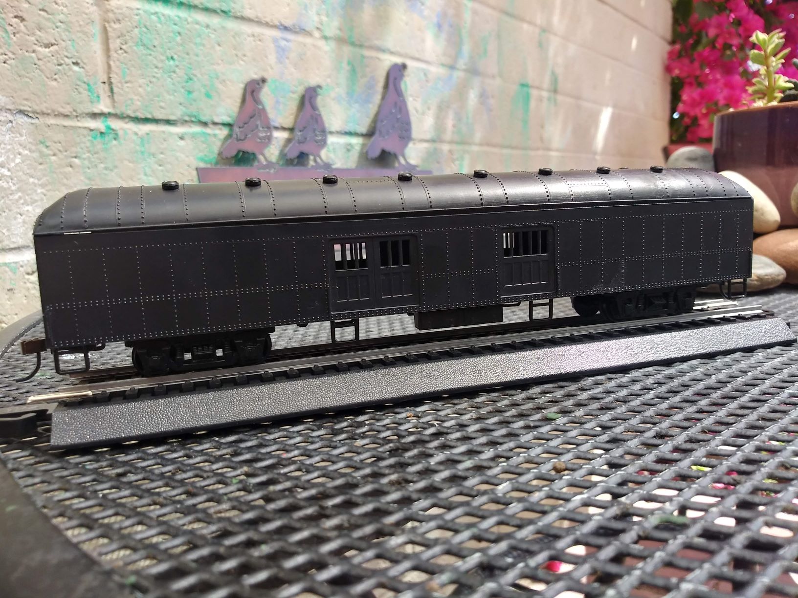

I decided to body mount the couplers.  I cut the coupler arm off of the trucks and used a Kadee box screwed to the underframe.  A relatively easy conversion.  My reasoning was that I may swap out trucks or move the bolsters closer to the car ends in the future, and having the couplers already body mounted saves a step.  I also worked on underframe details.  Not sure how much detail I want to add here, as my eyesight isn't what it was even 5 years ago for seeing such things beneath a car floor.  Plus - my goal here is to actually get something done.  My time and modeling funds are extremely limited these days - so the 3 foot rule using what I have on hand feels appropriate.  I am also sick of mail ordering parts.  The international package from doctorwayne actually got here much quicker than my last parts order, which seems to be sitting in the same location for the past two weeks.  I used the plastic steps that came with the kit.  Managed to break two off already and had to re-glue them.
