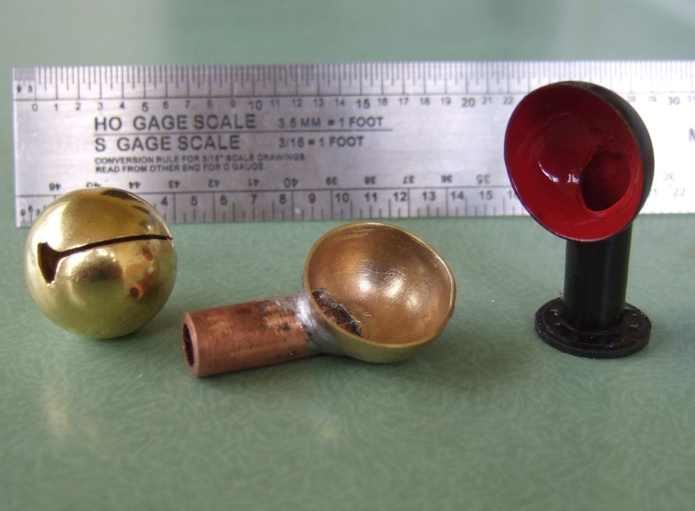

Sumpter250 Wrote:Half a plastic ball, and some styrene tubing( with a little "body putty" ) could make a reasonable facsimile.Well Sumpter 250 certainly did get me thinking. Though looking at the time I’ve taken you may be excused for thinking that I could have got half way to solving a major world problem by now. After a couple of great ideas that actually weren’t,
Finding plastic balls the right size.... "Aye, now there's the rub."
I’ve come up with this. [attachment=33910]
Still got to finish off the two smaller ones and I’ve still got to learn to solder properly.
Cheers, the Bear.

So !.........the "Cat" is no longer "Belled"
Plastic Balls / Brass Bells ....... It works quite nicely !! Nice job of "Junkbashing ". That's a good looking ventilator!

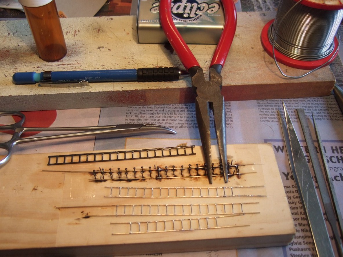

Buoyed by the relative success of the cowl ventilators I decided it was time to have a crack at the ladders I require for the funnels and the supporting superstructure. While I’d have liked to try the technique that I’ve seen doctorwayne and e-paw use finding the flat brass stock at my not so local LHSs has proved problematic and as I’ve already procrastinated for far too long, have come up with this alternative method using .020” brass rod and .016” music wire.
[attachment=33911]
Thanks for looking,
Cheers, the Bear.

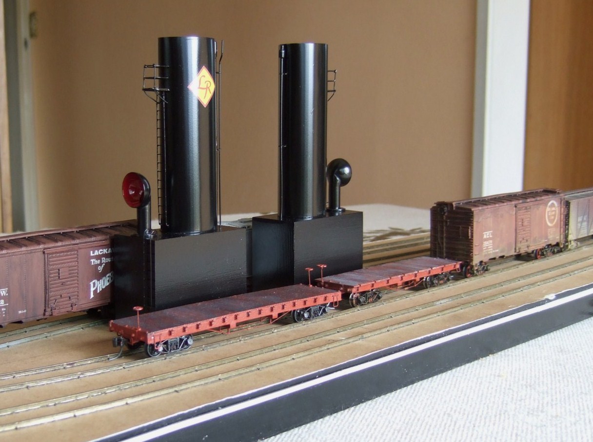

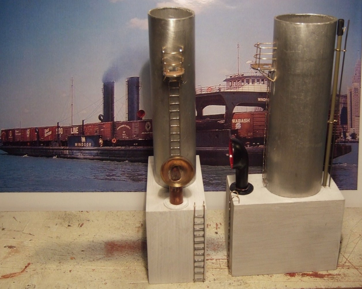

It may be slow, but it is progress. Putting the ladders and ventilators to the use intended.
[attachment=33912]
Thanks for looking,
Cheers, the Bear.

[attachment=33913]
I must admit though that I’m not approaching the task of making 850 scale feet of railing with quite as much trepidation.
Cheers, the Bear.
