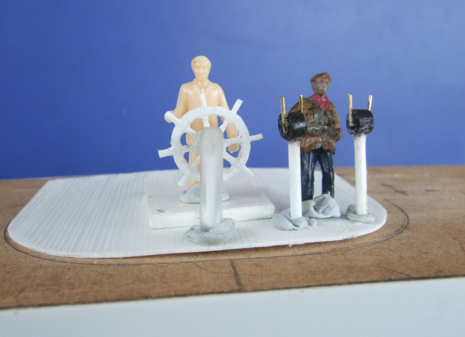

Pushing my abilities. Seeing what will visually work and if it actually does.
attachment=33926]
attachment=33927]
Any suggestions, advise, ideas will be carefully considered.
Thanks for looking,
Cheers, the Bear.
"pushing your abilities", is part of the learning process.
As modeled, each of those engine order telegraphs control two engines. Unless your vessel has four, you will only need one telegraph. the right hand handle for the starboard ( or fore )engine, the left handle for the port ( or aft engine ) engine.

The following is taken from “The Great Lakes Car Ferries” by George W. Hilton.
"Manitowoc." “Engines: Four fore and aft compound, 24” + 50” X 36”, 5200 HP.
Boilers: Six Scotch 13’9” x 11’6”, 160 pounds pressure."
Though the
“Detroit” was built some 22 years earlier, I presume that the external view was similar to this........
https://www.shorpy.com/node/15756
Cheers, the Bear.
B - I - N - G - O !!!!
Guess I won't be "questioning your research", you obviously have done it well.
That said, now I am looking forward to seeing even more amazing bits ( no pun intended ) of detail.
