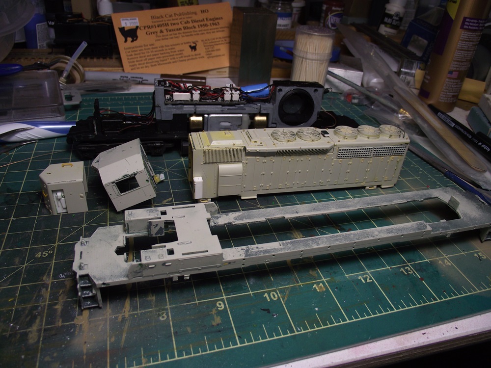

I did manage to get it apart. The shell actually comes off the chassis easily by removing the coupler screws. THe handrails were a friction fit so I just had to pry a bit to get them off. The long hood popped of but the short hood and cab took a bit more persuasion. The cab glass came half out. I'll see what happens after I strip the paint down.
[attachment=44722]
I placed all the handrails and other details in a container. I'll see about stripping the paint on the handrails later.

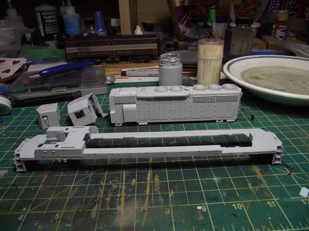

I sprayed the primer on the shell last night:
[attachment=44769]
It's already looking  better that I recieved it.
I did have a moment of concern/ near panic this weekend when I dropped the chassi about a foot onto my workshop floor. I took it to the layout and fortunetly there wasn't any damage. I did have some trouble finding the DCC address. I assumed that it was the orginal engine # but it had been reset to factory setting , #3

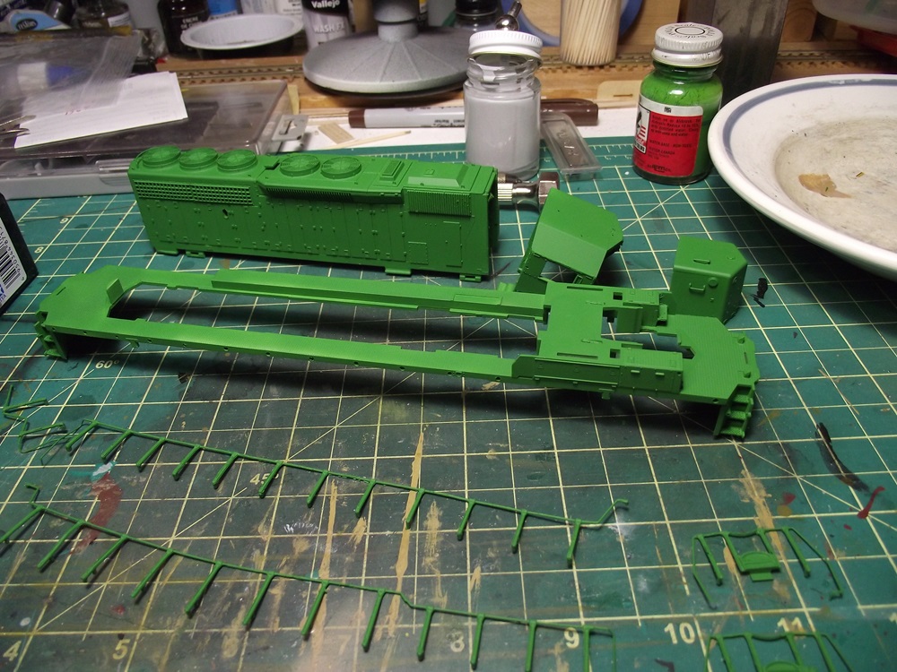

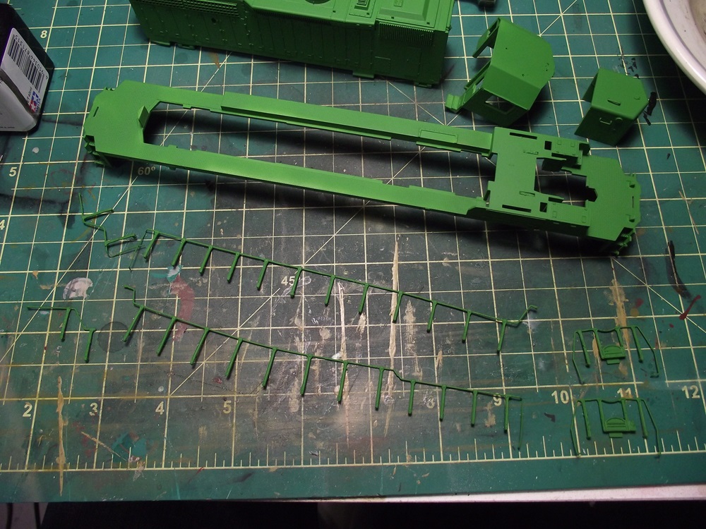

It's not easy, being green:
[attachment=44835]
Actually the green went on fairly easy. I just had the paint in intervals since I was painting both sides on most of the parts.
 [attachment=44836]
I also painted the handrails. The Iso didn't take the paint off the handrails very well but that might work in my favor. Since I think the original green paint was the badger 'flex' paint that was my primer for the Polly-s paint.

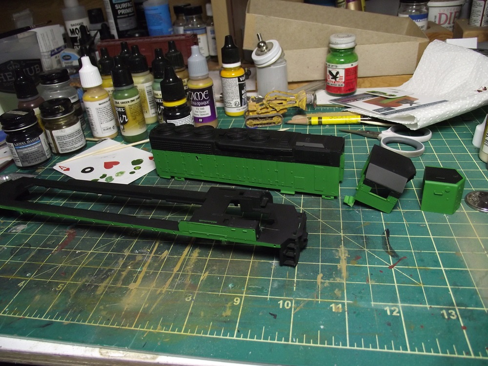

My decals finally came in so the project is back up and running. I spent some time last night masking off the body parts and painting the black:
[attachment=45026]
I'll be looking to apply decals this weekend if all goes well.

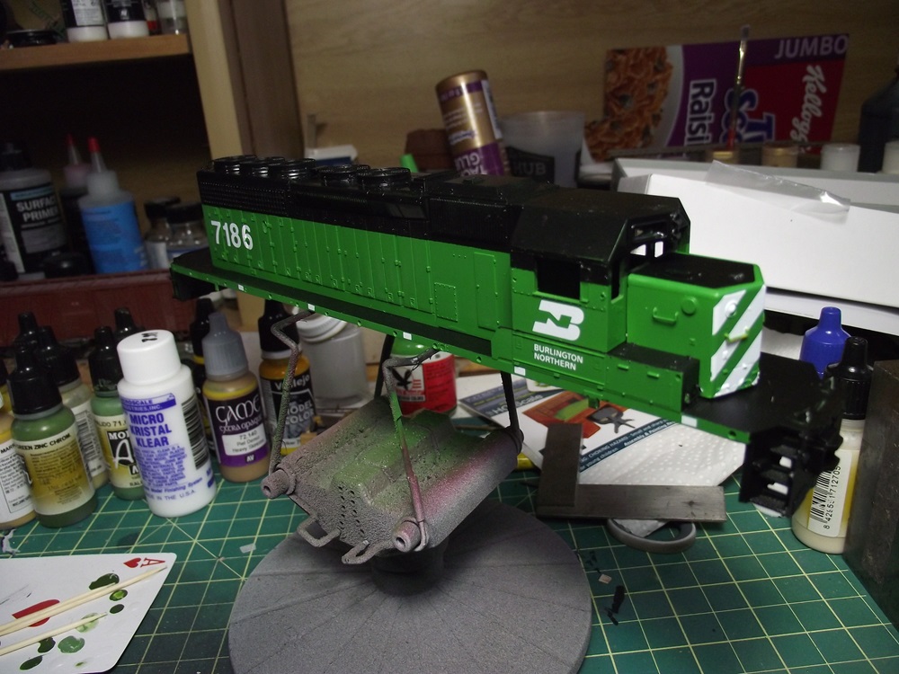

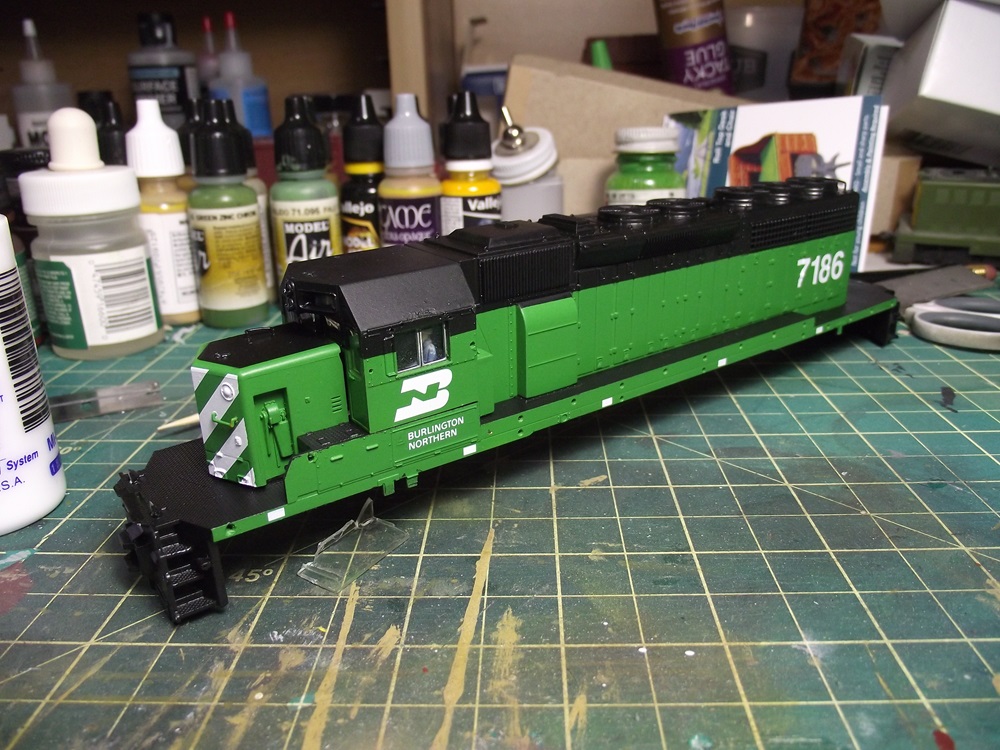

I decaled the engine shell this past weekend:
[attachment=45065]

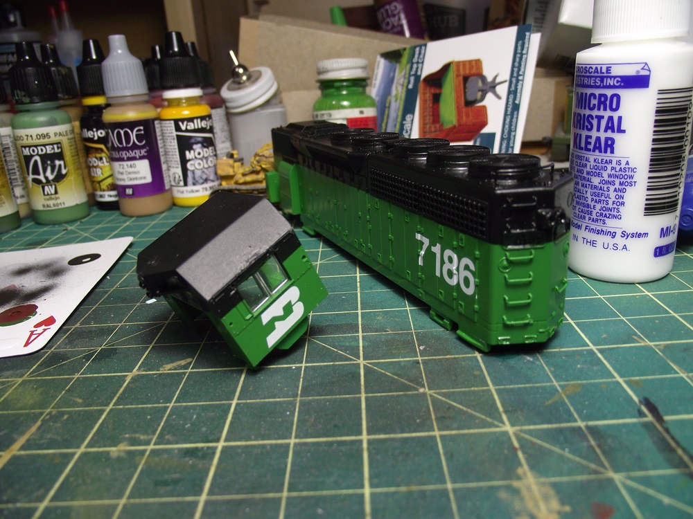

It's a pretty easy decal job, just had to use lots of decal set on the nose stripes and the large numbers to get them to conform over the shell details. I was going to add the nymberboard decals but the numberboard glass was ruined and I had to use some 'Micro Clear' to replace them. Turns out Micro clear and these decals didn't really work out. Oh well, the customer isn't that picky and he'll be okay with it as-is.
[attachment=45066]
Speaking of Micro clear and glass. the only glass that was re-useable was the cab side glass. Even that had overspray on it that we'll just have to live with. I reinstalled the side glass and made replacement glass for the rest.
 [attachment=45067]
Now I've started to re-assemble the engine. I got the interior tacked back in and the long hood is snaped back in. the nose and the hood might have to be glued down but I'll use something that can be removed later in case it ever has to come apart again.

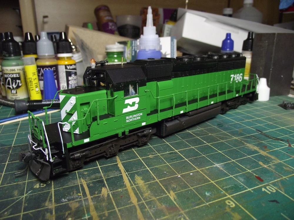

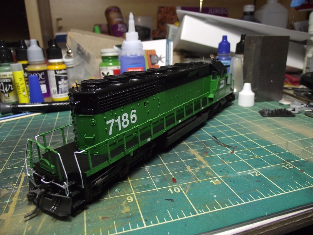

I finished off the project this evening.
[attachment=45085]
I re-installed the handrails and re painted the ends in white. I also repainted and added the horn, radio attenna and beacon light.
[attachment=45086]

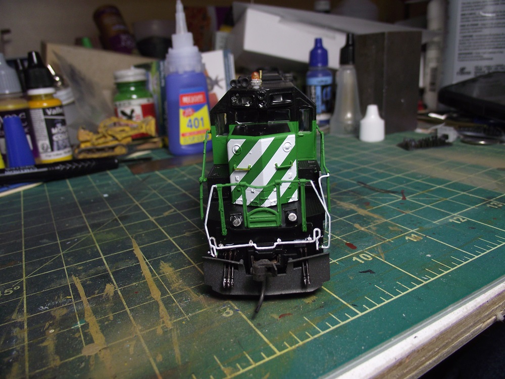

The tricky part was adding both the MU hoses and the snow plows. I first had to add the hoses, then thread them through the plows.
[attachment=45087]
Then I placed it on the layout for it's parting shot. Normally I use my photo diorama but it's current burried behind several other boxes at the moment.
