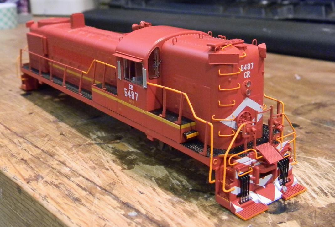

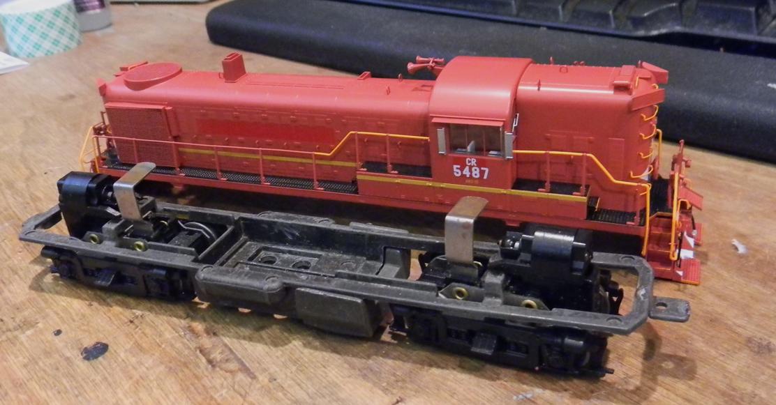

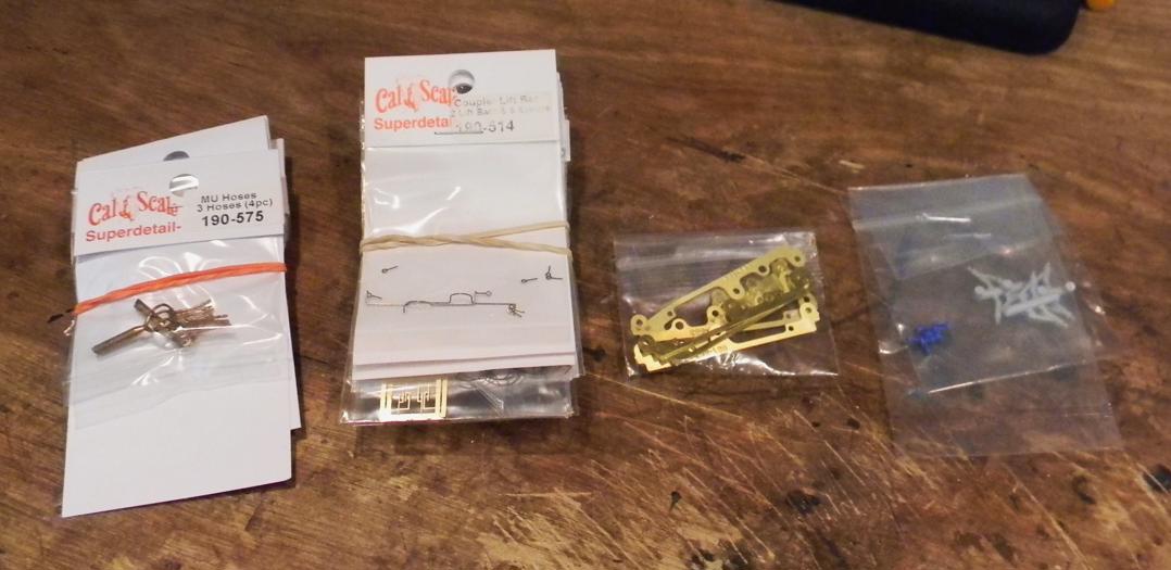

RE: Big Blue has inspired some purchases - TMo - 08-13-2026 The package arrived from Bowser this afternoon... The biggest (and most expensive) item by far was the RS3 Hammerhead shell that looks great right out of the shrink wrap. There's something elegant about the RS2's and 3's - classic lines and rounded edges... The paint job is really nice - looks like they used a faded red on the body and then were patches were applied, hit it with a more virgin Cornell red. Eventually I'll weather it a bit more... No light boards sent with this one (as opposed to the M620 that I worked on most recently), so a simple LED bulb on the front and rear is going to suffice once I work on putting in a decoder which is going to be conveniently mounted under the short hood. The other detail parts (grabs, coupler bars, horns, fuel fillers, lift rings, 3-axle wipers for the C628's, etc.) all seem to be present, so I can get back to detailing the three D&H locomotives at a minimum. Since the Roundhous RS3 chassis was sitting on my desk anyway, I thought I'd check the fit, which was a little less than ideal. I need to get the Dremel out and shave some metal off each coupler mount and about 1/16" off of the front and rear chassis faces to drop in to the shell. Seems doable. A lot more on my plate now! RE: Big Blue has inspired some purchases - TMo - 08-13-2026 Had a few minutes available - got the Dremel out and shaved off the end of the coupler "tongue" and cut into the front and rear faces of the shell to get the shell to fit over the chassis. Success.... initially in getting it to fit from front to rear. Getting the shell fully seated on the chassis was another story. Got my mechanic's rule out and the inside edge to inside edge of the Bowser shell was 0.72"... The chassis dimension for seating the shell (or the inside edge to inside edge dimension of the Roundhouse shell) was 0.75". It looks like I'll need to carefully shave 0.03" (0.015" on each side) of chassis material (which includes the portions of the frame that hold the trucks). Again, it's doable and part of the joy of kitbashing.... The other option would be to cut the plastic shell, but I'd be dangerously close to going through portions of the shell. RE: Big Blue has inspired some purchases - hillyard999 - 08-14-2026 I'm guessing that using a file would be the way to go, less chance of overdoing it. I'm remembering my "feeler gauge" I use to gauge the gap on spark plugs, which I think is 0.030. 0.015 is not a lot of difference in a gap, but a lot of filing. good luck! : ) RE: Big Blue has inspired some purchases - TMo - 08-14-2026 Thanks, Hillyard! Filing would certainly have worked, but I must confess I've gotten lazy in my later years.... Took the gear towers off to allow more space. The photo below shows all of the mods (green arrows) I've made to the frame to get a good fit. The Dremel with a cutting wheel used carefully with frequent fit checks worked like a charm! The chassis is now a nice friction fit into the shell. The green arrows in the photo below show where the interference conditions used to exist. ...and here's a side shot with the frame secured in the shell. Talk about timely, I got the Charlie Bowyer driveshaft in the mail today! Many thanks, sir - you're a lifesaver! Fits like a glove! Next will be installing the decoder, adding lights, painting and weathering. Eventually, I hope it looks something similar to this: xlv5487ef.jpg (912×643) RE: Big Blue has inspired some purchases - tompm - 08-14-2026 Looking very interesting thus far. You really are the king of the Frankenstein locos. It is great to watch how you cobble them together. RE: Big Blue has inspired some purchases - TMo - 08-14-2026 I LIKE that title! I'll take it! In all seriousness, I never would have taken on these last two locomotive projects unless there was something too good to pass up. These extra shells that Bowser has on their site are special. Even though this one doesn't have the light boards, it's a nicely detailed model. Honestly, the shell makes the fuel tank, air tank and truck details look a bit shabby.... But, I ended up getting the chassis for free, so for $45? STEAL.... Doc Frankenstein wins again! Another update tonight. The delivered motor mounts were toast... the plastic was disintegrating. I had some Athearn rubbery mounts that fit the holes in the chassis, BUT needed to be modified to fit the Roundhouse motor. There are two pics below of a portion of the old mount and the Athearn mount before and after mod (accomplished with a sharp knife carefully applied): RE: Big Blue has inspired some purchases - LiveSteamer - 09-06-2026 Oh my that RS3 is a beauty. I'm drooling lol. RE: Big Blue has inspired some purchases - TMo - 09-07-2026 Yeah, I'll agree that it is a beauty from the chassis up.... The fuel/air tank details that should be there..... not so much. The price? Hard to beat. Glad you like it, Matt. It's been running quite a bit on my layout - next effort with that should coincide with weathering the D&H Alco fleet, but I have made no new headway on detailing those - between visitors, having to replace one of the drive wheels on my zero turn and the blessed treehouse.... not much time. Another shot of the Hammerhead. RE: Big Blue has inspired some purchases - TMo - 09-12-2026 This doesn't qualify as a "purchase" per se, but I did decide to download another of the Illinois Historic Preservation Agency buildings. I think with some slight modifications the Tinsley building would fit into White Haven, and I downloaded the .pdf file this afternoon. Might be a while before I begin construction however... Tinsley Building - Preservation RE: Big Blue has inspired some purchases - Charlie B - 09-12-2026 I thought that was familiar. I just modified the front to fit with my hometown which produces Fiestaware. It made an easy backdrop building. Charlie RE: Big Blue has inspired some purchases - TMo - 09-13-2026 Yes! That's the one. The gaudy advertising might have to go, but I may also alter it - kicking that around as well as the size and roofline. Good to see it on the Wilderson! RE: Big Blue has inspired some purchases - tompm - 10-08-2026 I hope I can join in here, as seeing the work going on has inspired me to finally get around to one of my long pushed off projects. First some background. As everyone is aware, one road I model is the New York Ontario & Western. As far as models go there are plenty of wood reefers, wood boxcars, and coal hoppers. Recently, many locomotives have been released. Steam locomotives have been made by Mantua, IHC, Bachmann Spectrum, and Broadway Limited. NYO&W’s roster of diesel types is limited. They rostered F3, FT, GE 44 tonners, and NW2 locomotives. Stewart, Bowser, and Rapido have made numerous locos. To my knowledge no one has made a NW2. I was lucky enough a while back to obtain a custom Kato NW2 for NYW&O. You may have noticed one item I have not mentioned. That would a caboose. I searched and searched but they are rarer than hen’s teeth. Way back in late 2019 I found and purchased an Atlas Trainman NYO&W caboose. Since then, nothing. I have, however, acquired several decals sets for NYO&W cabooses. The other day I stumbled on the best opportunity in my opinion to make a custom NYO&W caboose. I found an unlettered Bowser Pennsylvania N-5c Caboose. The car was brown so no repainting needed. Since I have long given up on being prototypically correct I jumped at the item and purchased it. It arrived Tuesday. ![]() ![]() I dug through my decal sets and pulled this one out.
