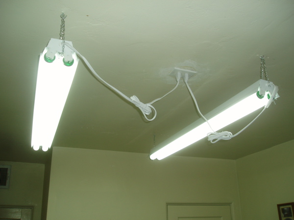

I've been meaning to post this photo for awhile to illustrate my simple (and cheap) solution. Granted, I have a 4x8 bedroom layout, but the existing light fixture in the ceiling wasn't sufficient. I settled on two el-cheapo shop light fixtures. I replaced the ceiling fixture with a duplex, and simply plugged the fixtures in. They hang on chains suspended from hooks in the ceiling. My only complaint is the ballast hums on these cheap fixtures. But the lighting is fine.
Re: Lighting for Layout? - Gary S - 12-21-2009
Hey, there's an ingenious solution! I like it!
