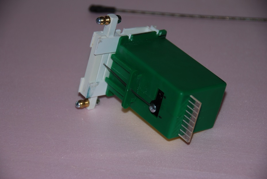

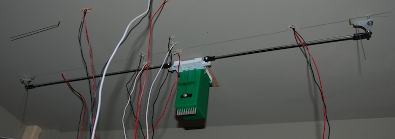

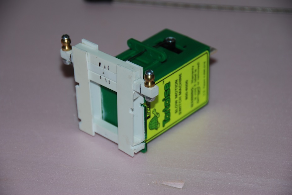

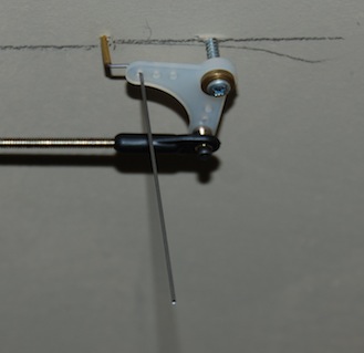

Re: The Burbank Branch - ocalicreek - 07-22-2010 Hmmm...thinking... :| Seems to me that if the distance the tortoise travels is equal to the distance the cranks move, then the adjustment needs to be made between the cranks and the throw rod itself. I'm not sure if moving the throw rod closer to the crank hinge/screw will help (putting in a different hole) but you may try that. I think biL is right, but perhaps in this situation, the way you've got it set up with the bend in the throw rod, you may end up having to move the whole crank assembly farther from the throw rod to increase the overall travel, vs. just shifting the rod. Not what you wanted to hear, perhaps, but it may be the best solution. Galen Re: The Burbank Branch - ocalicreek - 07-22-2010 Also, you've built into the system some tension where the throw rod meets the crank. So it's only going to go so far unless the throw rod meets the crank in a slot, not a hole. That way it is free to move in an arc. It will only travel as far as the slot or hole allows (unless the crank and pivot of the throw rod are the same). That may be your solution. Ream the hole or saw it into a slot with a jeweler's saw. Good luck. Galen Re: The Burbank Branch - Russ Bellinis - 07-29-2010 The normal method of increasing the throw of a Tortoise is to move the machine farther away from the table so that the wire traces a longer arc. I'm not sure how your Tortoises are fastened to the bell crank mechanism, but if you can fit some washers for shims between the Tortoise and the bell crank, you should be able to increase the throw. Re: The Burbank Branch - ocalicreek - 08-01-2010 Russ Bellinis Wrote:The normal method of increasing the throw of a Tortoise is to move the machine farther away from the table so that the wire traces a longer arc. I'm not sure how your Tortoises are fastened to the bell crank mechanism, but if you can fit some washers for shims between the Tortoise and the bell crank, you should be able to increase the throw. I think the throw will still be the same because the bell cranks are the point where the throw is reduced. I still think the solution is a slot vs. a hole to allow the bell crank to move further. Once that modification has been done then moving the tortoise may have an effect but the way the bell crank is attached to the throw rod is the limiting factor. Galen Re: The Burbank Branch - JohnyBotto - 09-09-2010 I have finally made it back to the layout room! Installation of turnout motors and wiring is underway once again. I have a question regarding the Tortoise switch machine and wiring 3 lead BiColor LEDs. Does anyone have a diagram of how to do this? (I do not have 2 lead BiPolar LEDs so I can't just wire them in) My thinking is that I connect the common anode to either pin 1 or 8 and then wire the 2 individual cathodes to pins 2 and 3 (or 6 & 7). and use pin 4 to power the frog of the turnout. Any thoughts? Re: The Burbank Branch - ocalicreek - 09-15-2010 Did you resolve the turnout throw issue? Galen Re: The Burbank Branch - JohnyBotto - 09-17-2010 ocalicreek Wrote:Did you resolve the turnout throw issue?Hey Galen, yes and no to your question. I took the easy way out, each turnout in the crossover has its own Tortoise, they will be cross connected. It came down to time and frustration level. Still under the layout playing with spaghetti, hoping it looks and works like wiring when I'm done. Not my favorite part of the process. |
