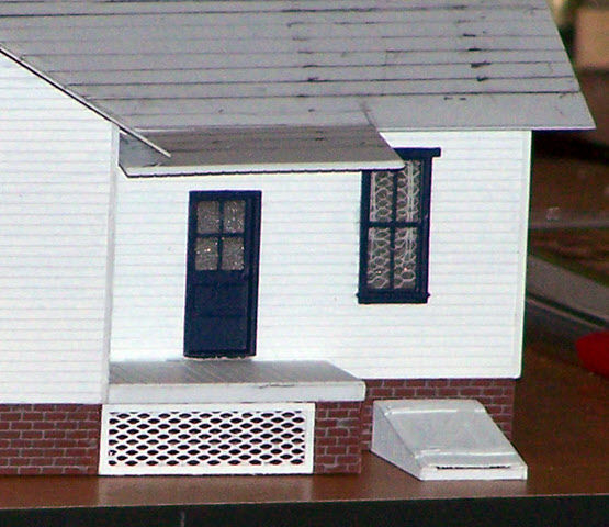

ok oppinion time guys Misngth the lattice under the porches in the photos do you think that the 2 by 4 frame is too big should i redo it with 1 by 4's?
jim
the thingon the right in photo is the cellar entrance.
Re: jim currie 2010 summer victorian house challange - doctorwayne - 08-31-2010
Looks good, Jim, Thumbsup Thumbsup although the thickness isn't apparent in the photos. If you're concerned about it, then you should change it. One of the drawbacks of using 1" thick material in HO is that, while it looks right, it's not particularly stable - this fence at V.A. Wagner Lumber is made from styrene 1"x10" and it's warped more than a real wooden fence would have. Wallbang
[Image: Foe-toesfromfirstcd230.jpg]
If you change it for 1"x4", you can always put 2"x4", painted dark grey, on the rear side for added strength, or it may be possible to simply flip the entire lattice assembly, then add the 1" material to the "new" front.
Re: jim currie 2010 summer victorian house challange - jim currie - 08-31-2010
doctorwayne Wrote:Looks good, Jim, Thumbsup Thumbsup although the thickness isn't apparent in the photos. If you're concerned about it, then you should change it. One of the drawbacks of using 1" thick material in HO is that, while it looks right, it's not particularly stable - this fence at V.A. Wagner Lumber is made from styrene 1"x10" and it's warped more than a real wooden fence would have. Wallbang
Doc that was my thought on the 1by4 too thin so just fliping the thing over and adding the 1by4 is the best option
Re: jim currie 2010 summer victorian house challange - Gary S - 08-31-2010
Jim, from the photos, it looks fine. But like DocWayne said, if it bothers you, then change it. The suggestion of adding it on the other side is a good and simple method. But still, just from the photos, it looks really good.

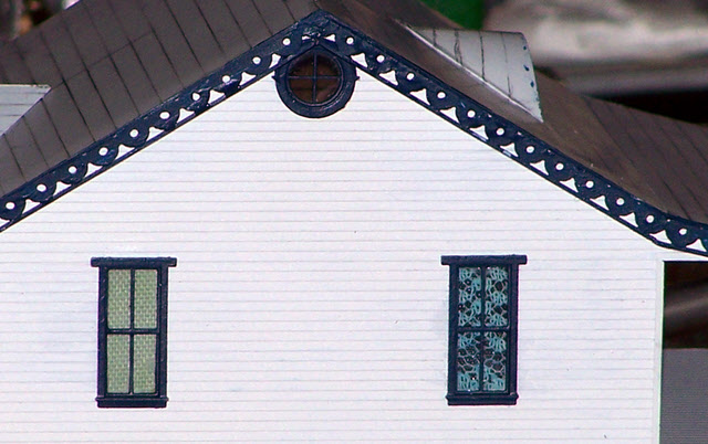

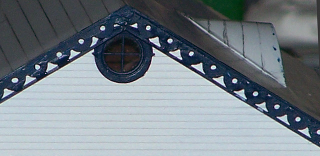

Re: jim currie 2010 summer victorian house challange - jim currie - 09-04-2010
just a quick update the bardgeboards are starting to go on i slaped a fast paint job just to show them better , will put better pics on later tomorrow.
jim

jim currie Wrote:the thingon the right in photo is the cellar entrance.
I remember those....even the wood door(s), on the house I grew up in, my Grandparents' homes, and the house I lived in in Maine ( that one was steel, and had a steel door ). Very nice touch, not too often seen these days. The lattice work, and the barge boards look great !
Re: jim currie 2010 summer victorian house challange - P5se Camelback - 09-05-2010
The house I grew up in, the Methodist Parsonage in Wayne, PA, built around 1910, had one of those out side entrances to the cellar, too, along with a stairway down from the kitchen. The sides were stone, like the first floor of the house (the second floor was wood shingles,) and the doors were wood, with a wood 2x6 that sat in two "U"-channels "barring the doors" and keeping them secure from unauthorized entry from the outside.

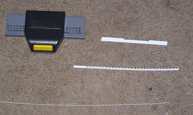

Re: jim currie 2010 summer victorian house challange - jim currie - 09-05-2010

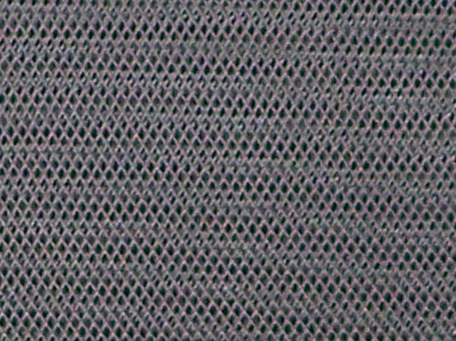

thanks pete here is the way i made the barge boards the thing in the upper left is a paper punch the white thing next to it is a spacer that is taped to the punch then a scale 2 by 12 is run through it after that a scale 2 by 2 is glued on making the board in the second photo ( end up being a bit in the fragile as i found out Wallbang broke off a corner ) the lattice is simply a sheet of aluminum countour mesh cut out and framed and painted white .
jim
Re: jim currie 2010 summer victorian house challange - Gary S - 09-06-2010
The paper cutter idea is terrific! And those fancy boards for the trimwork came out great. Another technique to add to the reportoire.

Re: jim currie 2010 summer victorian house challange - Sumpter250 - 09-06-2010
Paper punch !!! Icon_lol 35 Goldth
I can clearly see that I need to make another trip to the craft store for "tools" !
How many times, I've walked past that area of the store, and never thought for a minute that the decorative paper punches could be use to make "decorative house trim". Thumbsup Thumbsup
