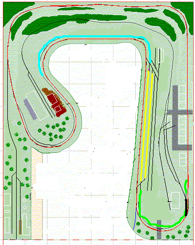

I suggest that you use/modify the latest plan as follows:
Note that the light blue line serves as the yard lead in this version.
The yellow tracks (double ended sidings) act as arrival/departure tracks. The double-endedness is good as it allows trains to arrive or depart in either direction.
You eliminate the light green track and connect the branch line closer to the town (thick black line). This eliminates the requirement to keep your arrival track clear since the branchline (as drawn) connects directly to it.
As mentioned in posts above, you move the passing siding from behind the town to near the Furniture Factory (or put an engine escape in at the factory).
Andrew

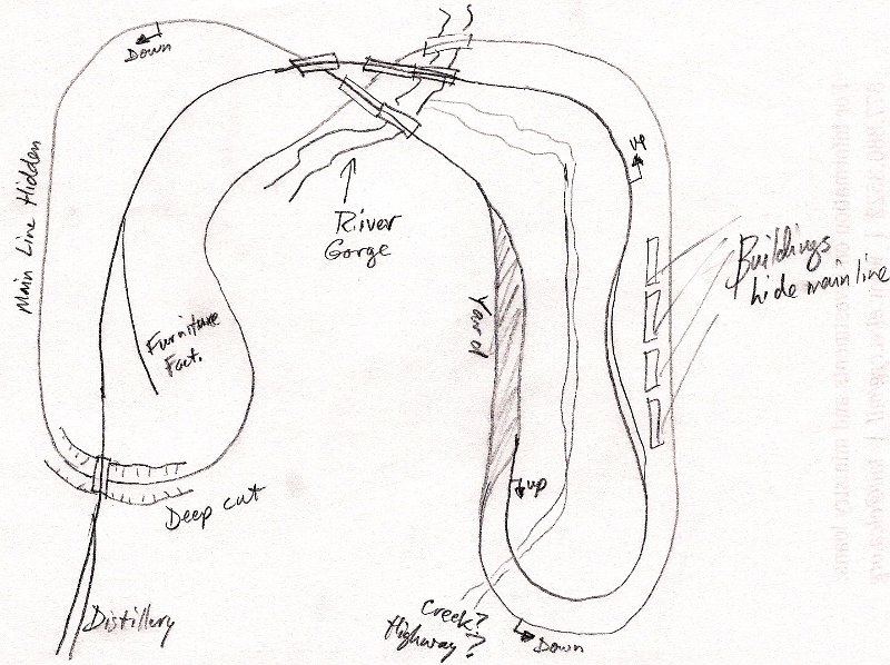

Here's a rough sketch with a couple of the ideas I mentioned, plus a new one - making the main into an up-n-over figure 8 for more visual interest.
I hope this helps to explain better some of what I was describing. Like I said it is VERY rough - just a sketch - with very little detail as far as sidings, etc. However the main line is there along with the branch. No elevations just arrows indicating generally where the grade begins.
Essentially the lowest point on the railroad is the main line where it passes under itself and the branch. I suggested a river there for a blockbuster scenic opportunity. However, if you didn't want the main to pass over itself you could let it cross itself at a grade with a nice interlocking tower. Add a staging track behind the town on the right and the branch on the left and you could simulate all kinds of interesting operation, suggesting two different rail lines crossing.
Add a connecting track at the crossing from one side to the other and you could simulate interchanges. If the branch line is actually a short line then voila, you've got three railroads! Add another connecting line behind the crossing (hidden) and each road could come out of staging, run through the crossing from either direction (E-W or N-S movements) and return to either staging. Loads could be shipped from the MKT to the Santa Fe via the interchange then delivered by the Mexicali Southern, based in the yard, to the distillery. You get the idea.
Anyway, if you didn't want to get all that into operations its still an interesting plan. The main for continous running and the branch for switching. Fun indeed. The creek could also be a highway, a dry wash, or concrete drainage channel and still provide an interesting scenic break between the yard and the first town on the branch.
Galen

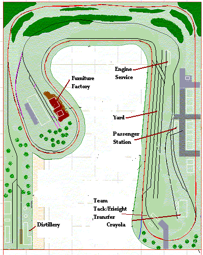

Here is V.9.0 of the trackplan, trying to take into consideration what you all have suggested. Like you, I have been unsure about the long branch line to the furniture factory. I like the scenic opportunities at the top of the layout it enables, but I don't like how it basically only goes from the yard to the factory and back. I could add another stop along the way for a little more point-to-point operation. Taking Steamtrain's thoughts, I simply added a turnout to continue around the factory back onto the mainline. I didn't want to create a reverse loop.....I'ma 'skeered of wiring, and a reverse loop really 'skeers me! Confusedhock: I also created a small run-around for the engine within the factory. Don't know if that's allowed or not. I eliminated the bottom inside loop and connected to the main. I also added the team track and transfer facility directly off one of the arrival/departure tracks from the yard. Galen, I'll get to your scenic suggestions next, I haven't forgotten you....
OK, boys, let me know what your thoughts are. As you can tell, trackplanning is the most frustrating part for me, probably one of the big reasons I haven't been able to complete the 2 or 3 previous attempts at building my railroad. I'm really not a stupid guy, but this makes me feel REAL stupid :oops:
