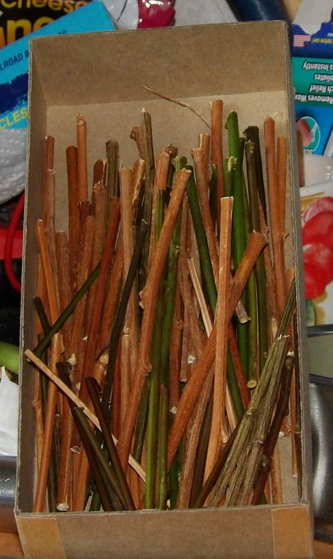

RE: Log cabin - jim currie - 08-09-2022
Don here's what i found so far in diminutions you could use      if you think these will do will get them in mail asap. the green ones will turn brown as they dry.
Jim

RE: Log cabin - ezdays - 08-11-2022
(08-09-2022, 06:55 PM)jim currie Wrote: Don here's what i found so far in diminutions you could use  if you think these will do will get them in mail asap. the green ones will turn brown as they dry.
Jim
Thanks Jim, I sent you an email in case you didn't have my address. I'm sure they'll work. Gives me an idea of how I want to proceed.

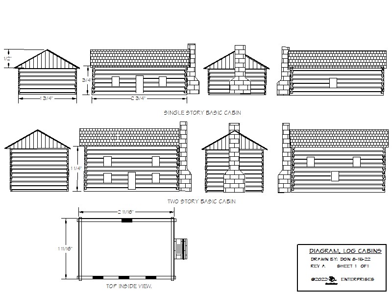

RE: Log cabin - ezdays - 08-16-2022
Had time and was able to do some design work. Log cabins are very basic, most being nothing but a rectangle with a fireplace on one end. Some through time evolve with porches, lean-to's and pop-outs. Some are built in "dogtrot" style, two separate squares with outdoor space between them. Many over the years get elaborate siding and extensions added so that there's no indication that there's a log cabin underneath all that bling. Some cabins were supported by some rocks under the four corners, then the floor was held in place with "sleeper" logs attached to the first course.
Anyway, my initial plan is to go basic until I get the hang of it, I want to see how difficult it is to do individual logs, just like the pioneers. Here's my initial sketch of a single and a two-story cabin. I can add porches and whatever as things move along. I do not intend to detail the inside but it's always an option

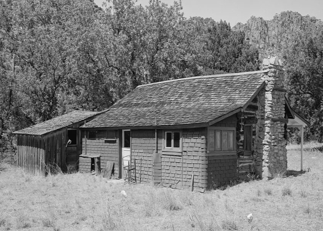

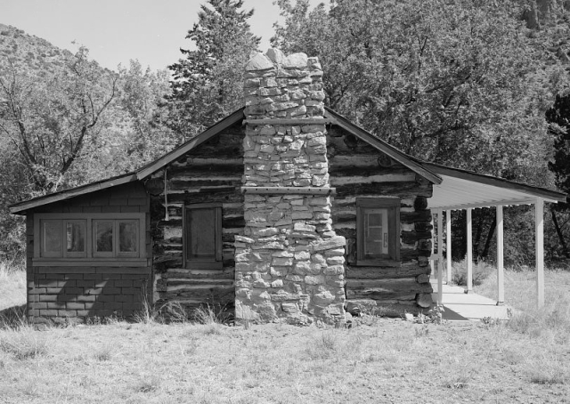

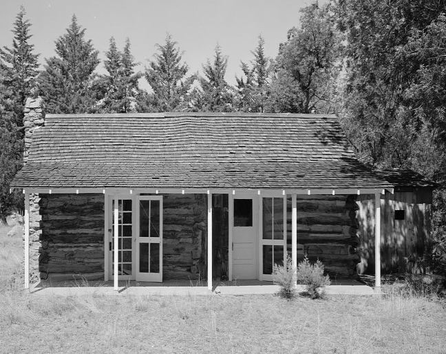

Don your log cabin has woke up a urge to build one myself, your design looks good. in the 1990's we lived in a old house in meeker Colorado that was originally a 4-room log cabin with a add on in back, most of the house was recovered except one small room that they left the log walls showing  i found this one on library of congress.
    with drawings . your logs will be there Wednesday according to usps  Icon_rolleyes.

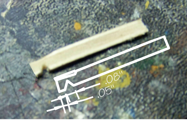

RE: Log cabin - ezdays - 08-18-2022
Here's what I've got so far, gentleness is the only way to handle these pieces of wood. Anything that puts pressure on the wood will split it and that little piece past the notch will break. Xacto blades, dikes, needle nose pliers, anything. I used a diamond wheel and it cut a notch with no problems. I was able to even shorten that overhang piece using the same wheel. According to what I have, the notch opening is about 12 1/2" and the overhand is 8". I can always trim the overhang after assembly. I need to make two jigs, one to be able to flatten two sides of the log and maintain even thickness. The other is to secure the log so I get consistent V notches at both ends and just the right distance apart.
For now, I'm happy with the cutting wheel to make the bottom notches and the top V to accept the notch of the log on top of it. As for flattening the sides, the wood cuts nicely and doesn't seem to splinter so I'm not sure how I'm going to do that yet, sanding is an option, two parallel Xacto blades might work. We'll see...
