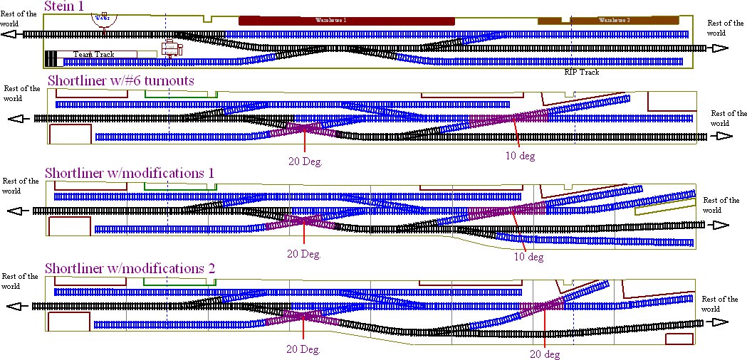

Here's the latest iterations, all in one image.
The first is Stein's plan that I re-drew in CadRail and is the same one posted earlier. Of the variations of this plan that Larry and Stein discussed, I still prefer the original. This doesn't include some of the scenic recomendations that Stein recommended yet.
The second is simply a redraw of Shortliner's with #6 turnouts and sized to the dimensions that I have available. Because of the lack of shelf depth and those relatively wide turnouts, it doesn't have quite the same "turn right to go left" feel for the one spur that Stein has a penchant for.
The challenge with this and the next two is that I would have to hand-lay the crossovers with no jig to guide me. That's a minus for getting started quickly, but a plus from a challenge / new opportunity standpoint.
The third feels a little busy. My thinking was this: Stein has made a good point about disguising or hiding the fact that the "main" doesn't go anywhere. Shortliner's puts the interchange track right up front, so I experimented with ways to hide it, in this case with another turnout and spur in front of it. It required that I make a concession on space; on this end, the layout is 2" wider than my original spec (a little over 9"). I mitigated the intrusion into my workbench by limiting the width increase to one side.
In addition, all the track on this end is not running parallel with the shelf, for interest's sake.
The fourth is a variation on the theme above, though with the main swinging toward the edge then back toward the back enough so that some type of building can disguise the exit. The other big change on this one is that I brought the right / left spur into the new land area so that I could cross over the main at a sharper angle. The concessions to doing this were losing slightly more workspace area and and it cut the length of the track servicing the business on the other side of the crossober approximately in half. The track on the backside of the crossover is just over 7" deep - doesn't leave much room for error, and decreases operational possibilities that a spur that could hold two cars would provide.
My apologies for not providing place names - that makes discussing this quite a bit more difficult!
Is the runaround of sufficient length on these? I haven't spent a lot of time mentally running switching scenarios through this. Thoughts?

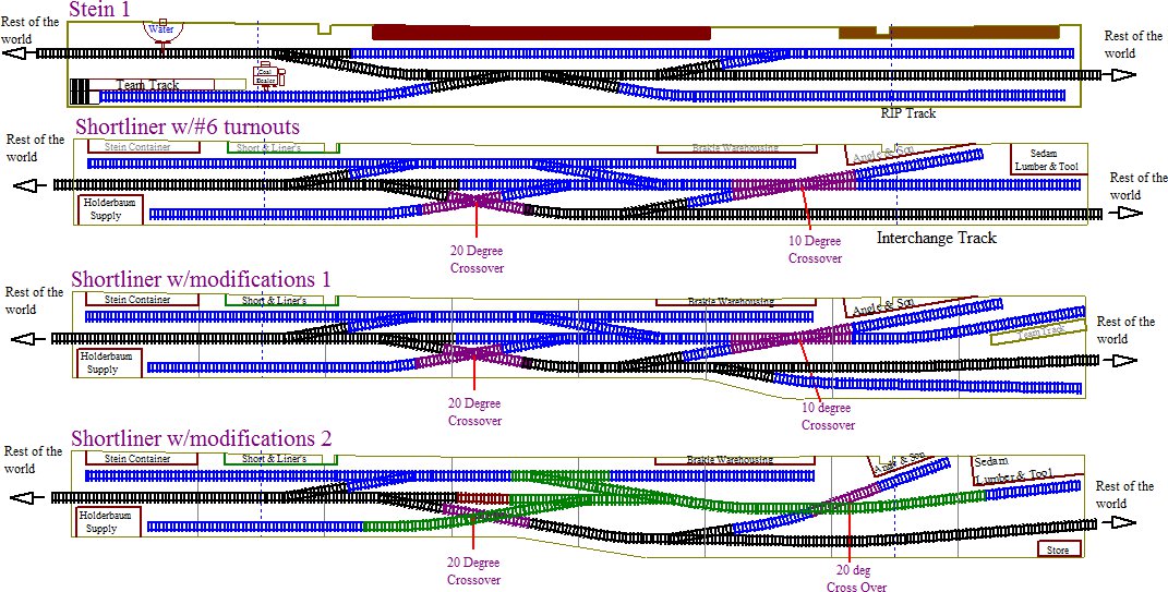

Re: Input on a "Temporary" Shelf Track Plan - tetters - 02-28-2010
There is something about Mod 2 that I like. I would avoid the use of the double slip. It makes things too easy. Misngth
Re: Input on a "Temporary" Shelf Track Plan - Fluesheet - 02-28-2010
tetters Wrote:There is something about Mod 2 that I like. I would avoid the use of the double slip. It makes things too easy. Misngth
Don't worry, that's just a regular crossover - just a very long one!
The crossovers will both have to be handlaid. Believe it or not, it was your finding, way back in Zealot days, that using the Fast Tracks jig made you willing to try (and successfully complete) more complex work that has me looking forward to that challenge.
By the way, your advice re: Fast Tracks Jigs back then to get a double crossover instead of a turnout only jig was sound. Unfortunately, I didn't follow it Nope
Oh well then in that case, I like Mod 1 better.
Too true about the x-over jigs. I myself, only wish I had figured that out sooner which is why I impart that advice to anyone thinking about purchasing a turnout jig from them. 35
Slight tweaks to the the fourth plan (Shortliner Mod2)
- Buildings have place names and other minor clarifications
- The right runaround turnout was flopped over to move the approach to Sedam Lumber & Tool closer to the front edge. This allows the spotting location for Angle & Son to have a little more breathing room.
Re: Input on a "Temporary" Shelf Track Plan - steinjr - 03-01-2010
Hi Matt --
I like no 4, too. It is a good adaptation of Jack's plan - just turning that one turnout at the left end of the runaround and letting both tracks on the far right curve gently down and up again makes it look even better, at the cost of making the layout slightly deeper, but still not very deep, at the right end.
Excellent work!
