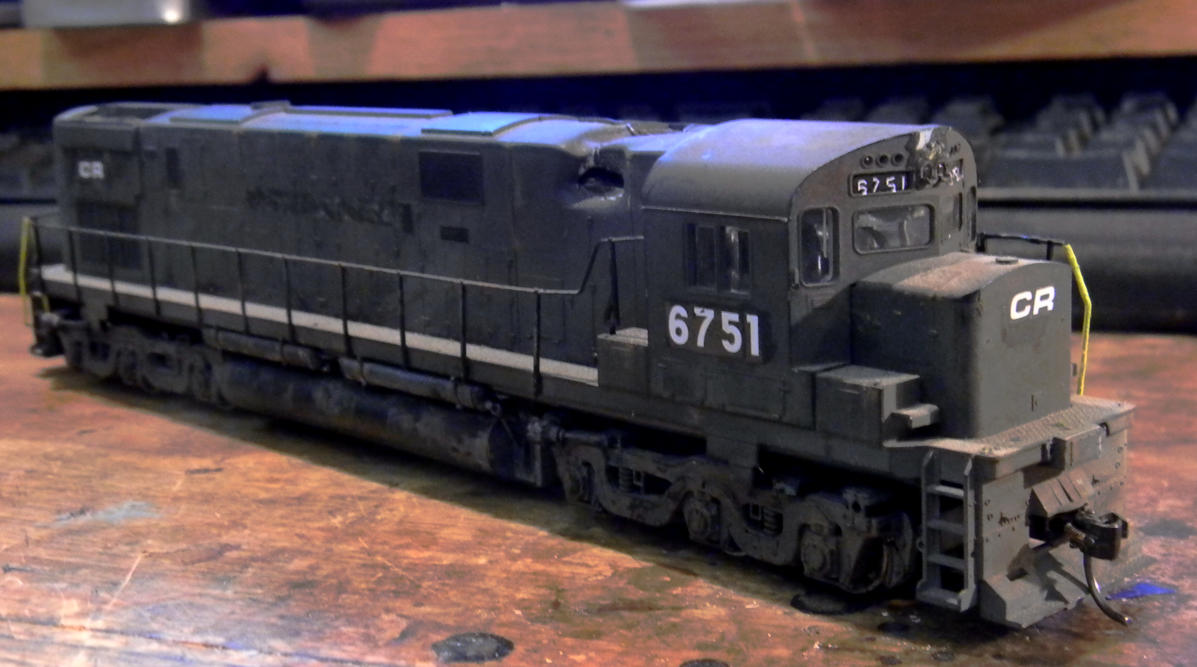

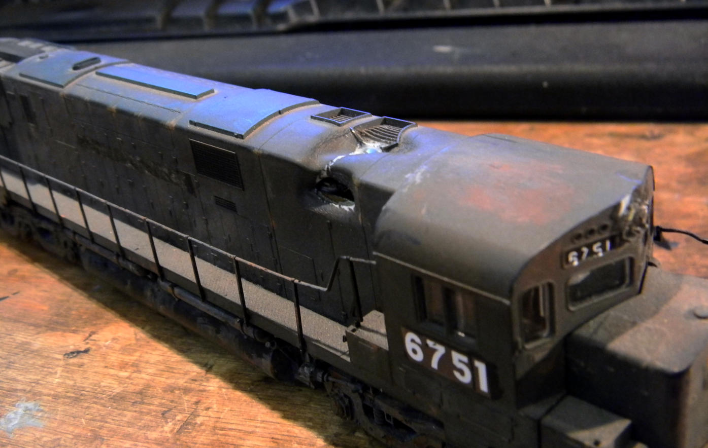

Ran some trains and started looking at my own personal "deadline" - a couple of locomotives with issues. 6751 is my ex-PC C628 that I've had for a good while.  Stewart model.  It's got a heat issue that melted the shell, and (probably not coincidentally, a DCC issue).  The melting started at least a year ago, but wasn't too bad and I was considering spackling and sanding the first depression in the sidewall, but the recent new warping of the top of the shell is just not operable.
Time to decide what to do with this beast, and the options are fairly large.  When running, it's a champ, so I'm going to keep the chassis. This was one of my first weathering projects and I am very fond of this shell and the weathering job that appropriately captures the look of the early years of Conrail, but like I said, it's literally TOAST.  Cab's still good (aside from a missing set of horns and a mounting frame) and I'm missing some front handrails.  The chassis would fit any of the Stewart/Bowser 3-axle Century models (C628, C630 and C636), so I went on the Bowser website and started looking for replacement shells, all of which can be had for $15 each.  However, there are two versions of the C636 shell that they are currently having a fire sale on ($7 and $2)!  The $2 version is (I believe) the version without dynamic brakes, but the PC never bought those, so if I want a C636, I think I'll have to pass on the $2 part.  The C636 also rode on hi-ad trucks, so I'd need to buy those - a full set of gear towers with the hi-ad trucks would run me $50, so no C626 for me!  I did have a PC C630 once, and I liked the look of it, but ended up selling it because I had a Reading version and this C628.

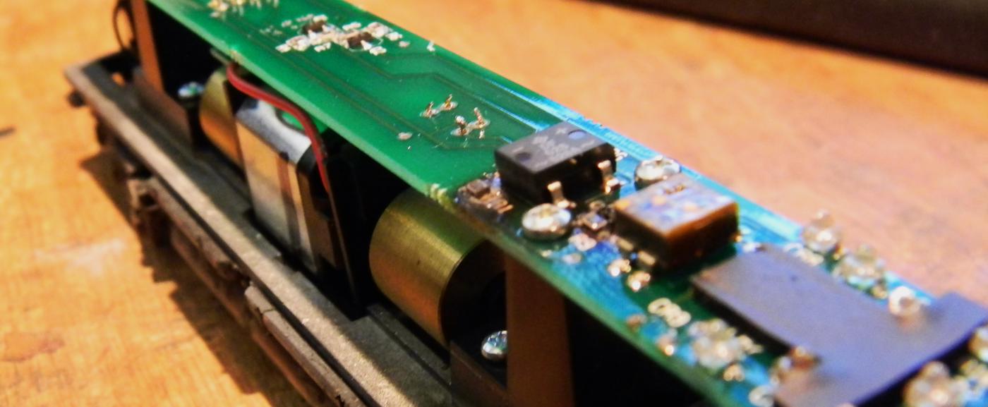

Also tore open the body and found the source of the heat - looks like a solid state resistor did a bit of thermal runaway...
I also reset the decoder and revived the unit's address and got it to run.  Looks like the resistor probably controls the class lights and the number board lighting.  Other than that, everything seems functional.  I will be running the unit for a while tomorrow to see if the resistor heats up again.
I'll keep my eye peeled for a used board or a defunct unit that I could use the board out of.  Bowser doesn't currently sell the circuit board.

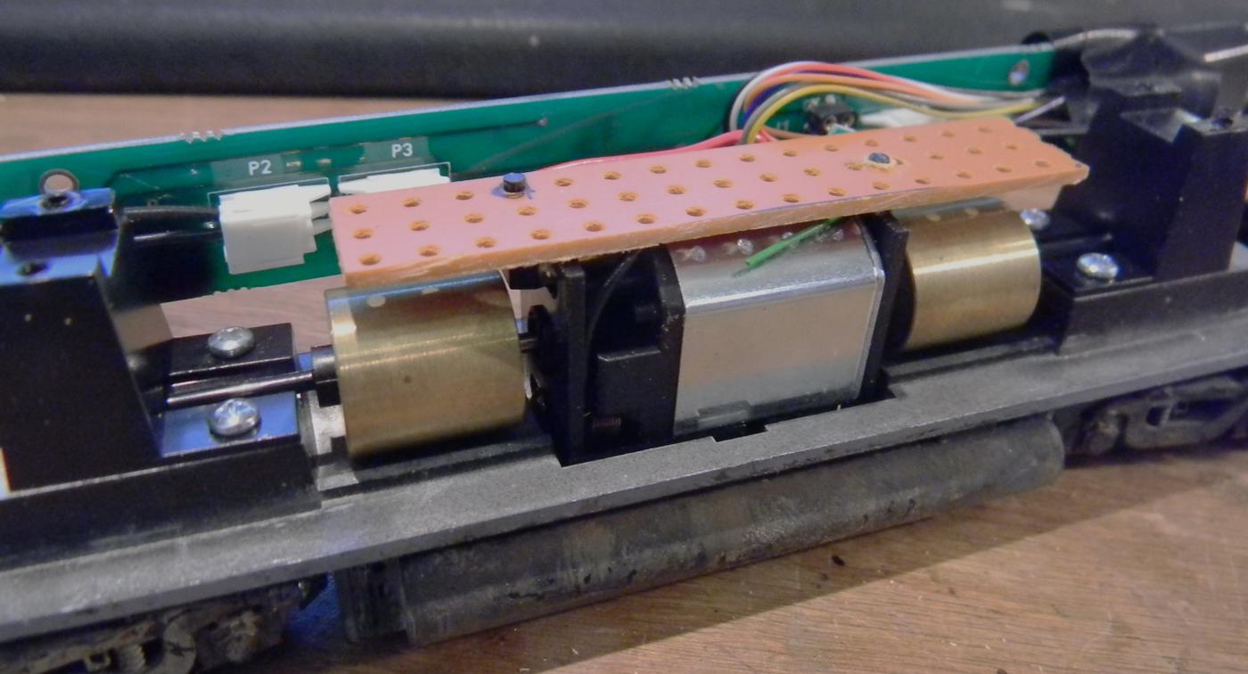

Before parts arrive, I thought I'd get some prep work out of the way.  Removed the screws that hold the circuit board down - the whole board is getting replaced with a new circuit card that is much smaller and will be secured over the motor.  There are connectors on the new board for track voltage, motor leads and a bigger connector with 5 or 6 pins for the lights.  The front and rear end of the locomotive will get their own lighting board that runs wires to the big lighting connector.
I cut a piece of bread board and drilled out two holes large enough to slide over the pins at the top of each side of the motor mount.  I'll figure out how to secure the circuit board to the bread board later.

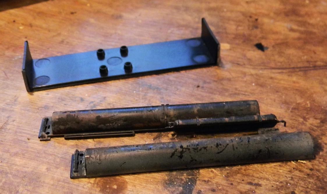

I also removed the fuel tank from the bottom of the frame (4 screws) and removed both sides of the tank since I'll be getting the new M630 tank profiles (right and left) from Bowser.  I could remove the trucks and gear towers, but I think I'll wait until I get the replacements to make sure they are completely compatible with the frame.

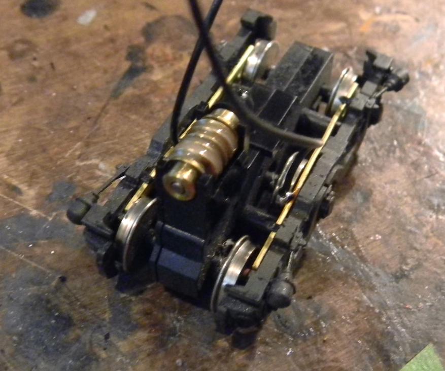

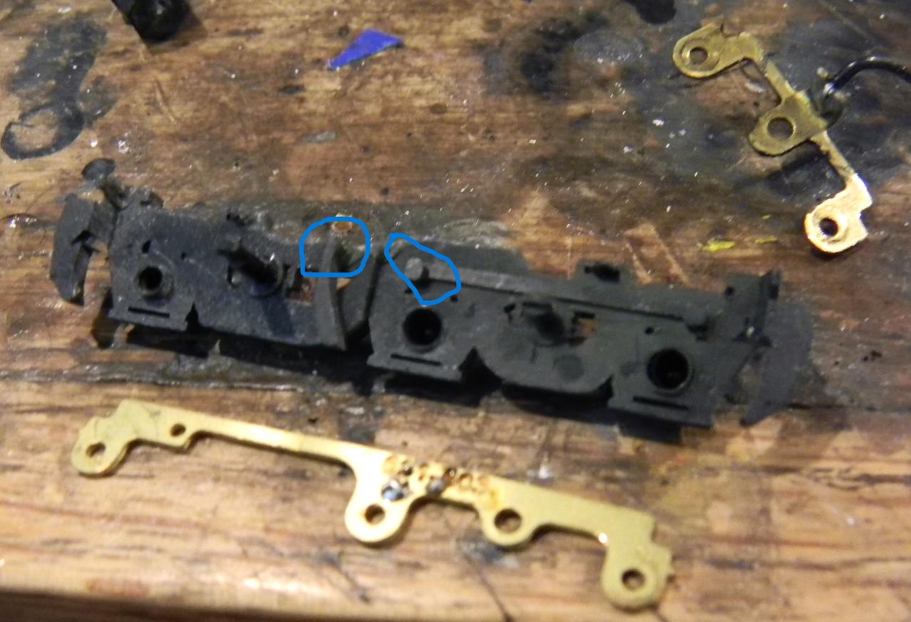

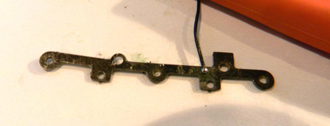

Back to the LV unit...  A few years ago, Bowser had realized that the old Stewart wipers only picked up the voltage on 2 of the three axles in each truck - the wiper just connected the closer two of the three axles.  Their new Executive Line of C628, C630 and C626 used wipers that were in contact Bowser put out a kit which included the 3-axle wiper and the plastic sideframes for the Tri-mount trucks if you wanted to upgrade your Stewart.  I figured there was no sense in getting the whole kit if I could just pick up the wipers (yeah, sometimes I'm pretty cheap), and I bought (I think) enough to cover 2 locomotives.  Those many years ago I opened up one of my locomotives and attempted to install the wipers but ran into fit issues.  I must have figured out how to make it work, but I didn't recall what I did today when I went to replace the wipers on the LV unit.
The 3-axle wipers are definitely NOT made for the Stewart plastic sideframes.  Without the fix I propose or without using new Bowser sideframes, the 3-axle wipers won't work. There are two major interference points (circled in blue in the picture below) where the plastic has to be removed to allow the wiper to ride correctly against the sideframe and is the only way the whole truck assembly will snap together and be functional. Picture shows the old 2-axle wiper, the new 3-axle version ($3 each), and the inside of the sideframe of the Tri-mount truck.
I did my modifications with a sharp knife, but a file could also certainly work.  You just have to remove enough plastic to allow the brass wiper to rest near the inside face of the sideframe.  The trucks themselves have to be taken apart carefully to retain the plastic gear arrangement - it's a nightmare if the things open up.  Here's a shot of the completed truck with the two new wipers.  Good project for a Sunday afternoon after spending the morning with a shovel and edger on my 400-ft road frontage.

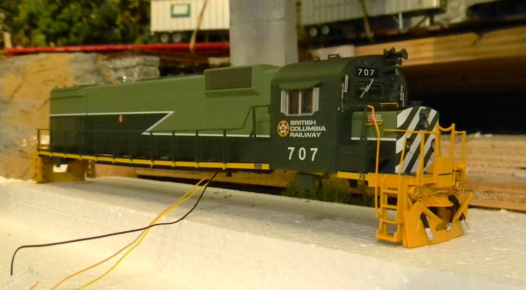

Ah, yes, the BCR M630....  turning into quite a project.  Here's a look at the shell I received.  Schnazzy!
What I thought would be easy and turnkey?  Nah.

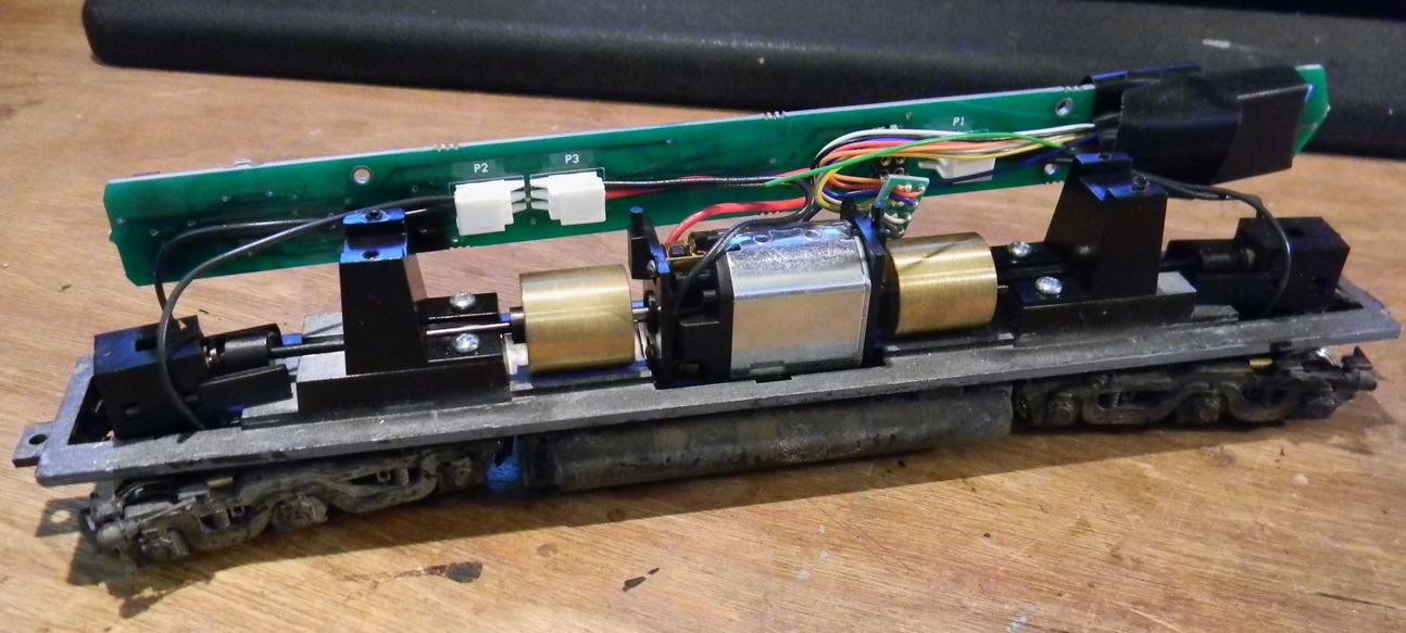

I previously showed my breadboard platform for holding up the "new" Executive Line version 1 circuit board.  Before tightening the circuit board down to the breadboard I decided to test fit the board.  Guess what?  It's not narrow enough to slide up into the shell of the M630...   There was some extra room on the edge of the board on each long side, so I took the board over to my sanding belt and removed what I could...   still functional and now fits into the shell.  Hurdle #1 hurdled.
Then there were the "prefab" trucks I'd purchased.  Thinking they would be plug and play, I added a micro JST connector to the tails going to the track wipers, plugged them into the circuit board, and put the clips onto the top of the gear towers to secure them.  Put another micro connector on the motor leads and plugged them in, plugged in the decoder and placed the chassis on the rails for the first time....  Noticed that one of the trucks refused to sit flat on the rails - 2 out of 3 axle contact and that truck would not track through a curve.  Hurdle #2...
Contacted Bowser, who suggested that maybe the bottom plate of the truck wasn't seated well.  Pulled the sideframes off of the trucks and examined the fit and function of the truck without the sideframes - road the track well and I was able to move all of the wheels by turning the worm gear with no resistance.  Then I examined the sideframes after taking off the wipers.  Turns out one of the wipers was warped (you can probably tell in the photo below that the axle hole on the left is substantially higher than the other two:
Fortunately, brass is quite malleable, and I was able to unwarp the wiper.  Stuck it back on the sideframe and rebuilt the truck.  Wah... lah...  runs on the track without derailing.

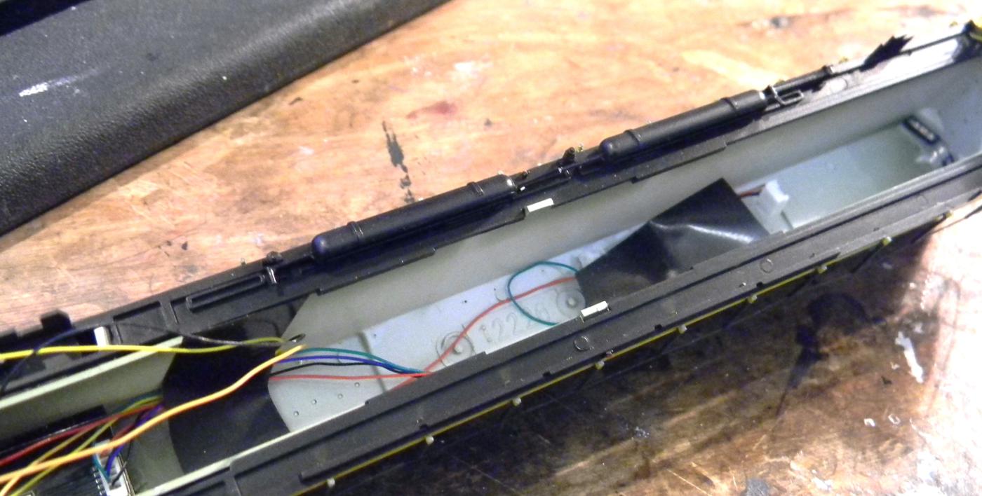

Before I dug into the lighting options, I thought I'd just try sliding the shell onto the chassis....  and discovered some what we call at work.....  FEATURES!  (Hurdle #3....)
The old Stewart air tank arrangement was accomplished by sliding the air tanks into slots above the fuel tank and that could be done after the shell was on.  Not so much with the new design - those tanks are part of the shell and the old Stewart chassis has cast metal right where those tanks are.
I'm going to have to remove some of the metal chassis to allow the shell to close tight to the chassis.  I'm going to have to get the Dremel out...
