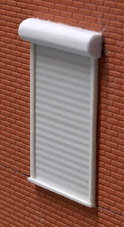

Re: Bushwick Terminal - fast car - 04-12-2013 shortliner Wrote:Kurt - what do you use for the roller doors with the tops, please Shortliner, It looks like Plastruct Half Round at the top of the window cut to length. \ Larry Re: Bushwick Terminal - cnw1961 - 04-12-2013 Painkiller, thank you. I am glad that I now have reached the stage where I can do the real fun stuff like building and detailing structures. Jack, the roller doors are corrugated styrene with square 1 mm strips on both sides and the tops are pieces from 4 x 3 mm Evergreen strips cut to length with two of the edges sanded off. Larry, close guess .

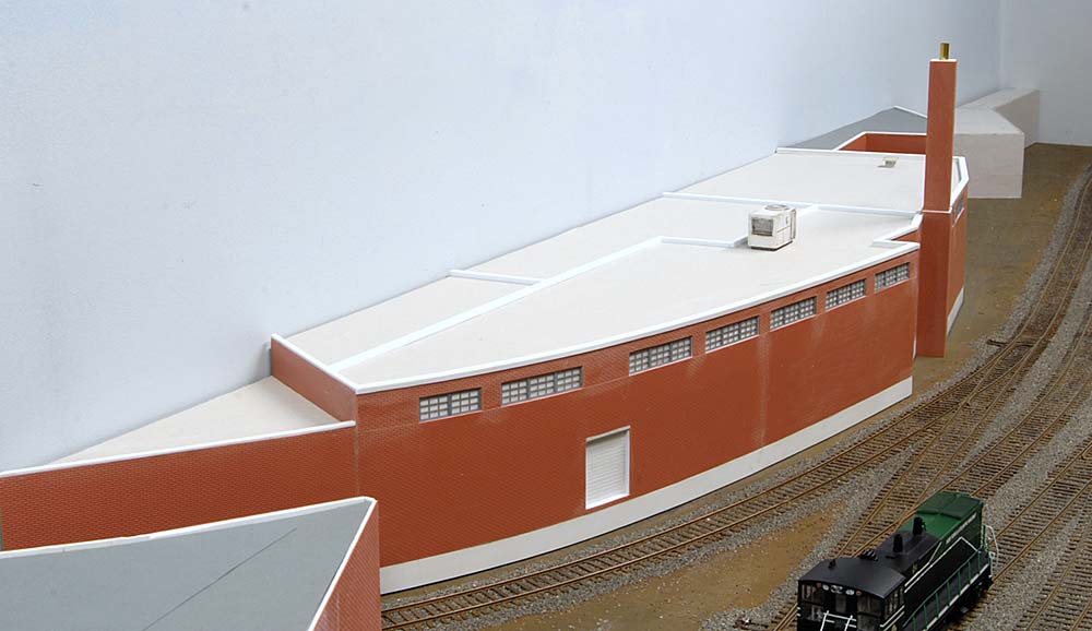

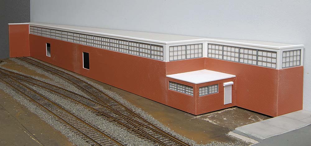

Re: Bushwick Terminal - shortliner - 04-13-2013 Kurt - Excellent - thank you. Larry - Thanks also Re: Bushwick Terminal - Southern Tuxedo - 04-13-2013 Kurt, The curved building is coming out really nice. Are the "brick sheets" that you wrapped the building in styrene or some other material? Mark Re: Bushwick Terminal - cnw1961 - 04-13-2013 Mark, the bricks are .020" thin embossed styrene sheets like these made by JTT: <!-- m --><a class="postlink" href="http://www.micromark.com/jtt-plastic-pattern-sheets-ho-scale-brick-75-x12-sheets-2-sheets-per-pkg,10405.html">http://www.micromark.com/jtt-plastic-pa ... 10405.html</a><!-- m --> or Plastruct: <!-- m --><a class="postlink" href="http://www.walthers.com/exec/productinfo/570-91611">http://www.walthers.com/exec/productinfo/570-91611</a><!-- m -->. Re: Bushwick Terminal - cnw1961 - 04-25-2013 Just a short update. The first two structures are ready for being painted: The big curved one and the warehouse that is housing the chemical company on the left end of my layout. ![]() ![]()
Re: Bushwick Terminal - faraway - 04-25-2013 That looks very good! How do you plan to proceed with the windows? ps. Your weathered tracks and the dark ballast look very realistic Re: Bushwick Terminal - Painkiller - 04-26-2013 Looking good! This will be an awesome layout! Re: Bushwick Terminal - FCIN - 04-26-2013 Truly looking great! That cured structure and spur is certainly an attention getter! I'm wondering if I can work something like that into my current track plan. Re: Bushwick Terminal - fast car - 04-26-2013 Kurt, Really nice job. Will most of your structures be brick? Larry Re: Bushwick Terminal - Rscott417 - 04-26-2013 Looks awesome so far can't wait for more updates. Why did you choose to flip your layout instead of the actual track plan at Bushwick terminal? Re: Bushwick Terminal - Tyson Rayles - 04-26-2013 Impressive building! Re: Bushwick Terminal - cnw1961 - 04-26-2013 Thank you guys, I really appreciate your feedback. Reinhard, probably I will paint the backside of the glazing before gluing the windows in, but I still have to try out if it looks good or if I can find a better solution … but I am in no hurry, because I want to finish the other buildings and lay groundcover first. Ed, I love those curved structures and especially this one. I wanted to build it from the moment that I first saw it. Rscott, to operate my layout I have to attach my 7 ft. extension and I can only attach it to the left side. Without the extension the runaround is useless. I could have built a shorter runaround to operate the layout without the need of an extension, but that would have limited the value of the runaround and it would have been necessary to compress the whole scene. But I wanted to build it without any scenic compression and without limiting operational possibilities, so flipping the layout was the only way to achieve that. Re: Bushwick Terminal - cnw1961 - 04-27-2013 Larry, sorry, I forgot to answer your question yesterday. Yes, most of the buildings will be brick with some corrugated metal and cinderblocks here and there. I still have to decide how to do the structure on the right end of the layout. It might be concrete. Re: Bushwick Terminal - eje - 04-27-2013 Kurt - Those long brick buildings are simply gorgeous. They scream 1950's! Good call on the extension, also. Ric |
