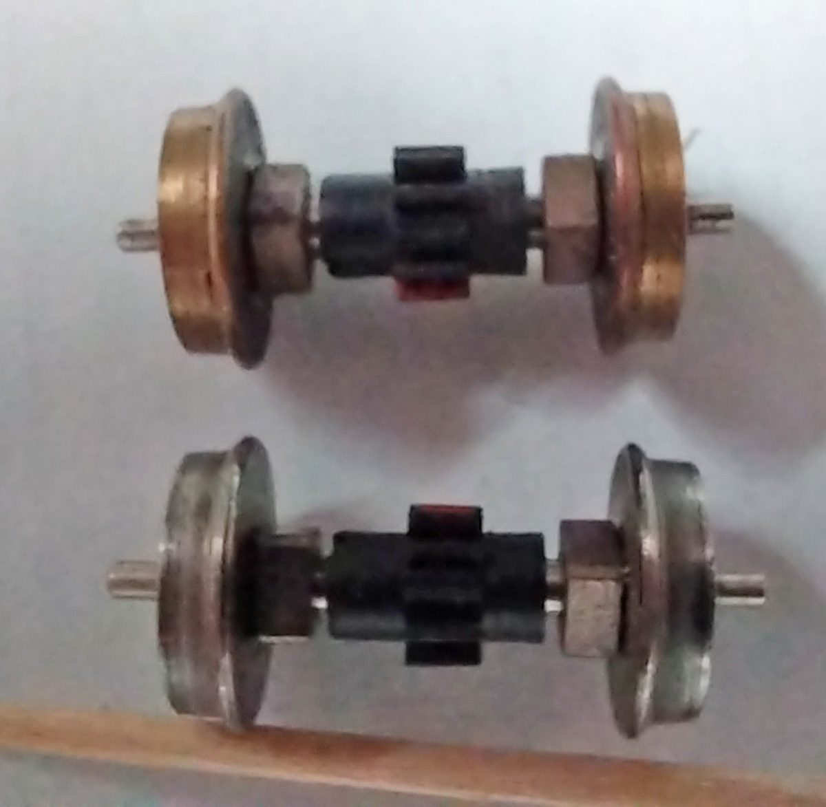

is there anypne  out there that knows if anyone sells replacment drivers with gears for prpto 2000 pa's.
jim

Jim If they are the same gears that are on the 4 axle locomotives the Athearn sd gears will work and are easy to change. I.will do some checking.

not the same ones slightly different.
jim
RE: help - jim currie - 05-04-2025
to update the proto pa gears are larger than the athearn ones and are off to one side, the common problem is not the gear itself the long side splits letting the wheel to move in or out not staying in gauge.
jim

     I checked the E8 axles gears and they are 11 tooth and longer on one side Let me know if you think these will work.
RE: help - jim currie - 05-30-2025
Charlie those are not the same the older pa's had a gear that was offset with no bearing the axles rode in the side frame. thanks, again for the offer but they won't work.
