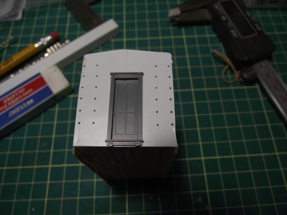

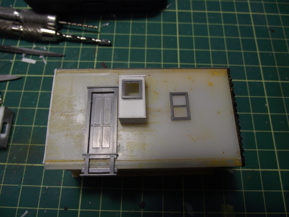

I started with the deck end of the cabin. I added the door and pre-drilled for the grab irons that will be added. Tichy adds a drilling fixture in it's boxcar and reefer kits. I used that on this job as well.

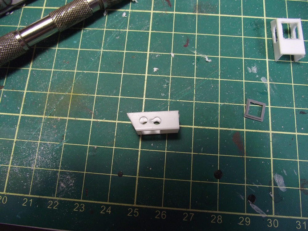

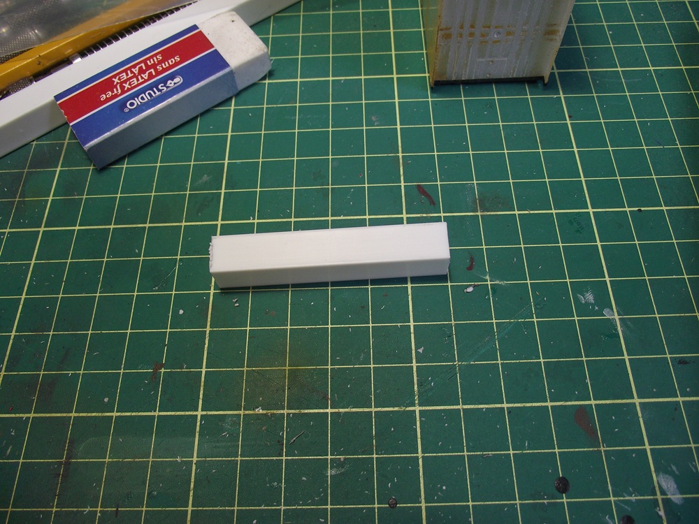

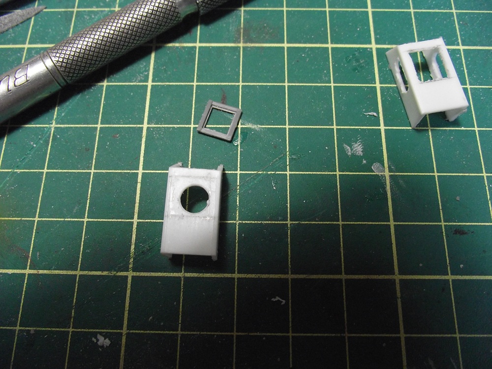

The next challenge was to fabricate the bay window on each side. I was going to cheat and use an emd all weather window but then I went through my Evergreen styrene collection and found some 3/8" square tubing. That gives me the right width for the window structure.
I cut to lengths and angled one end for the roof. Then it was a matter of figuring out the windows.
I used my digital caliplers to meaue and place the window opening on the side. I drilled a hole in the center and used a few jewelers files to file out to the square, checking my work with the window casting as I went.
The side oval windows were made the same way. Drilling out the round ends and filing the rest of the opening. These won't have castigs in them, just glazing of some kind.
I did the same procedure to create the other door and window openings, taking care to measure for the eventual three color paint job.

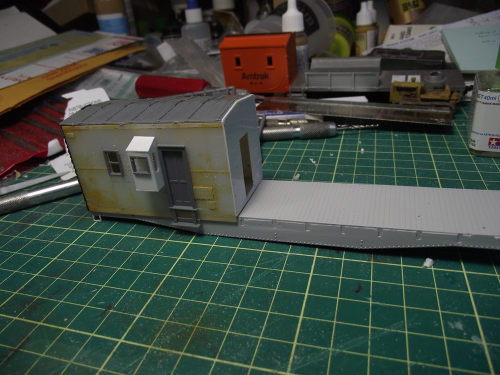

The cabin on the flatcar. I still have to install the grab irons and the manual brake gear on the other end but it's coming together.

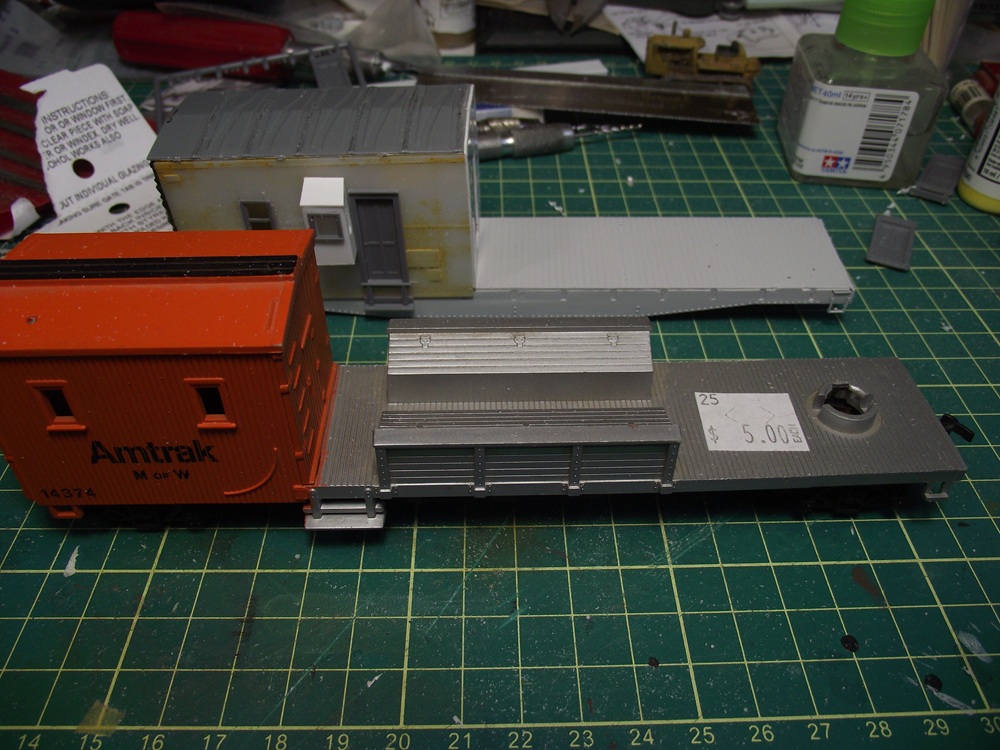

I was in a hobby shop yesterday and found this. I'm planning to take the two toolboxes off the deck and use them as the start for the deck boxes on mine.
RE: Northern Alberta Railway crane and idler - TMo - 07-30-2026
"I was in a hobby shop..."
Sadly, not a thing most of us can do easily anymore. Nearest decent one for me is an hour away in York, PA.
Those tool boxes are going to look nice on that recovery car!

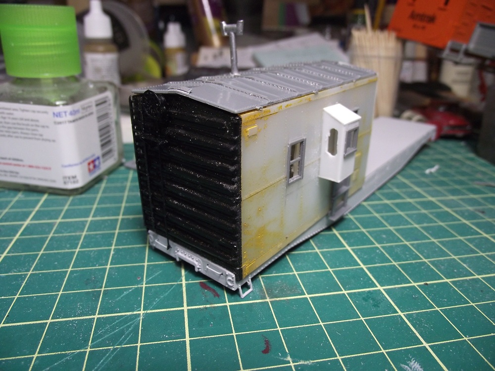

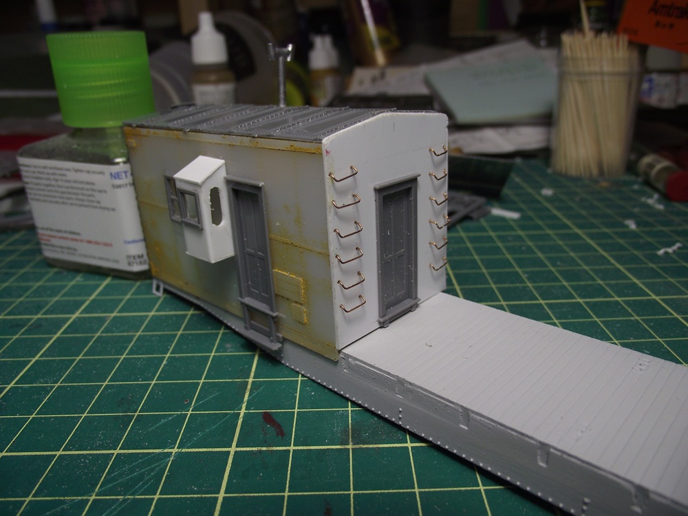

I finished the cabin on the idler car.
I installed the drop grabs on the one end. and a Caboose smoke jack on the roof.
I also added the brake gear on the other end.
All I need to do before the car is primer eady are the big toolboxes on the deck.

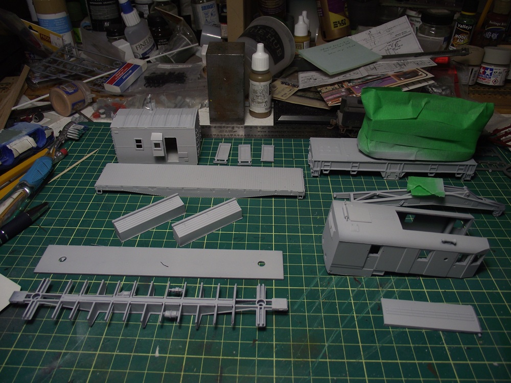

Since I last posted I sprayed primer on all the parts that will be painted:
I'll wait a few days before I start painting the first colors
