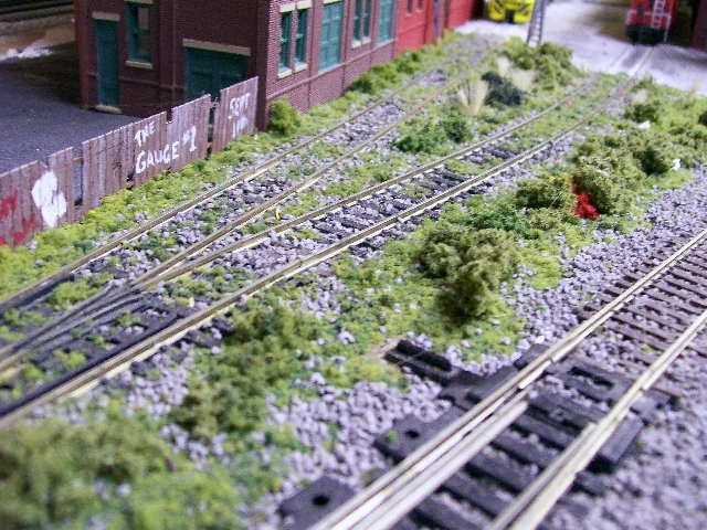

Re: Question about yard tracks - Charlie B - 05-31-2009 Bob, I have actually used the old black cinder ballast found along the right of ways of the old railroads. I run it through a screen and then use the magnet for the metal, then I spread it and use wet liquid white glue to keep it in place. I've used this for ballast on side tracks and branch lines too. You probably have some old abandoned lines you could get cinder from. I always like to think about the 1/1 scales than ran over them too. Charlie Re: Question about yard tracks - foulrift - 05-31-2009 Thanks for the replies guys.Some good tips.Once I figure out what I'm going to do I'll be sure to post some pictures of the results. Bob Re: Question about yard tracks - doctorwayne - 05-31-2009 Simply varying the colour of the ballast can suggest the relative importance of various tracks. My main lines are mostly ballast atop cinders, but the loco servicing area is mostly cinders (Woodland Scenics), with a few "weeds" thrown in. The industrial sidings are ballasted at the entry switch, but that quickly deteriorates to cinders, dirt, and weeds. [album]790[/album] None of the ties is actually buried, but the change in ballast colour from that on the main line suggests that some are - the addition of a few weeds helps to enhance that effect. [album]96[/album] [album]1022[/album] [album]983[/album] Wayne Re: Question about yard tracks - ocalicreek - 05-31-2009 Here's a picture I resized for this thread. It was originally for an article destined to be published in the 1:64 Modeling Guide but alas, the editors/publishers dropped the ball. Hey, maybe I'll submit it here as a how-to. Anyway, it shows the trackwork down at the end of Murdock's Landing. Ties are real wood that has been stained a dark brown, rail is code 70 painted a rusty color. Individual ties have been singled out with a lighter shade to represent older ties fallen prey to the harsh sun and wind along the river, and darker to represent newer ties. Note also the 'sidewinder tracks', the greasy black down one side of the ties outside the rail, drippings from the shay that sees duty out there occasionally. Balast is WS Cinder Balast. The subroadbed is actually yardsticks...hey, they're free at most lumber yards...so track is not that high above the ground level. Scenery base between tracks is lightweight spackle tinted with crafters acrylics then covered with WS ground foam. I have since added 'prairie tufts' from Silflor between the ties as weeds. There will be other places where I will bury the ties with dirt, cinders, etc. but what you see here is my 'basic' trackwork for sidings & light trackage. Galen Re: Question about yard tracks - doctorwayne - 05-31-2009 Very nice work, Galen. Wayne Re: Question about yard tracks - foulrift - 05-31-2009 Galen & Wayne,Thanks for the replies. Galen-I like the way you did the ties. Wayne-You make some good points. Great looking photos also. Bob Re: Question about yard tracks - eightyeightfan1 - 06-01-2009 Well, Since everyone posted examples, really nice looking examples at that, I'd thought I'd throw one out there also. These are the leads for my rail served industrial park. Re: Question about yard tracks - foulrift - 06-02-2009 NICE! Now I can see what you were talking about in your earlier response. Bob Re: Question about yard tracks - doctorwayne - 06-02-2009 Good-looking scene and effective use of ground cover, Ed, but I'm curious as to why you didn't paint the rails. :?: In my opinion, that simple change would lift that scene right into the realm of "Wow!!" I also like the look of those crossings in the distance - any chance of a closer view? Wayne Re: Question about yard tracks - eightyeightfan1 - 06-02-2009 Thanks Doc. Not a big rail painter. Tried it a couple of times, and had operational problems after cleaning the rails real good. Sooo....I don't paint the rails. Here's a couple of pics of the crossing. Its actually part of the parking lot of the industrial park. But i didn't like the way the paint color came out. Any suggestions? Re: Question about yard tracks - TCWORLD - 06-02-2009 find an airbrush and water down some black acrylic paint (alot like 4 parts water, one part acrylic). Then spray the concrete area unevenly. You can add more on some areas than others - maybe highlight small spots where oil has been spilt - lines along the edges of where the rails meet the concrete (If you have steam engines running on the layout). Re: Question about yard tracks - doctorwayne - 06-02-2009 Thanks for the additional views, Ed. I really like the way that you've positioned those buildings. Is that road surface done with plaster? I've found it to sometimes suck up the paint too quickly, resulting in a blotchy appearance, especially if applied with a brush. TCWorld's suggestion about thinning the paint should help, although I'd go much thinner: maybe one part paint to 20 or 30 parts thinner. This will apply as a wash, so it'll take multiple applications to build it to the intensity that suits your eye. Wayne |
