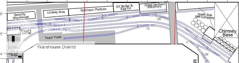

steinjr Wrote:[Image: robinson04.jpg]
An additional factor to take into account is that I need to have a section boundary somewhere in the region between the two crossovers I have today, to get sections of a suitable length for getting into or out of my small room easily, and I would prefer to not have a crossover straddling the section boundary. And that I didn't want to make too easy to switch - having longish tracks with several industries on the same track, where you had to pull cars at several industries to get things out of or into a third industry was fairly typical of the prototype.
I think that the version above would work best. Robinson's car wouldn't need to be moved in order to switch the other industries, and only the second industry in from each end would require re-spotting if the customers on the ends of the track needed service, the same as if the crossovers were facing the opposite directions. In fact, you could spot two cars at Robinson's if one was left over a switch - obviously, then you'd need to move it for switching the industries accessed by that switch, which would require extra moves through the un-blocked switch. Perhaps an operational possibility during Robinson's "busy season", with the single car shown in the drawing above being the "normal" scenario.
Good point(s) - I'll see if I can make it work with the two crossovers going "outwards" from Robinson instead of "inwards" towards Robinson when I re-lay the tracks here.
Quote:Keeping the switching district distinct from the main line in this area should generate more moves: not especially good for the prototype, but important on your layout where you want to keep the switching crews busy. If you find that they're too busy, you can always add a turnout or two in the future.
Again, good point.

After dithering a bit on the issue, I have decided to run the tracks in the warehouse district directly on the foam, instead of on a raised track bed.
I have also considered whether to do another building for the freight house at the far left of the milling district, and have the track go into the bulding, instead of behind the building. I'll have to experiment a little with building shapes to see what I can come up with here.
Overview of this area on the latest updated track plan (plan 66c):
[Image: district.jpg]
I still hope to caulk down the last risers and track bed tomorrow, and hopefully also start laying some mainline track.
