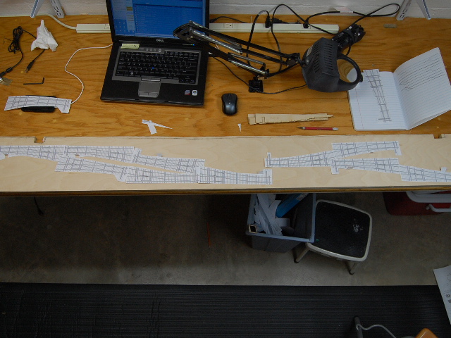

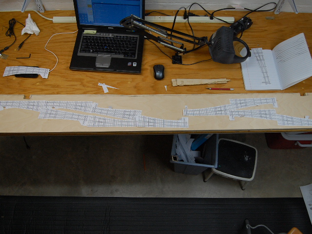

I recently took down a layout that had been in place for a long time (298 Track Nails), and part of the new layout project was to move my workbench and install some shelving (Workspace Lighting).
Since I will be layout-less for awhile, I'm planning on laying some track on one of the shelves to keep myself entertained and to use as a future RIP track, but need some help on a design that is functional and makes sense.
Givens:
- Shelf is 8' long by ~7 3/4" wide
- Switch tails need to be about 18" to accommodate at least one locomotive and one car (Mikados or 0-6-0's, and 40' cars)
I will be using only #6 switches (recently procured a Fast Tracks fixture as part of the larger project capitalization <g>).
The initial design I came up are in the photo and diagram below. Thoughts?
Placement of turnouts
Plan. Sorry about the sizing - I'll crop and re-upload this tomorrow.<edit: white space cropped>
Notes:
Black lines represent turnouts - most are joined directly together. I suspect that when I build it, I'll be able to trim the ends of the turnouts somewhat to gain a few more inches.
The vertical dashed lines are 18" from the ends of the shelf (reference lines)
The shortest tails (left end of #3 track & right end of #1 track) are about 16". The longest is the left end of #1 at about 33". Others are just over two feet.
[Image: p182276653-4.jpg]
Thanks!
Re: Input on a "Temporary" Shelf Track Plan - shortliner - 02-21-2010
Looks good to me - I like it! Thumbsup
Re: Input on a "Temporary" Shelf Track Plan - railroader9731 - 02-21-2010
Id like to know is there going to be idustrie flats or something to switch cars in to? Also perhaps at one end a dock for in and out bound cars, just my 2 cents. Other wise fluesheet looks good to me.
Re: Input on a "Temporary" Shelf Track Plan - steinjr - 02-21-2010
Mmm - looks a little bit on the track heavy side. I guess it really depends on what you are trying to model on your temporary layout.
How about something with fewer turnouts and more scenery? Here is e.g. a quick sketch of a layout somewhat inspired by Bill Dixon's Tymesaver on Carl Arendt's Micro Layouts site (in scrapbook 53: http://www.carendt.us/scrapbook/page53/index.html):
[Image: RIP01c.jpg]
In the drawing above, green cars are inbound cars, orange cars are cars to be picked up, blue cars are cars to be left where they are or re-spotted after switching. Engine is portrayed by a GP40-2 in the drawing - I don't have any steam engines in my program car library.
Might give you some more ideas about what kind of things you want on your layout (and what kind of things you don't want on your layout, too) Goldth
Smile,
Stein
Re: Input on a "Temporary" Shelf Track Plan - Fluesheet - 02-21-2010
Thanks for the comments guys.
railroader9731, at this point, I hadn't planned any industries. This was initially intended to be a stretch of track to test models (cars or locomotives) on and / or as a "project" track for cars / locomotive that are awaiting work. However, then I got the turnout fixture and a single track with one spur got the steroid treatment; which segues nicely into Stein's comment:
steinjr Wrote:Mmm - looks a little bit on the track heavy side. I guess it really depends on what you are trying to model on your temporary layout.
<snip>
Stein
Yes, I'll admit that it is heavy. If there is such a thing as a spaghetti bowl plan that is perfectly straight, mine would seem to be in (or getting close to) that category! It became an exercise to see how many turnouts I could get into the space and still have room for the minimum length tails. I didn't have a good sense whether it made operational sense though.
This track plan is VERY nice, thanks for taking the time to post it. In spite of having a good amount of track, it has a very usable feel to it - amazing what a little thought and expertise can do for a space.
Incidentally, what software package did you use for your drawing?
Note: I've edited the image I posted to remove the whitespace.
