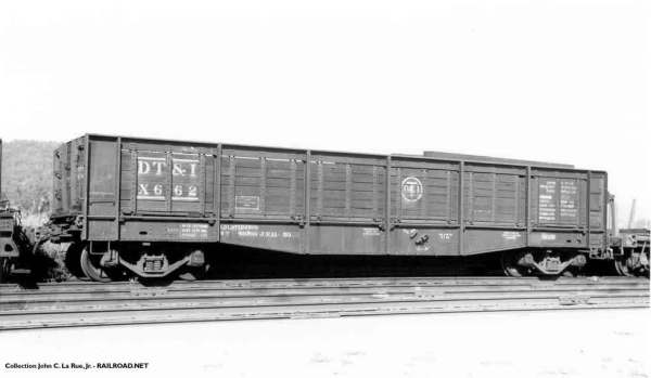

Galen, I googled "Hart convertible gondola" and found this pic:
Hope it can help with your challenge project.

Thanks, Sumpter! Cool find. I believe that's a later model than the cars I'm working with. If you come across any earlier ones let me know. I think they also went by the name 'Rogers Balast Car' or 'Rodgers' sp.
There was a google book I stumbled across during a similar search that seemed to say there were some modifications made in the way these cars 'convert' from center to side dump or to flat bottm, and from recessed ends to full length. I'm not 100% sure on the details of how the conversion was done.

What I've got, as best I can tell, are Hart Convertible Ballast and Coal cars. The DT&I car pictured above is a Hart Convertible Gon, but it's got side doors and a different underframe. For these cars, like the DT&I car, a plow could be pulled down through the car and material would be sent out the sides of the car, not the floor. The floor could be modified into a hopper bottom, but the plow would not be used. Modeling the plow and additional lidgerwood hoist car (like a steam donkey) would be a cool challenge.
The HC Ballast and Coal cars did not have vertical side doors. The dumping operation was accomplished through the floor completely. That is, in hopper mode, the balast or coal was dumped by opening the V shaped hopper bottom. The V was continued up the sides because of the floor panels that folded up. In Gondola mode, those floor panels could be folded down to rest on the braces spanning the V to form a flat bottom. In that case, material could be directed out the sides like a regular drop bottom gon. OR, in hopper mode, the upper V panels could be opened and material directed down and out the bottom on either side of the hopper bottom through the drop bottom doors. Clear as mud, right?
Suffice it to say, the Silver Streak/Truscale model represents a Hart Convertible car without hinged vertical side panels.
