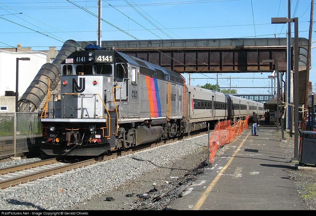

In the end, you get this- brand new from Morrison Knudsen in 1987. It is in Illinois en route to New Jersey. Dynamic brakes and other equipment such as ditchlights would be added later.
[Image: pictures%5C24550%5Cnjt%204141.jpg]
For 24 years now, NJT 4141 has been running through out New Jersey, certainly a different view from its "home road" out west. It is one of the last 4 standing, one of which no longer has a working HEP generator. This is the 4141 today.
[Image: 8965.1217346289.jpg]
Most would never guess by looking at this unit that it was actually a veteran from the west at one time.
