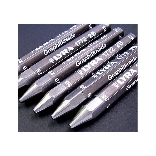

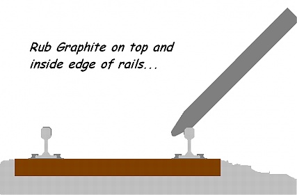

Question about Wahl Oil - w8jy - 01-09-2009 I know that some of you swear by this and others swear at it. I currently clean my track with alcohol, followed by contact cleaner. I would like to try a light application of Wahl Oil, but I wonder about an adverse reaction with traction tires. Does anyone have any experience with this to shed a little more light on the subject? Re: Question about Wahl Oil - yellowlynn - 01-09-2009 I think it depends a lot on what the traction tires are made of. I used it with some G gauge and the tires shortly fell apart. The up side was that they ran just as good without the tires. I dab a bit on each rail at the start of a curve, and they run good. On HO, some tires get old and rot off and I replace them with suitable band from an Ortodontist. The oil doesn't seem to bother them. I have used plastic compatible oil on my HO and have no troubles with it. Lynn Don't do it!!! - TinGoat - 01-09-2009 Hi Gang, I have a problem with using Wahl Clipper Oil on the rails... :hey: Don't do it! :hey: Eventually, the oil is going to attract more gunk and dirt. Then you are going to have to clean everything again and again... Instead of oil, use a "2B" hardness sketching pencil or graphite stick to rub onto the rails. It is a semi-conductor that will give you good reliable electrical pick-up. As a fine dry lubricant it resists dirt and gunk from building up on the rials. It's not too slippery, so it doesn't effect traction. It fills in all the tiny/microscopic scratches in the rail so that dirt and gunk doesn't get stuck. It lasts a long time. Buy a six pack and hand them out to your friends! We've coated the rails on all of our layouts and the Whole Narrow Gauge Madness Gang has had reliable operations on our mini/micro/modules... A quick rub with a soft rag and another dash of graphite is all you need to maintain the rails. It's great on Brass and Steel rail to protect against oxidization and helps keep them clean.... It just takes a little Graphite rubbed on top and inside edges of the rails... Then sit back, relax and enjoy running your trains!
