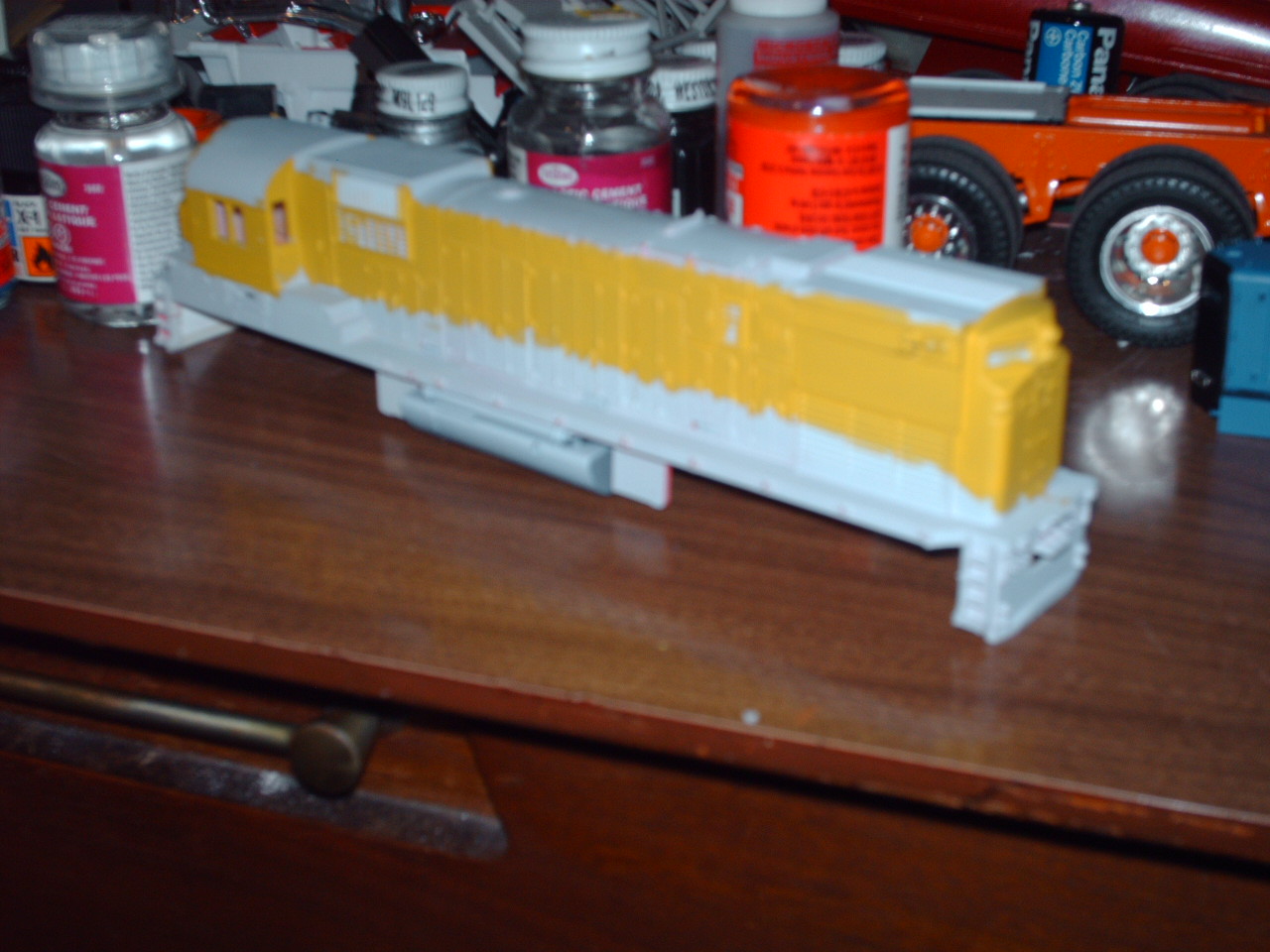

Just joined this group and thought I'd share my latest locomotive project. I got an old Tyco Alco C430 from my dad, he had it given to him and he gave it to me to see what I could do with it. Don't laugh, lol, took the motor out and going to use it as a dummy. Actually once you get the paint stripped off it's not to bad on the detail engraving. It's going to painted in Susquehanna colors. I'll get some more pics up soon.

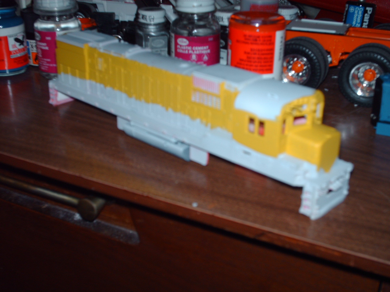

My C430 taking shape. I've drilled the holes for the grab irons, added new headlights from Details West and new horns from Detail Associates along with a sinclair antenna from Juneco. I've also filled in the huge gap in the pilots and going to body mount the couplers. The shell has been stripped in Castrol Super Clean, primed, and the yellow painted on. As there is no specific paint for the Susquehanna, it's a case of best guess. I've chosen Scalecoat's EL yellow. Hoping to mask and paint the black on today. Sorry about the fuzzy pictures, I'm going to check the camera and see if i can get the next photos a bit sharper.

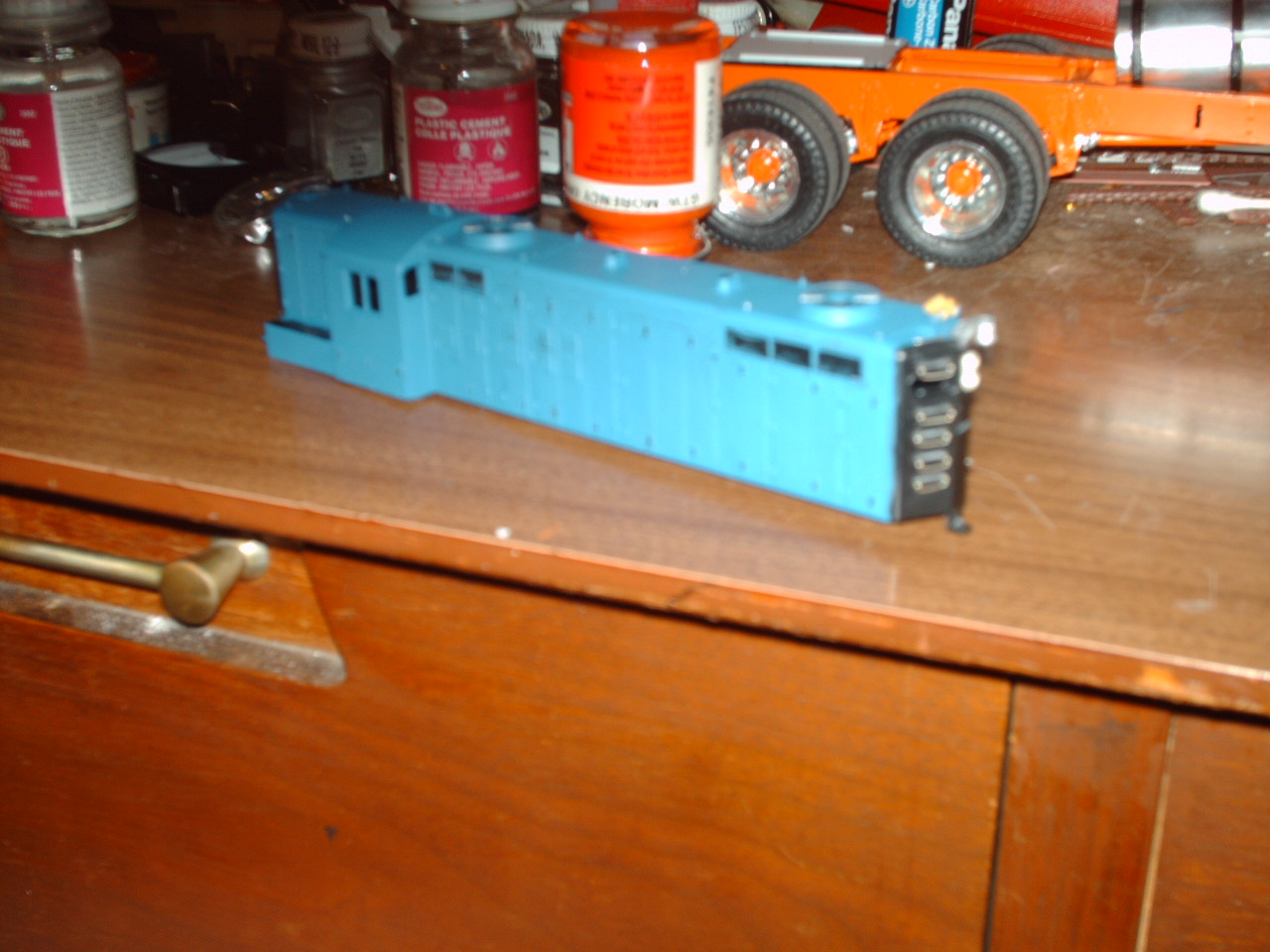

Another el cheapo project. This is an old AHM GP18 I had given to me. Again the driveline has been removed and the body looks pretty good. Gave shell a bath in super clean, added grab irons, lift rings, headlights, over nose bell, and horn. Painted so far with Scalecoat GTW blue, the red/orange going on today then a set of Herald King GTW decals. Then to tackle to frame and those handrails.
