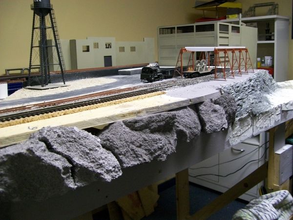

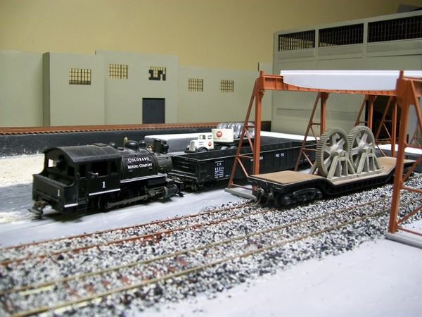

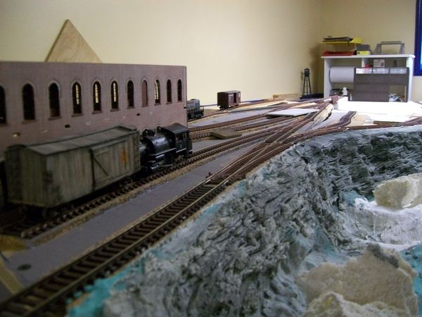

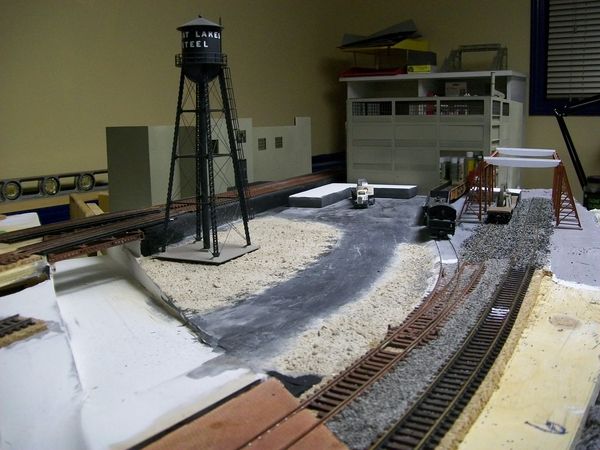

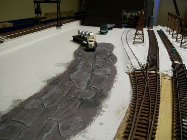

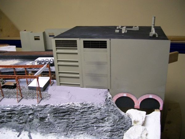

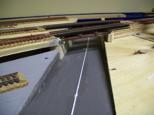

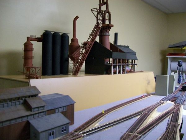

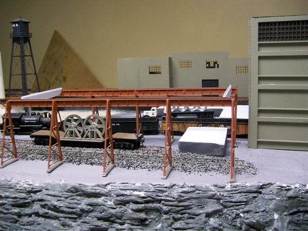

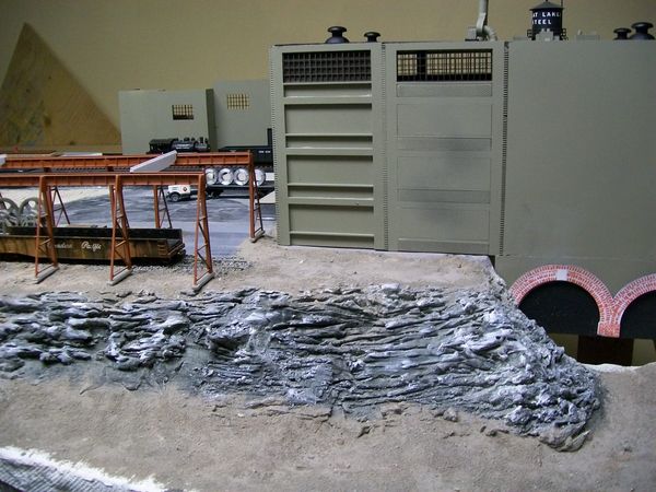

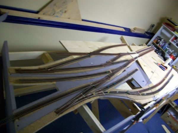

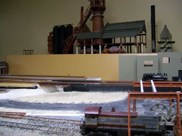

Hamilton & Great Lakes Railroad - teejay - 02-04-2013 I finally have a name for my new layout . The Hamilton and Great lakes RR will have a steel mill flavour to it and Hamilton, Ontario was ( once ) a big player in the steel industry in our country . Some of the stratified rock scenes I'll have on the layout are similar to the terrain around Hamilton and of course , Great Lakes, is what I'm surrounded by where I live . Hence , the name . A refresher as to "in the beginning " ....and bridge added Re: Hamilton & Great Lakes Railroad - teejay - 02-04-2013 I'm having a lot of fun with this area as I keep changing my mind . So far , in it's infancy , I have a couple of scratchbuilt structures , a roadway , a highline track , an overhead crane that I have to kitbash because I've narrowed it .... Re: Hamilton & Great Lakes Railroad - teejay - 02-04-2013 The roadway going in was changed from this .... to this .... ...with the aid of some comments and advice here on the forum . I'm having fun with the foam rocks Re: Hamilton & Great Lakes Railroad - teejay - 02-04-2013 There will be a few more surprises coming up as I 'speriment with ideas . This is my favourite part of the layout and it sure beats wiring T Re: Hamilton & Great Lakes Railroad - Ralph - 02-04-2013 That's a good name. Very plausible. Looking forward to see how things develop! Re: Hamilton & Great Lakes Railroad - doctorwayne - 02-04-2013 Well, you picked a great spot to model, especially if you're modelling the area before the collapse of the steel industry. CNR, CPR, TH&B, and NYC all operating in the city and depending on the era, several radial and interurban lines, too. Ian Wilson's books on the CNR, especially Steam Echoes of Hamilton and Steam to the Niagara Frontier have lots of useful info and some good photos from the '50s. If you need anything specific, either photos or info, feel free to ask - I grew up there, as did my good friend Ed (cn nutbar). Wayne Re: Hamilton & Great Lakes Railroad - cn nutbar - 02-05-2013 Another railroad that was seen in Hamilton was the Ontario Northland with it's consists of ore from the mines in northern Ontario
Re: Hamilton & Great Lakes Railroad - teejay - 02-05-2013 I don't know as much about Hamilton as I really should . My late father moved there in the '50s and then on to Burlington , Bronte , and Oakville . My step sister lives in Hamilton not far from Ivor Wynn stadium where they are restoring an old 3 story house . My recollections of Hamilton are the mountain and the long stairways up the slopes . I'll be building my own version of things , so won't really be referring to any old pics , but thanks anyhow . I might do a little Googling on Stelco . T Re: Hamilton & Great Lakes Railroad - Tyson Rayles - 02-05-2013 Looks like you are off to a good start T, really like the rockwork. Re: Hamilton & Great Lakes Railroad - teejay - 02-05-2013 The stratified rock is PoP while the more conventional ones are cushion foam , soaked in thinned joint compound and dipped in paint ...still needs dry brushing to finish it . Most everything in the pics is wood , or some form of plaster . T Re: Hamilton & Great Lakes Railroad - teejay - 02-07-2013 In my continued effort to avoid spending money on the new layout , and , at the same time use up various supplies and items I've accumulated in the past , I came upon 3 partial bags of sanded grout which I mixed together somewhat for my groundcover/dirt ....held in place with diluted white glue . Added more foam rocks although I haven't dry brushed them yet ....mixed up some grey paint and let the foam soak in it for a while . The black "air vents" on top of the building ( 1st pic ) are thumb controls from an old Sony Playstation controller . I don't throw anything out . ![]() Re: Hamilton & Great Lakes Railroad - Tyson Rayles - 02-07-2013 Impressive, very natural looking T ! Re: Hamilton & Great Lakes Railroad - sailormatlac - 02-07-2013 teejay Wrote:The black "air vents" on top of the building ( 1st pic ) are thumb controls from an old Sony Playstation controller . I don't throw anything out . Necessity is mother of invention! And by the way, going "cheap" is often a good way to have original and personnalized structures. Matt Re: Hamilton & Great Lakes Railroad - teejay - 02-13-2013 So , Ive been doing a lot of thinking lately .....can be "dangerous to my health " ...... about backdrops for my layout . After seeing Tysons latest effort , and some of the backdrops on other layouts I was trying to decide on what to do .The Pros : 1. Effective way to add interest and depth 2. Reasonable cost The cons : 1. In HO , most backdrops are 3-4 feet high and it would destroy the ease of managing my "walk-around" layout . 2.Low cost for masonite , yes , but I'm still adhering to a strict budget and a desire to use up what I have in materials . What to do ? I have a lot of complete and mostly complete models stored away from the old steel mill layout . Why not use them ? My new layout has a steel industry them about it . .......... Re: Hamilton & Great Lakes Railroad - teejay - 02-13-2013 ..........Soooooooo ....I'm going to try using my models as the backdrop , on a raised platform . There will be tracks to show off some of the unique rolling stock ( two hot metal cars can be seen in the pics ) but the tracks won't be connected to anything . I hope this doesn't look too goofy ...lots of work to do , maybe a rock facing to separate it from the layout and give some distance . T |
